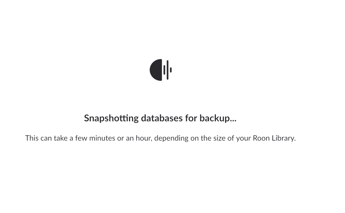

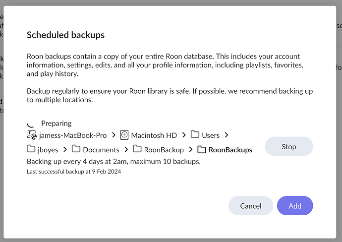

When I launch Roon, it gets stuck at a screen that says "snapshotting databases for backup...". I'm using a MacBook Pro for my Roon Core, and a Bluesound 'vault' for my library. I see several directories in the Library folder on my Mac which relate to Roon or RoonServer. I think the issue began when I downloaded and installed a new Roon app from the website. Not sure how to get the latest app to rebuild a new database for my library of audio files on the Bluesound device.

Hi Mark, thanks for your reply. Unfortunately, even waiting for hours (and overnight), the status message does not change.

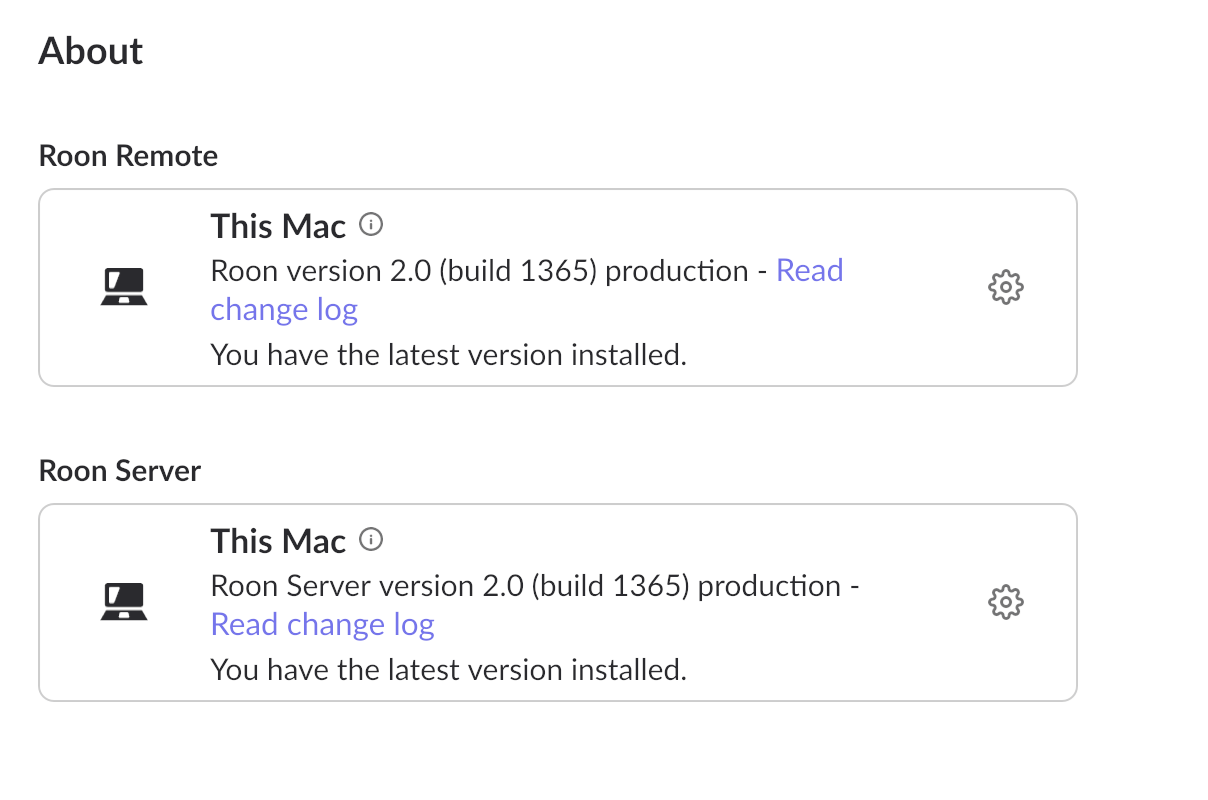

Which version of Roon; operating system?

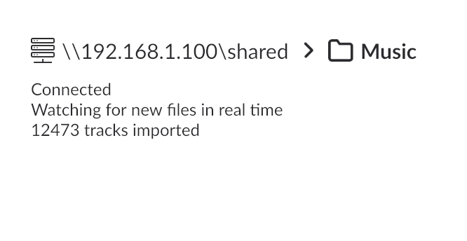

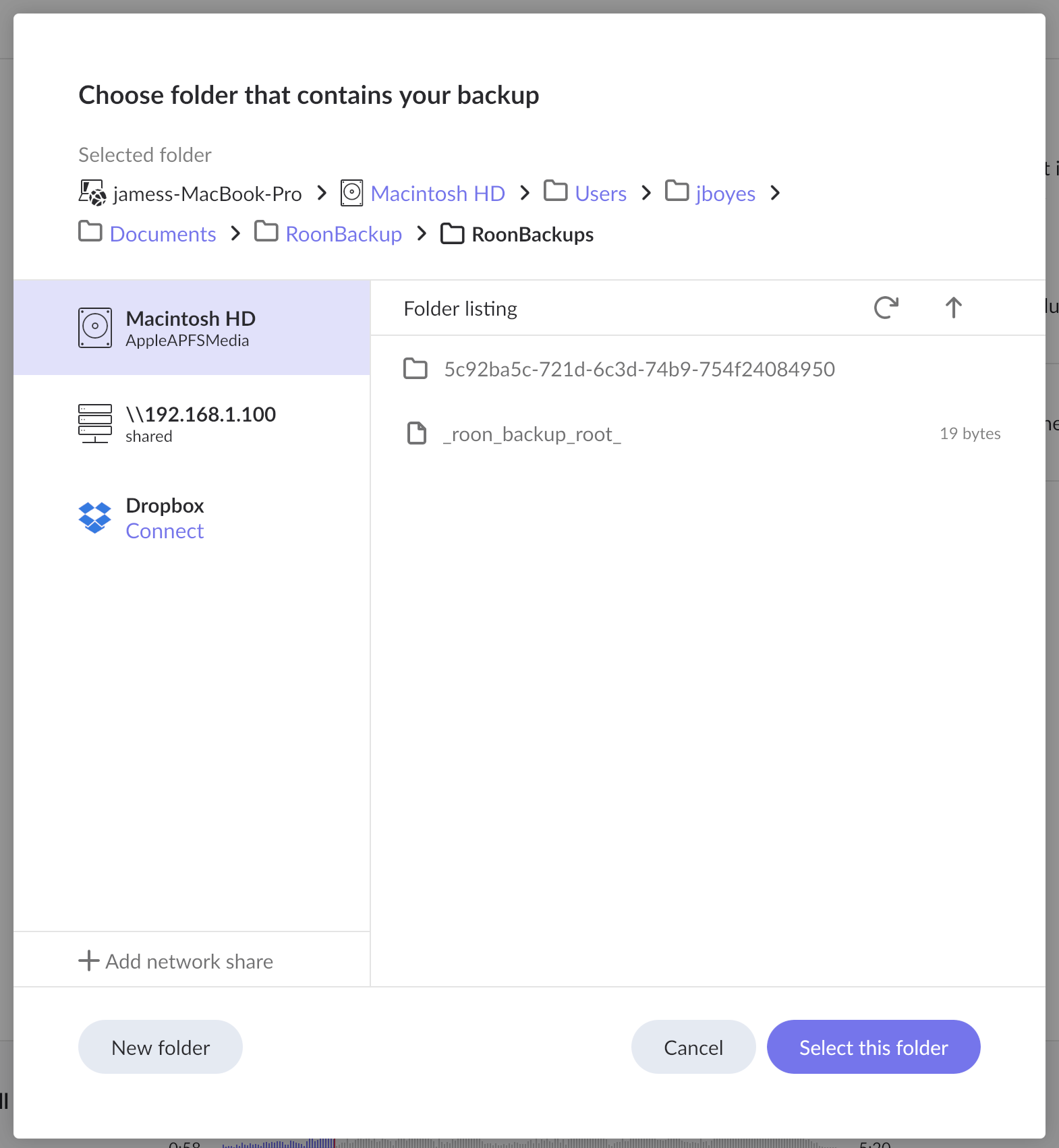

I have a few screen shots to help. My vault is accessible from the Bluesound Player, so I don’t think it’s a network or connectivity issue.
Screen Shot 2024-02-18 at 3.52.41 PM

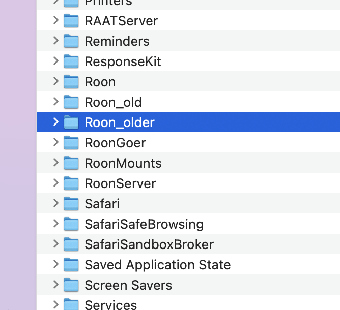

I’m seeing a number of folders on my Mac that make me think something has gone amiss with installing a new version of the Mac desktop app.

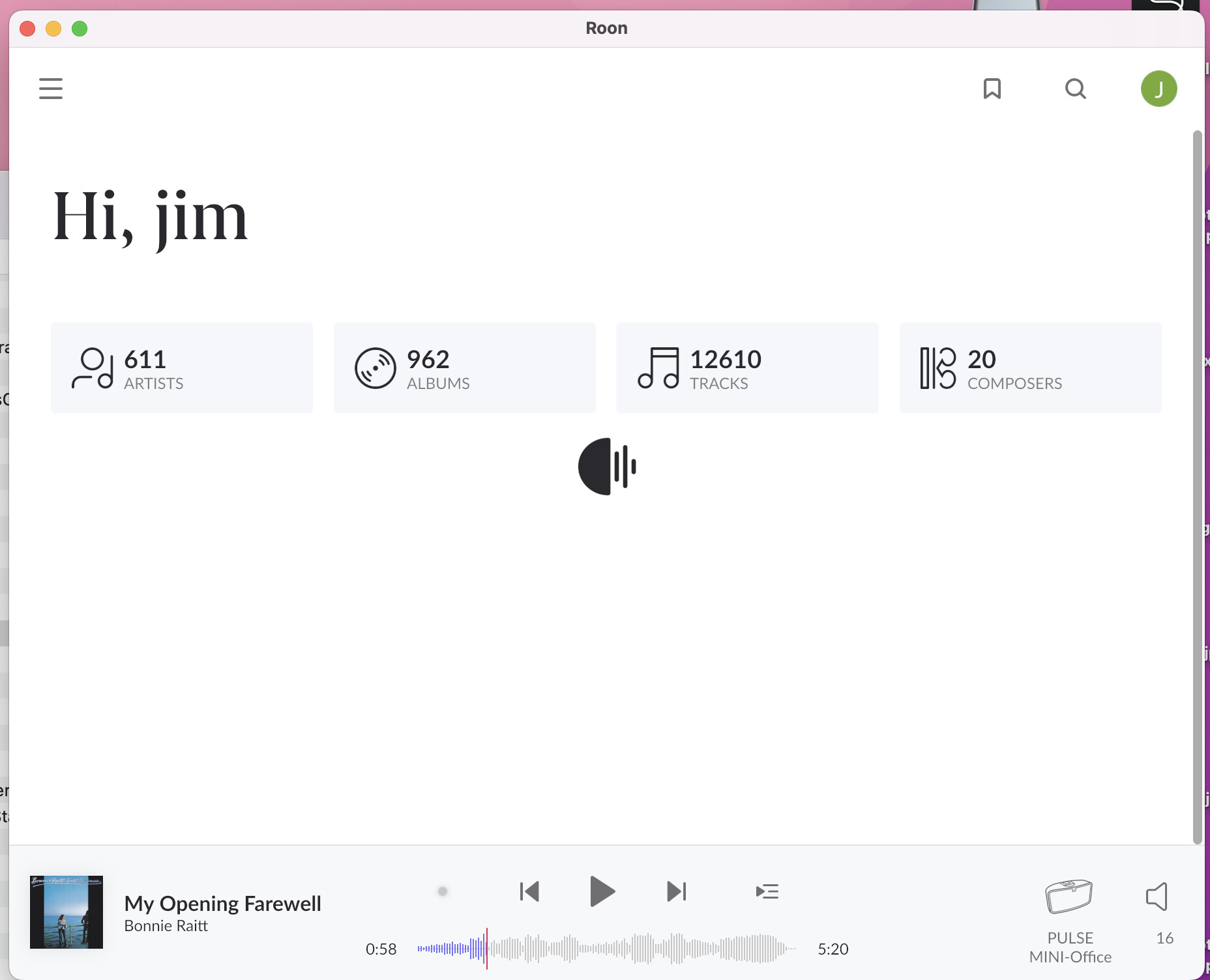

I meant to include this screen shot of the Roon app on my desktop; seems to recognize the basic setup and have some sense of history, but my library does not show up, and nothing plays.

Yes, it looks as though there may be multiple version(s) of files of which there should only be one.

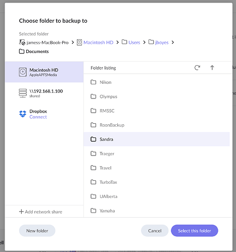

Given that you do have choices for where to back up to, what does your folder selection for the Blusound look like (screenshot), please? Settings > Storage?
But I appreciate that it’s more important for you to get your Roon Library back before backing up again. I’m sure that’s not going to be difficult.

<< what does your folder selection for the Blusound look like >>
The Bluesound device is essentially a network attached drive; I have assigned it a static IP address and the audio files are all stored in a folder called “Music”.
Are there other Roon storage settings that I should be looking at?

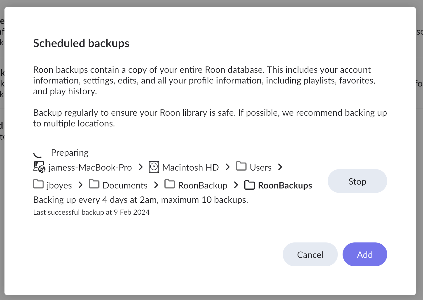

When you navigate: Settings > Backup before starting the database backup, there are three options/buttons:
  1. View
  2. Backup
  3. Browse
What do you see (screenshots) for each of these? Presumably, you have been choosing ‘Backup’ when you get the error described in your first port?

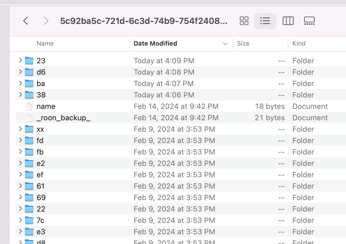

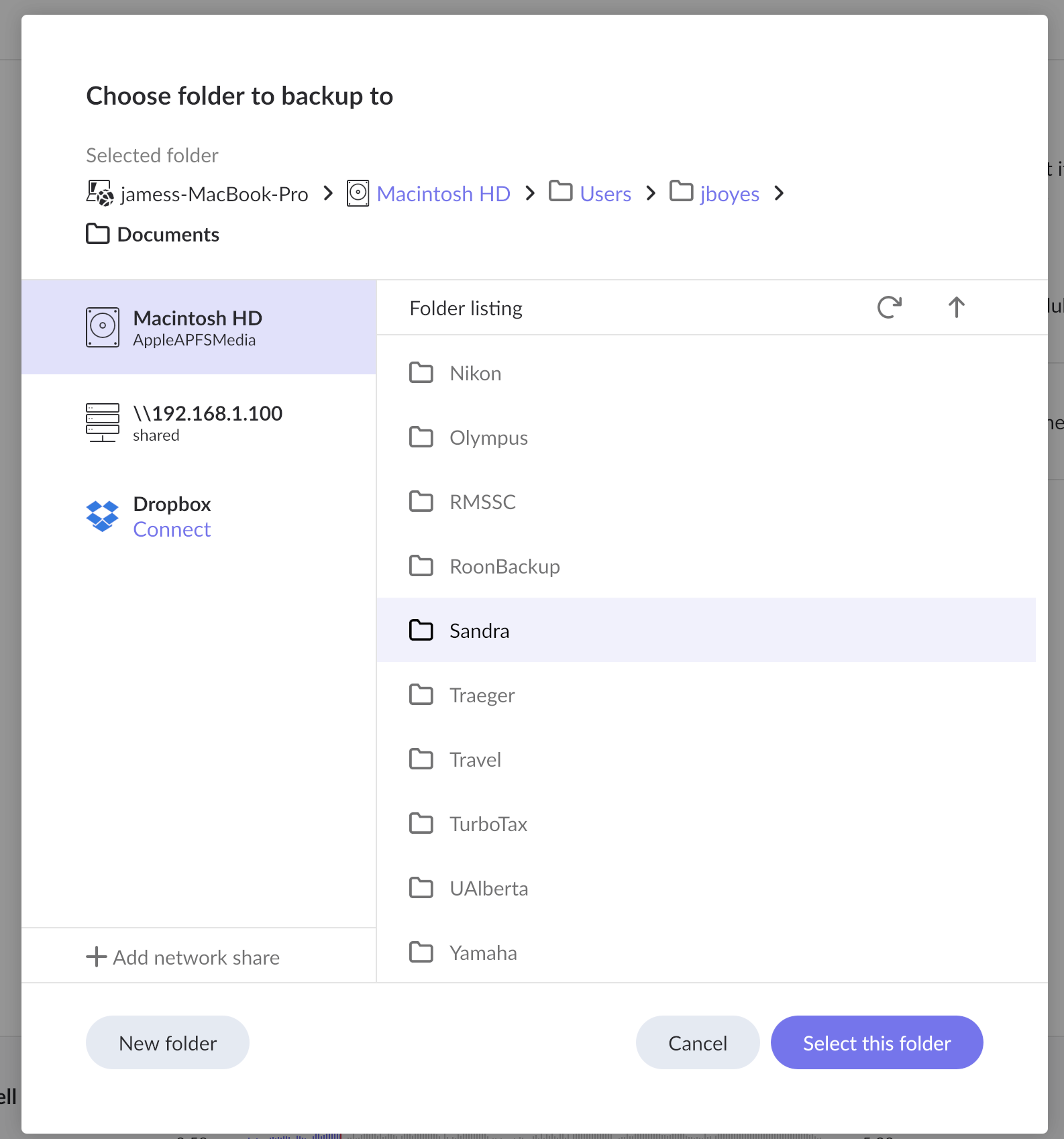

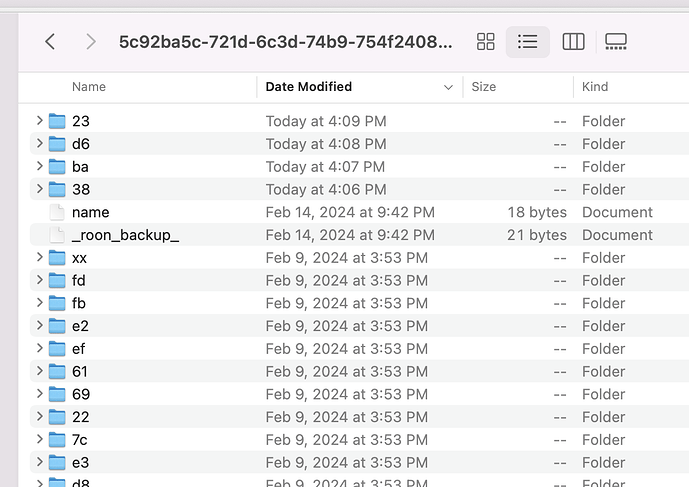

No, I’ve never intentionally created a backup (yes, I know that is bad practice!) I’ve enclosed screen shots as you suggested. The good news, is that there does appear to be a backup folder, but I’ve no idea how valid it is.
Jim,
Thanks for those screenshots.
They confirm that you have (and/or have had) Roon database backups in at least these two locations:
  1. in ~/Documents/RoonBackup/RoonBackups (which appears to be the one that’s stalling: the ‘Stop’ legend in its button); this appears in your first and third screenshots
  2. at the SMB (shared) location, 192.168.1.100… Roon is offering that as a location it appears to know in both your second (could that be your Bluesound ‘vault’?) and third screenshots.
Is that how you see and understand it, Jim, please?
If so, a good next step would be to navigate to each location in turn in the Finder and see what’s there.
Particularly important are the modification dates and sizes of (any) Roon database there.
Let’s try that next, please.
After that, a pragmatic approach would be simply to backup to a new location altogether - from Roon’s Settings > Backups > Backup button, the vertical middle of the three. Assuming that works, then to delete (any) backup(s) which are ‘misbehaving’ as invalid.

No, Roon is not working at all.
In a previous screenshot you can see a mostly blank home screen; it just indicates the number of songs, artists, etc. I’m unable to play anything from the Roon app.

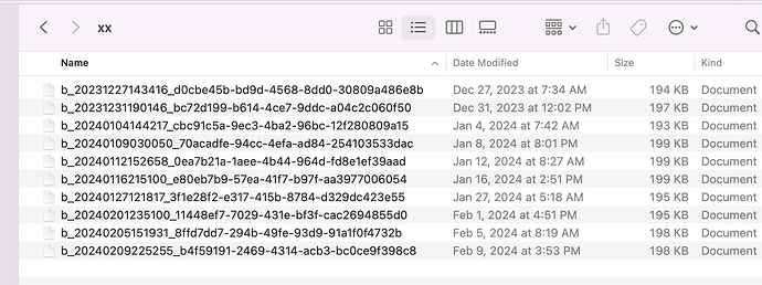

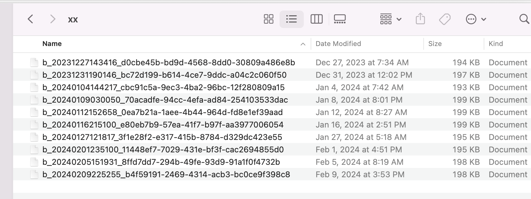

There are mostly a series of empty folders in the backup location. One folder contains a number of files.

Mostly empty is possible, but not necessarily what’s to be expected.
Yes, that’s normal. Those are typical Roon database files.

One more question before I proceed; I see several Roon-related folders in the Mac “Library” in Finder.
  • Roon
  • RoonGoer
  • RoonServer
    (I also see RoonMounts, but the purpose of that one is obvious)
    Are these the normal default folders that I should expect to see when I do a fresh install?
    Thx - Jim
It depends to some extent on what else you might have installed. But, Yes :slight_smile:
Strongly suggest copying these into a safe place - just in case.
And letting Remove-it do the hard work because it will be able to read which files Roon ‘thinks’ are part of its installation using ‘BOM’ files. IOW I’d caution against trying to delete what looks like a Roon file manually… there may be hidden and linked files; I don’t know. But you really want a clean install.
