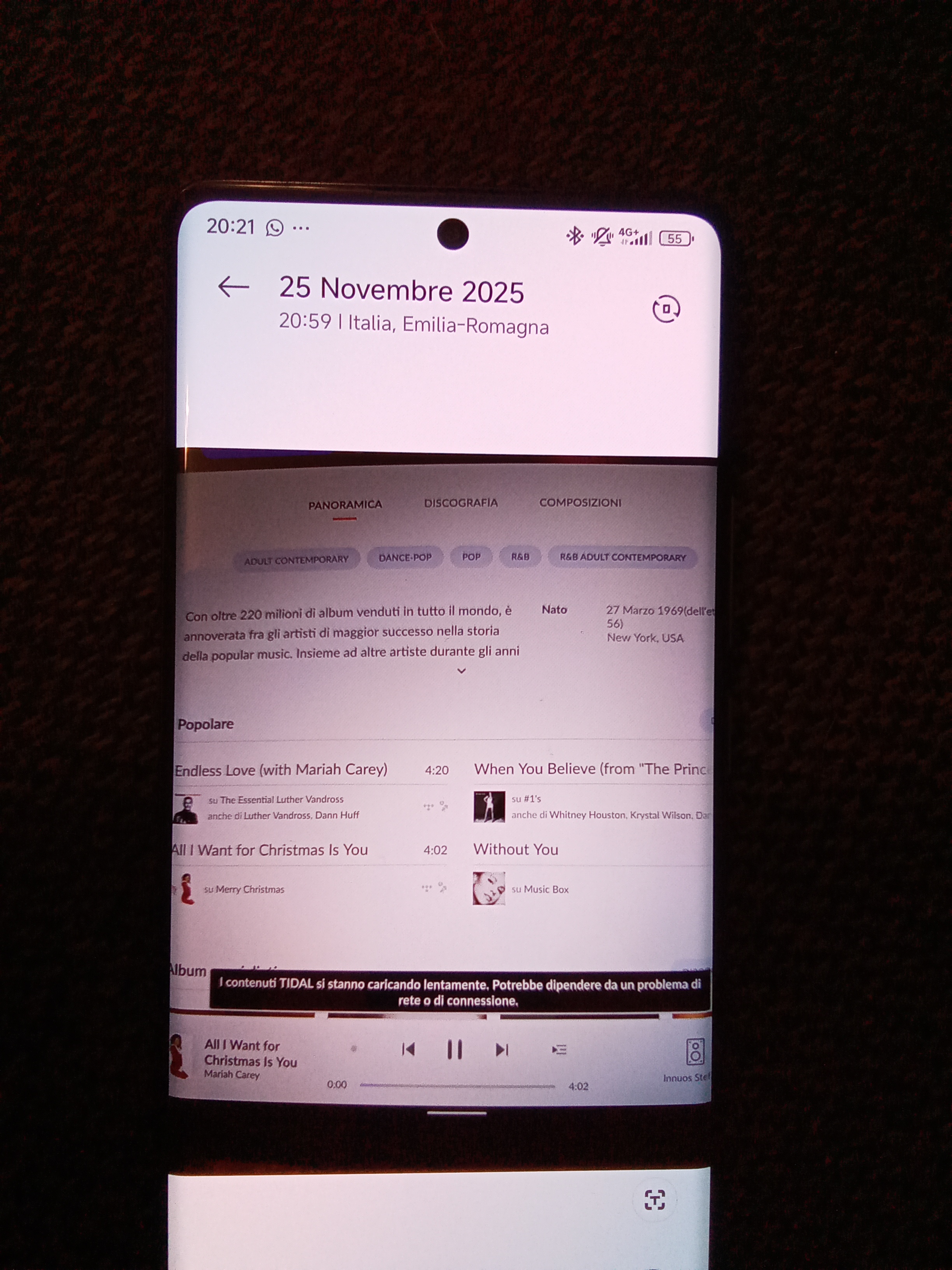

I am actually trying to reproduce streaming music through roon + tidal, but It seems there are connectivity problems. It's much slower instead few weeks ago, and usually stops playing music, automatically changing to the next track. I have changed lan cable, connection is good, i've also tried to disconnect internet modem and also logging out from my account. Please help, it's stressful.
Fastweb modem, fiber connection

Good morning and thank you for your quick replay.
  1. I have a Innuos Zen Mini Mk3 connected by ethernet cable directly to the router.
Anything was changed during the last month, a part the repairing of Innuos ( the changed the motherboard ).
Then, i use my tablet or my phone to manager Roon app.
  1. It happened on every device
About DNS test, i honestly think that it’s not a wifi problem, and also a Tidal One, i have much other device into my home and everything works well, Tidal also play perfectly when i use it making jogging or driving.
Inside home a have a good connection, with wifi i can reach 400 mb, and by cable even more.
About the problem, it happened every single time i try to listen music, and every hour and every time, if it’s necessary, this evening i will make a video with the exact time.
