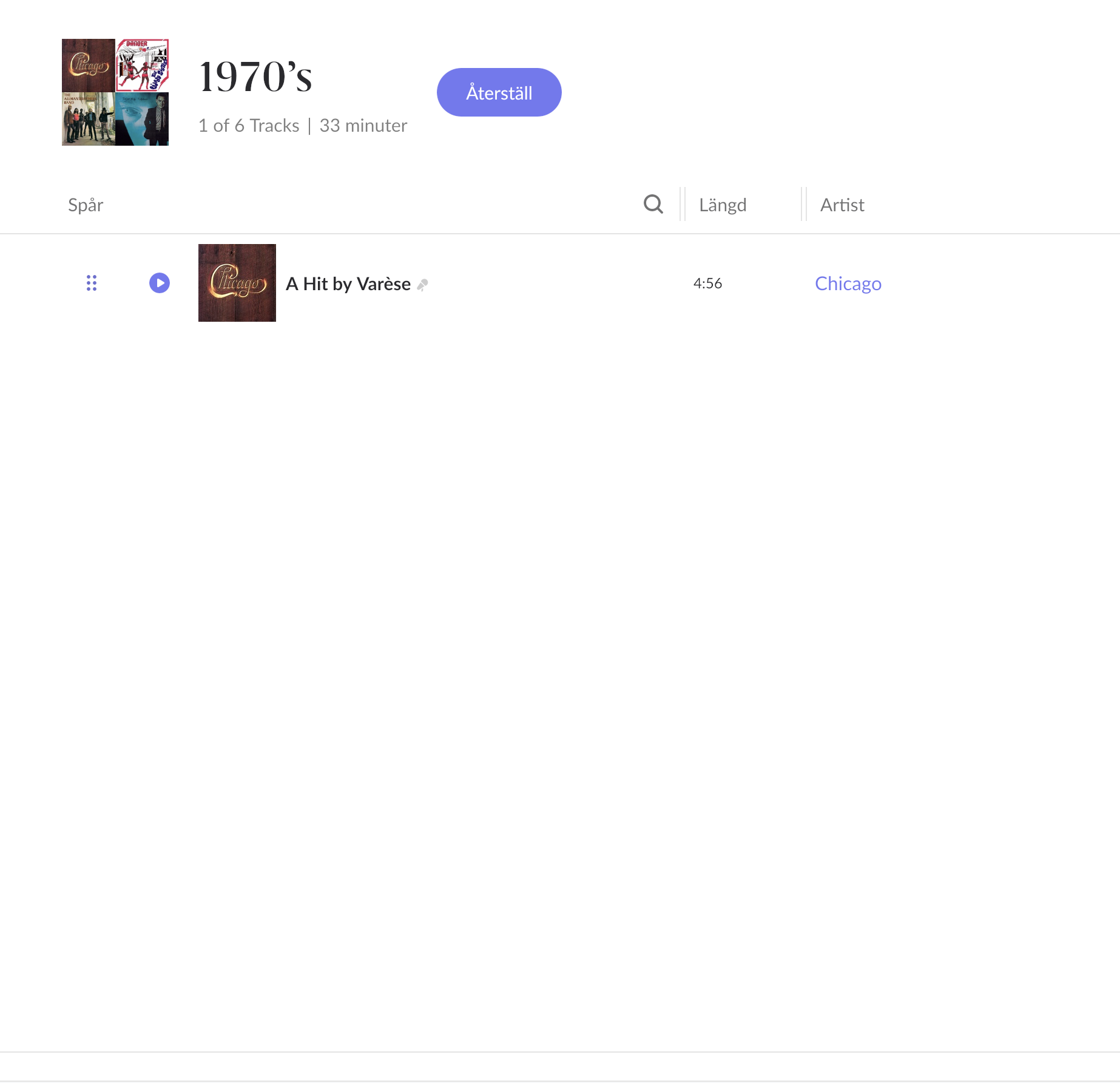

In the last few days I have discovered that when I move a track within a playlist it doesn’t stick but rather ghosts around as I scroll. I am having no problem playing music or adding tracks to the playlist - only moving them. This is true on my iPhone, iPad and my MAC. This problem began after the recent update that occurred. I rebooted the server a couple of times and that didn’t help. Not sure if others have noticed this. Thanks, Mike

Trying to drag and drop songs in a playlist doesn't work. Something happens and the track disappears from the playlist. Adding the track again and the old entry shows up together with the new one. Happens both on the Mac app and the iOS app (the Mac app crashes of it).

Sighting for Roon Server 1365, Roon Remote 1365 on OSX / IPAD: affects almost all playlists. For larger playlists tracks stay on top once dragged and dropped and after a couple of seconds the app crashes (OSX and also on IOS) or it stays on top for ever (whenever I render the playlist view - leaving and bringing up the playlist doesn’t change anything). Adding and removing tracks seems to work. Affects at least some of my playlists. When I reorder a super small playlist (10-20 tracks) it sometimes takes a while (roughly 3-5 seconds) and then the track snaps. The RoonServer.log doesn’t show any errors (only trace records).
  1. Restart Roon Control to get back to playlist. There isn’t a way to reorder the playlist (no workaround). Restarting the server doesn’t help.
  2. Happens whenever I reorder a playlist (drag and drop a track). This issue has recently introduced. Maybe with 1365 or the previous version. More probably with 1365 as I am currating my playlists frequently and I didn’t obsere that issue before.
  3. Affects almost all playlist but I successfully reordered a super small playlist in the morning (this has only 10 tracks, the reorderung took a couple of seconds but it finally snapped in). All my playlist are local (even if I connected Qobuz but I don’t have streaming tracks in my playlists).
