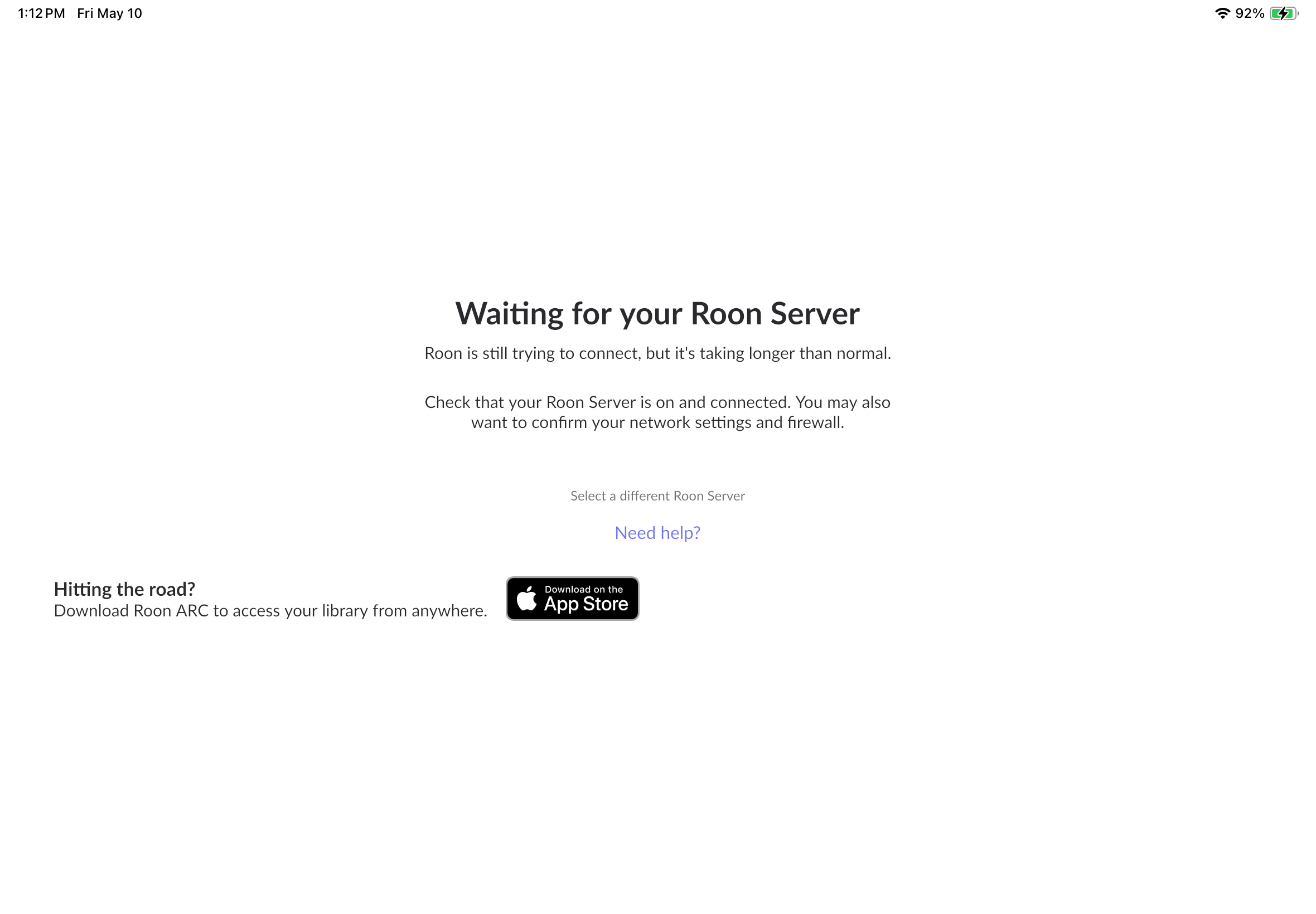

ROON cannot connect to my Nucleus core. I have rebooted everything including my internet modem several times. Under the Nucleus System Status I reinstalled the Operating System, Restarted the ROON Server Software, all said OK. But ROON still says it is waiting for your ROON Server……

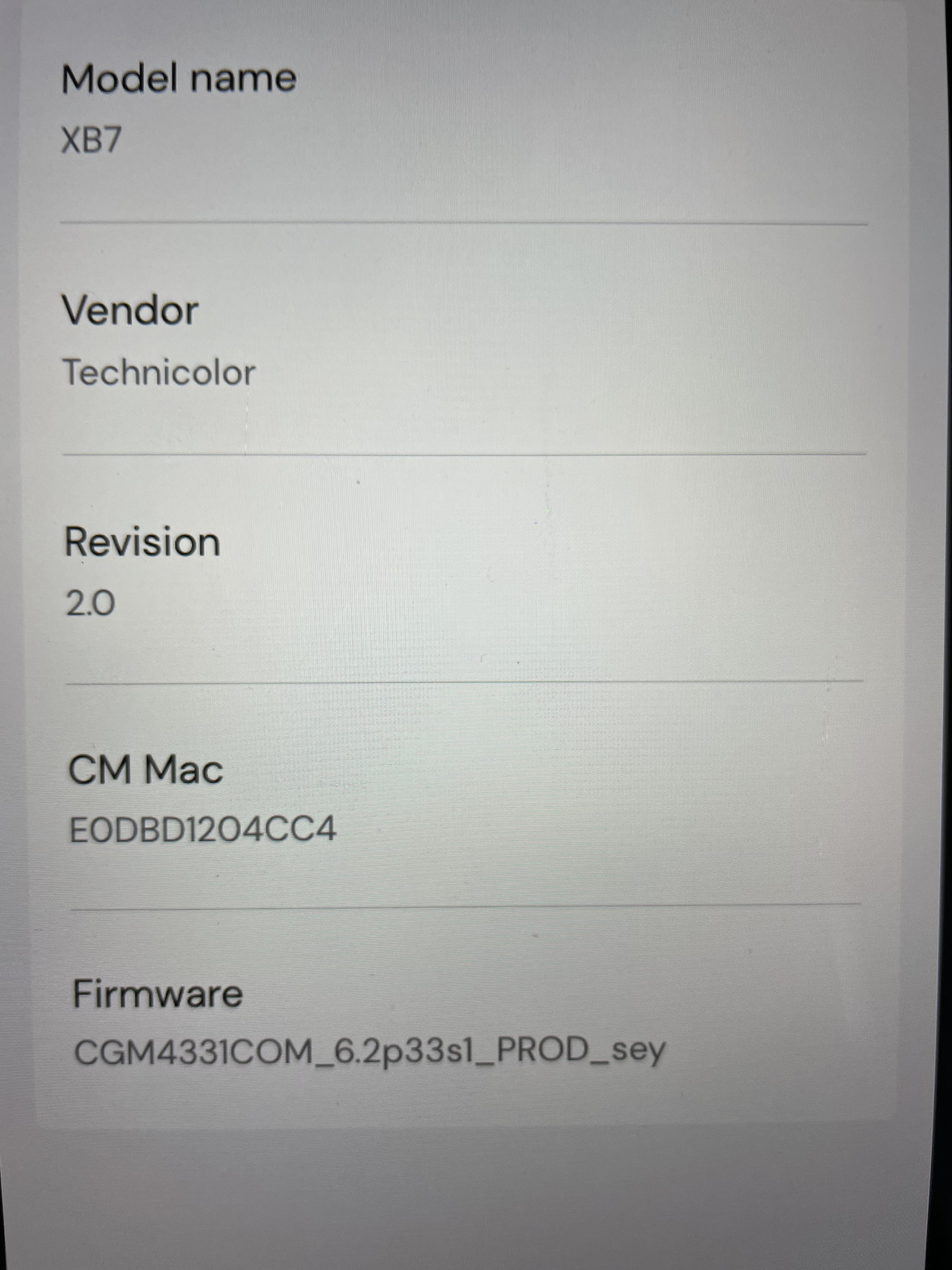

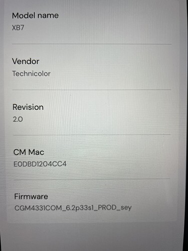

Do you see an IP for your Nucleus when reviewing your router settings? We were able to pull a diagnostic report for your Nucleus, but didn’t see any signs of hardware related issues. This points to a potential network inconsistency.
What model modem are you using? Do you know if it’s a modem router combo?

Benjamin I really appreciate your help. Let me know if you can open these images. One is my xfinity internet modem and the other is a screenshot of what ROON says when I try to open it

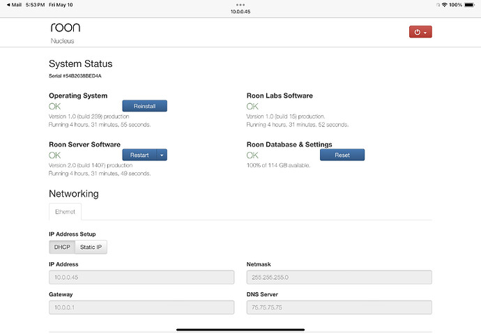

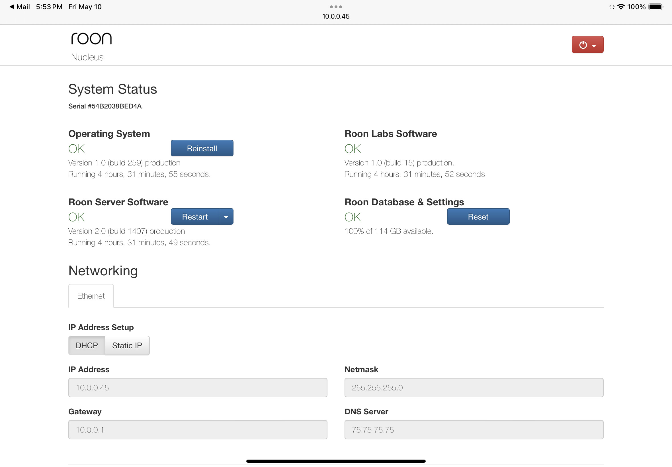

IP address is: 10.0.0.45
This is a screenshot of the Nucleus page that comes up when I type the IP address in my browser
Um - what happens if you click that “Select a different Roon Server” in Roon?
Your Nucleus appears to be up and running, but maybe your Roon Remote (which appears to be running on a tablet?) has been connected to a different Roon Server in the past.
If that doesn’t help, I would check to make sure that the tablet is in the same IP subnet as your Nucleus.

I selected select a different server and it is working. Have any idea why this would happen? Is there anything I can do to prevent this from happening again?
