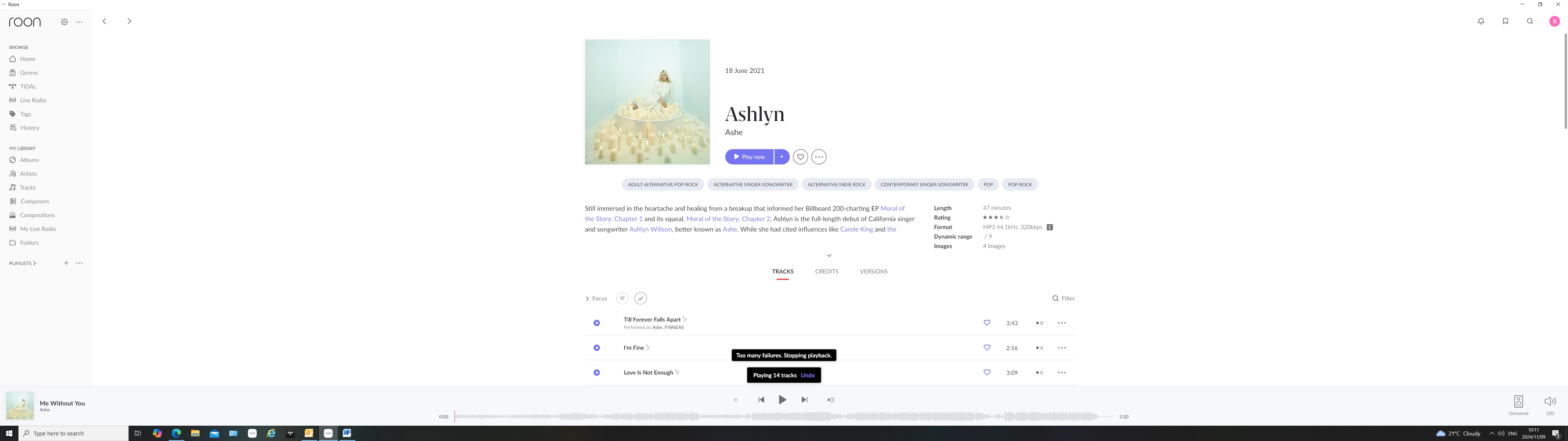

Hi Daniel thanks for responding. I tried playing a song on Roon at 10:54 & have logs after that if required.
Please advise if you require the logs.

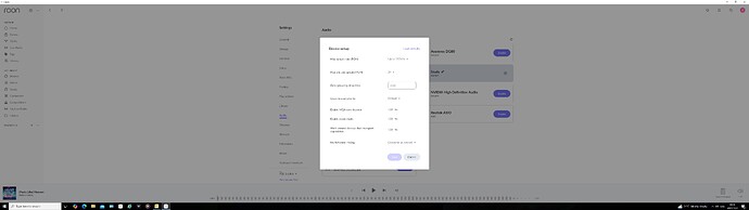

The two Zones associated with local drivers, SystemOutput and zone ASUS Xonar Essence STX Audio Device, are sending 16-bit/44.1KHz to a driver configured to accept only 24-bit files.
What do you have set as the bit-depth for this driver itself?
In Roon Device Setup for these Zones (Settings → Audio), verify that the Max Bits Per Sample (PCM) option is toggled to 24-bit or 32-bit.
Please share a screenshot of this Device Setup dialog window.
Also share a screenshot of signal path.

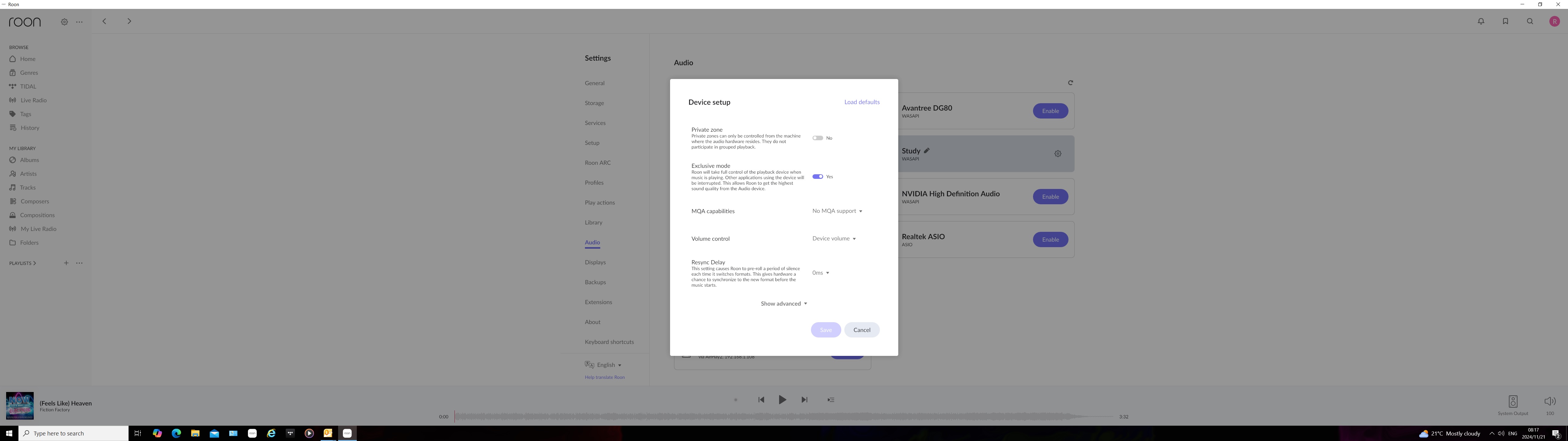

Hi Connor
As can be seen with the screenshot of the default zone (System Output), which it what it has always been on, doesn’t have the option to adjust the quality to 24-bit. The Asus one does and is at the correct bit rate & if I transfer the zone from System Output to Asus Xonar, it works.
The only thing that could have changed this would have been an update as these settings have never been touched. Is there a way to have the System Output have the option to change the bit rate?
