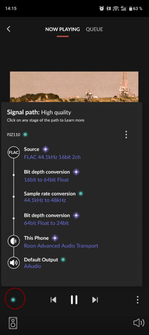

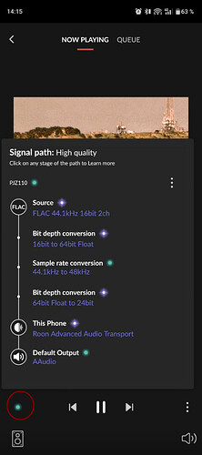

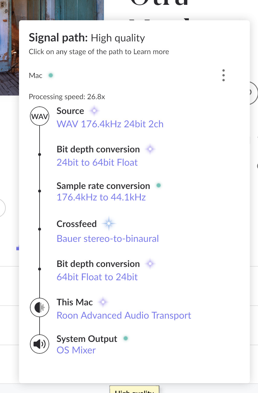

Thanks Vadim, I see.
Here is the screenshot if you can give me some guidance:

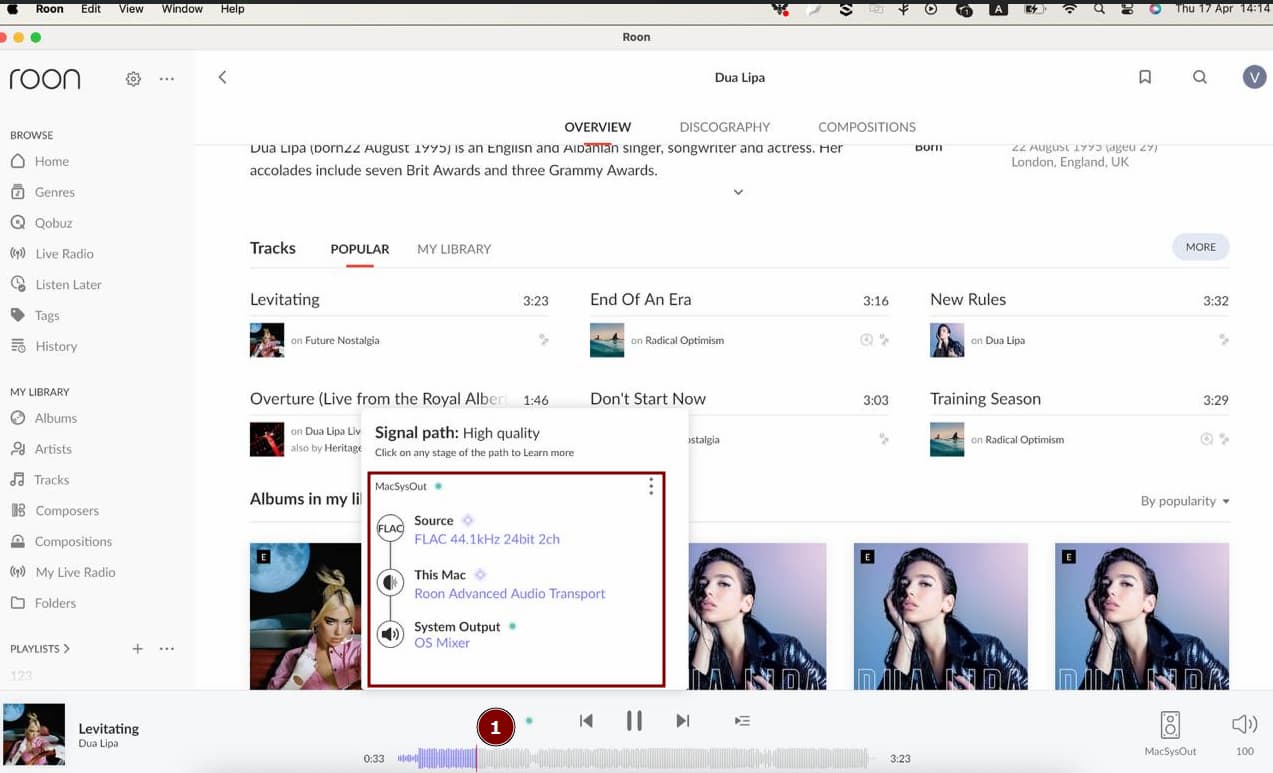

Hello @Acen_Grigorov ,
Thanks for the screenshot, this shows output using the OS Mixer. Just to confirm, if you navigate to Roon Settings → Audio, you don’t see any other outputs listed there? I noticed your Roon Server is not on the Mac, so perhaps this could be an issue with the Mac blocking the connectivity.
Can you please navigate to macOS System Settings > Privacy & Security > Local Network , and make sure Roon is allowed. If it is already enabled, toggle it off and on again. Then reboot your Mac, and see if the same issue persists.

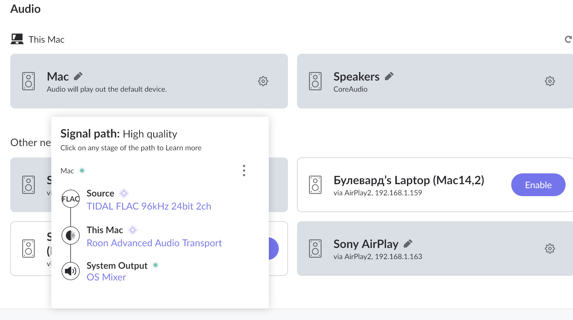

I did everything you adviced, but no success. - Restart, reinstall, forget and re- pair the earbuds, etc.

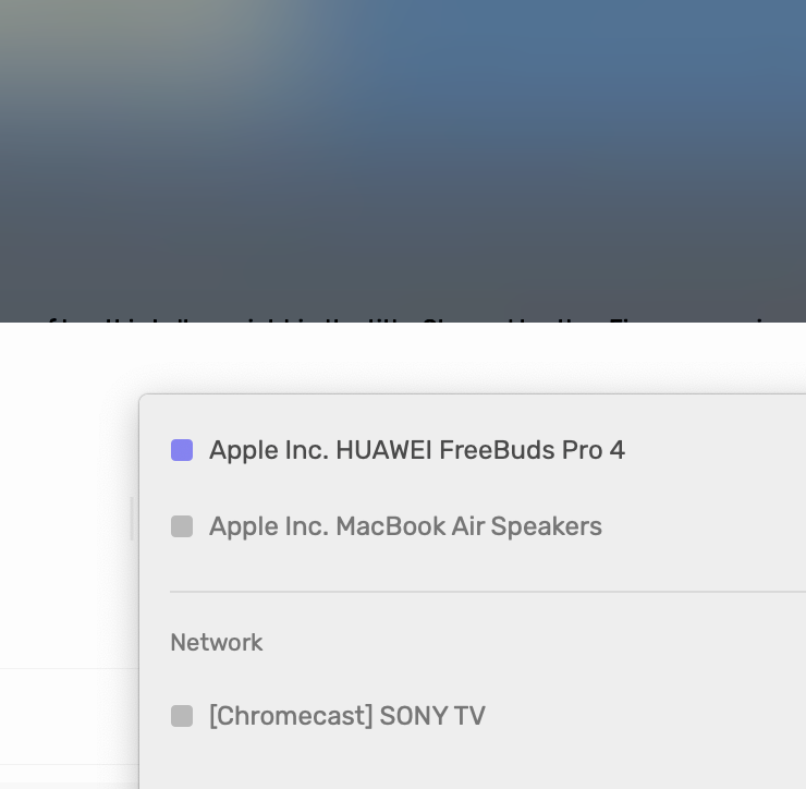

I sometimes use Audirvana - it sees the things differently:
Since the ROON is my preferred software, I’d very much like to fix it. Can we come with another ideas?

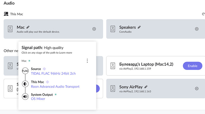

that’s what I exactly do. The problem is that the ONLY related output I see in the “Audio” settings of ROON is “My Mac”. That’s it and then this signal path crashes badly in the “OS Mixer”:slight_smile:
The Mac (or ROON) doesn’t seem to separate its internal speakers from the Bluetooth buds, like in Audirvana screenshot in my previous post.

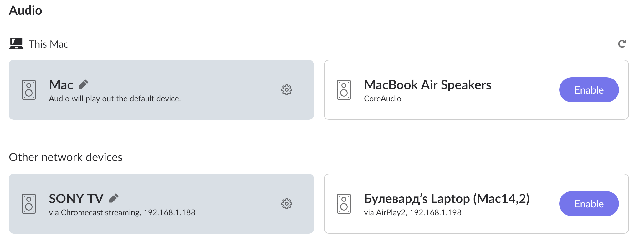

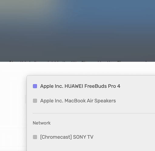

Hello @Acen_Grigorov,
Thank you for the update.
I just tested the behavior you described using a similar setup on my end — with both default speakers and a Bluetooth headset connected to macOS.
When I play audio to the System Output (labeled as “Mac” in your screenshot), the sound is routed to the Bluetooth headset. After that, I enabled MacBook Speakers as a separate output device, and I was able to play sound through the internal speakers. In your screenshot, this output is labeled “MacBook Air Speakers.”
Could you please try enabling this output device and see if the behavior is the same on your side?
Since the detection of the exact device connected by BT is not a current feature of Roon, I would recommend also posting your suggestion in the Feature Suggestions section of the site.
Our product team and developers keep a close eye on that category, so that’s definitely the best place to propose a change like this and get feedback from the Community.
Best regards,
Vadim
Output labeled “MacBook Air Speakers” enabled
Hi @Acen_Grigorov,
What is the selected output in your Mac Sound Settings for the above configuration? Roon is routing audio to the Apple coreaudio daemon, but the actual output for the chain will be whatever you’ve configured in your Mac settings.
