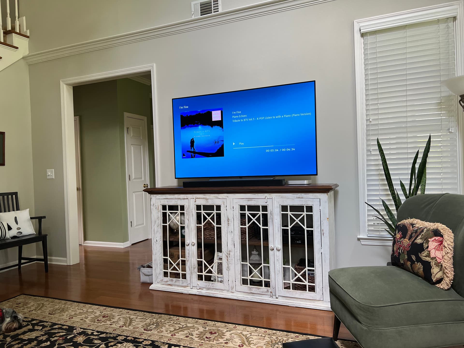

My setup requires my TV to be on. I use a Nucleus with RAAT via ethernet to Oppo 203. Then, it’s HDMI to LG OLED then HDMI ARC to Bose.
Yes Jim, but that’s comparing apples with oranges.
The OP’s setup is simply a ROCK/NUC → HDMI → AVR → HDMI → TV, and in this setup, you definitely want the TV to be OFF when playing music from Roon to the AVR…
