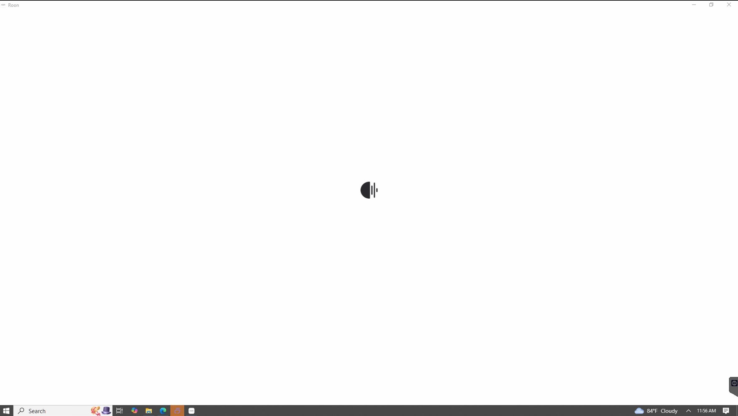

Daniel - same issue here. In my case the Roon now also goes whitescreen on me. I’ve been searching other threads on the whitescreen to no avail, but thge Zone drop out most prevalent

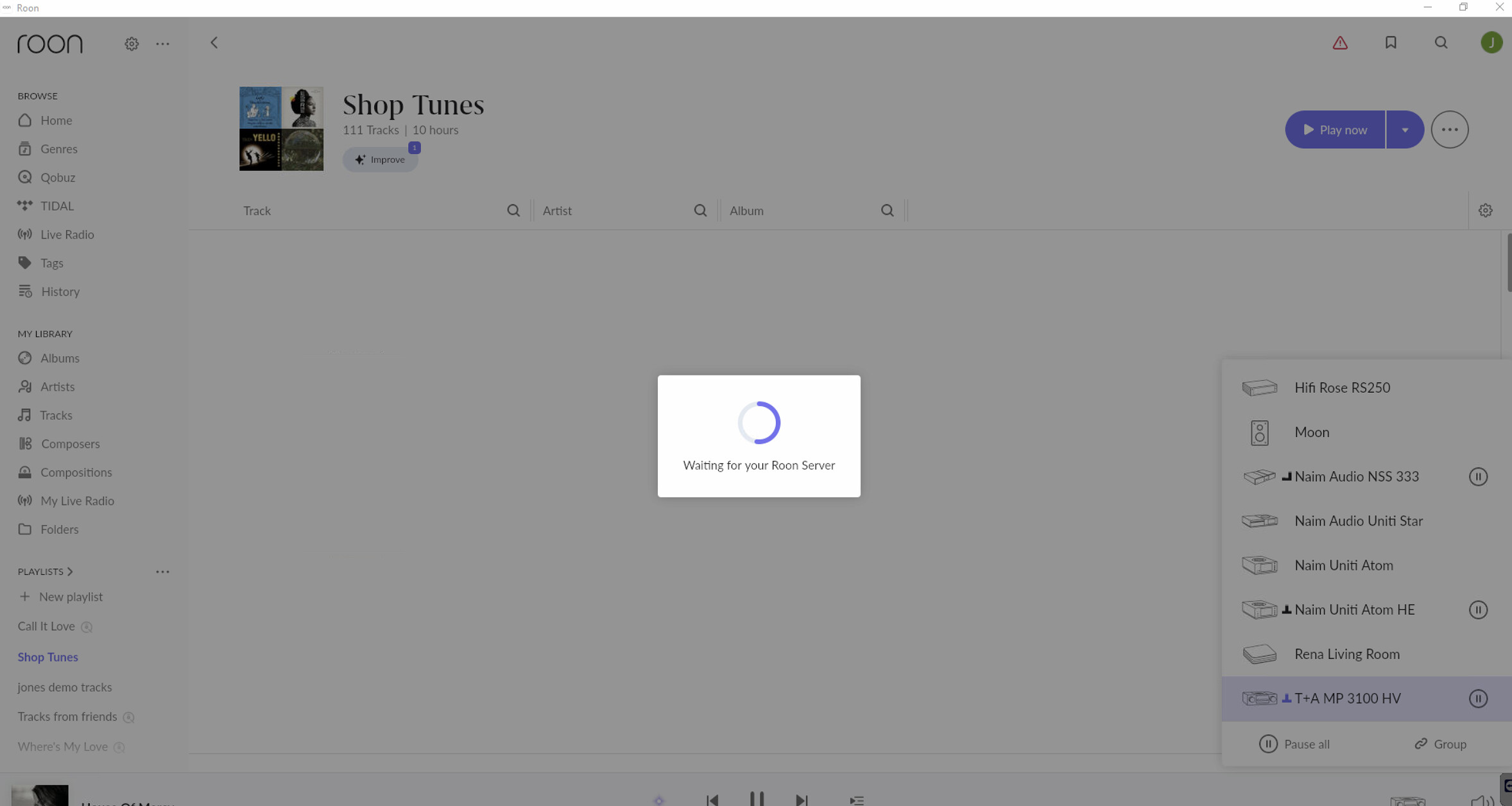

Carl - let me first preface by saying that we have tested our switches and router extensively for issues, and in the course of troubleshooting (this took place over a month ago) determined a few network drops that had shorts on a pair or two of twisted wire. Those issues were eliminated, and the Netgear M4250 AVB network switch was actually switched out when it became suspect (it was determined to be OK, however the new one remains)
As soon as we play a second zone, playback stops, the second image of squiggly Roon icon sists thinking for 45 seconds to a minute and a half, and often will come back minus any zones, which then repopulate after a couple minutes.

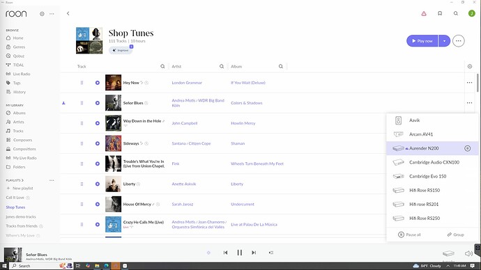

In this third image I had tried three zones - all streamed tracks from Qobuz, so no real network contention issues here. 1Gig/10Gb network mix, no music playing from NAS (QNAP 10Gb fiber link direct to M4250 switch). I have been able to play DSD64 to a six-zone group previously.
