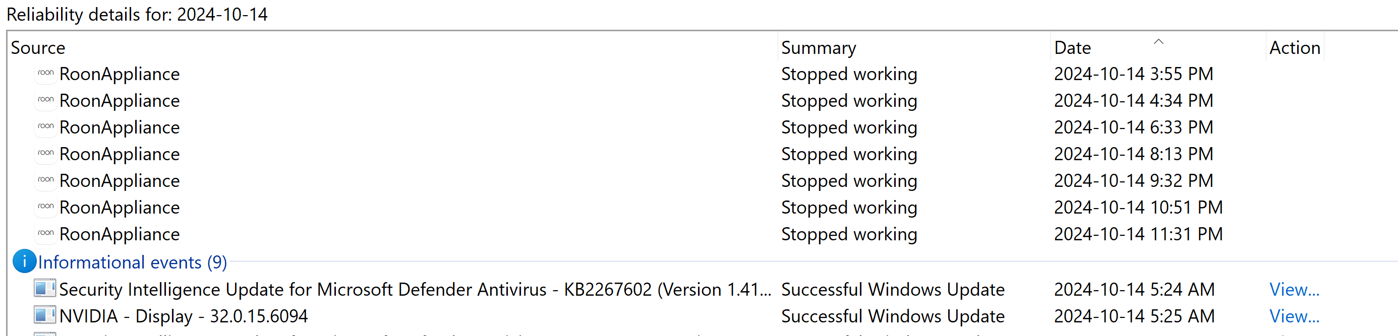

Windows Reliability History shows RoonAppliance (RoonServer) crashing exactly every 20 minutes since Aug 29 2024 while idle or playing.

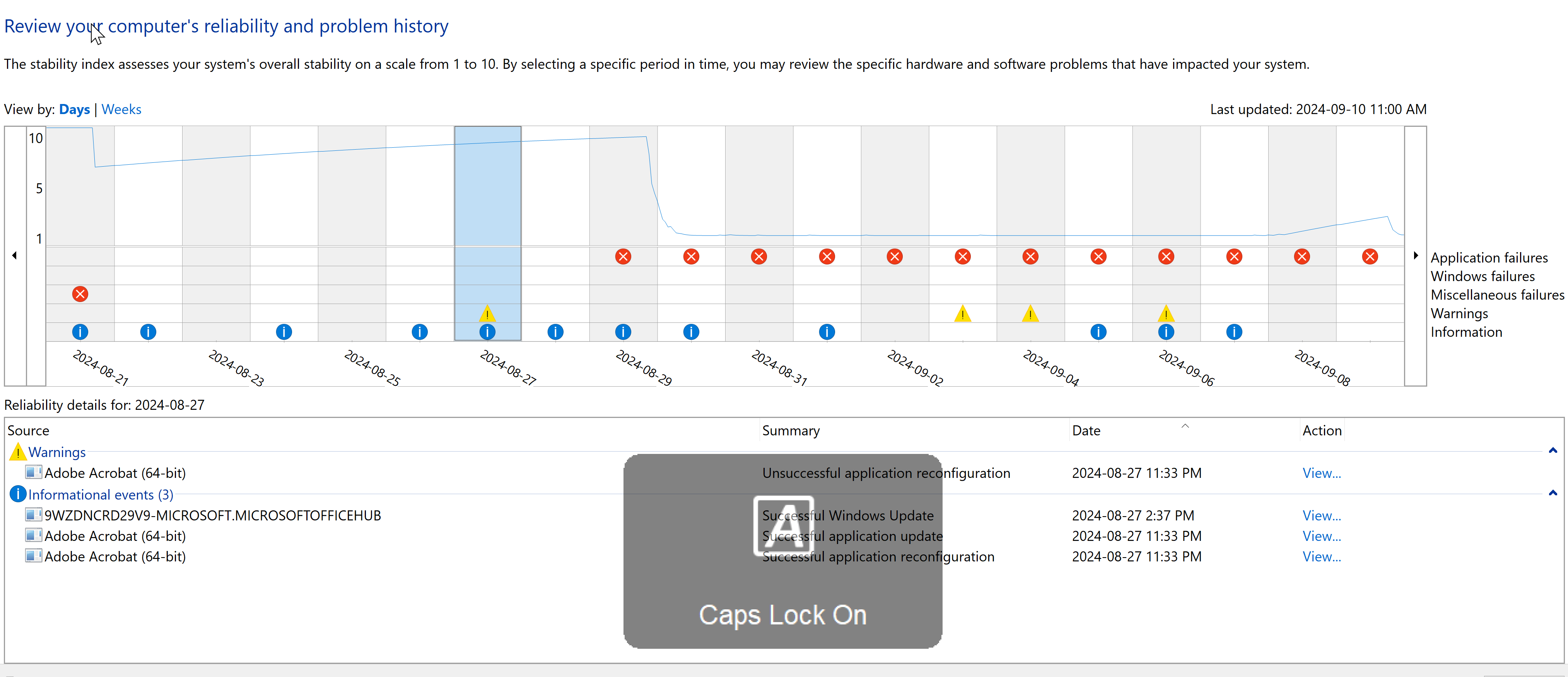

I checked my Windows log files directly and it looks like this stack fault has been happening since at least February. I have reported the memory issues before (as far back as March) but if a support thread goes 14 days without comment it just gets closed automatically.

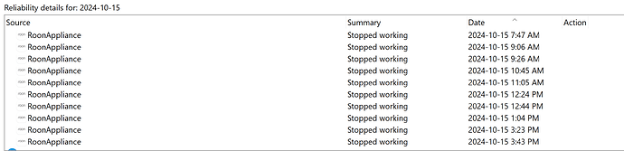

Apologies, was away for two weeks, unfortunately the problems still occurring. Will be uploading the crash dumps today.
Application Crash Dumps uploaded
Thank you @allen1! We’ve shared the files with our development team, we’ll follow up with more information as soon as possible :pray:

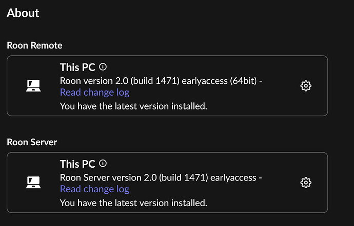

Have tried the Roon Remote and Roon Server early access versions 1471 as per @Andrew_Beveridge try with the versions. Got improvement in the amount of time between crashes initially
But then the 20 min gap has returned again today for the most part unfortunately.
Today’s crashes are with Roon remote being open but idle (not playing anything)
In other news have purchased the Nucleus One as this problem not being resolved has reached my limits of patience unfortunately.
Have uploaded the updated 15th Oct RoonAppliance.exe (1471 Early Access) Crash Dumps to help with the investigation.
