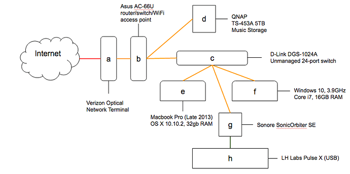

The ā€œnon-standard MTUā€ thing was my first guess, and @danny’s too. I know that RAAT uses ā€œlargeā€ (4k) UDP packets, and if devices on a network have inconsistent ideas of how to deal with them (i.e. some devices fragment them, and some don’t) things like this can happen. For a clean test, all devices should have this feature disabled. But I think you already did that.
Iit’s also clear that something more than just using Windows + RAAT is required to see a problem. We know that because I’ve been using Windows + SonicOrbiter for a few months on a daily basis (Win10+SOSE drives the headphones in my office…all day, every day). About a month ago I switched that machine from 8.1 to 10, so both OS’s have a good track record of high res playback, at least in my environment.
This is what my environment looks like–RAAT works on this network from both computers in the diagram:
That it works on my network and not yours tells us that there is an environmental component to this problem.
From the logs, we can be sure that the app on the windows machine is sending packets.
From the logs, we can be sure that the app running on the SonicOrbiter isn’t receiving them.
We know that turning on Wireshark on the Windows machine hides the problem and allows packets to flow. This result suggests that this issue is related to networking, but it doesn’t tell us how.

Can you throttle that QNAP back a squidgen? Perhaps the Windows net commands are like filling 5 gallon can with a firehose.

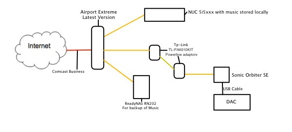

Attached is diagram of my network. I have power line adaptors in place, but have removed them and replaced with cat5 to test, this did not fix the issue. Readynas is not used for music playback. iMac, not listed is wireless. It does not look like we have much in common save for the sonic orbiter se.

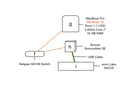

Hi @brian - I go back and forth thinking it’s a network problem and thinking it’s a different problem. I just removed most of my network for testing and still have the issue. Here is a diagram of my current testing setup.
The Netgear GS108 switch is dumb/unmanaged.
I even removed the network link to anything else on my network including Internet and NAS.
I stored all test files locally on my laptop.
The new network path is MacBook > Netgear switch > SOSE
Still the exact same issue.
The only other thing I can do is ssh into the SOSE and give it a static IP address, connect a cable directly from my MacBook to the SOSE and stream audio directly to it without a network.
