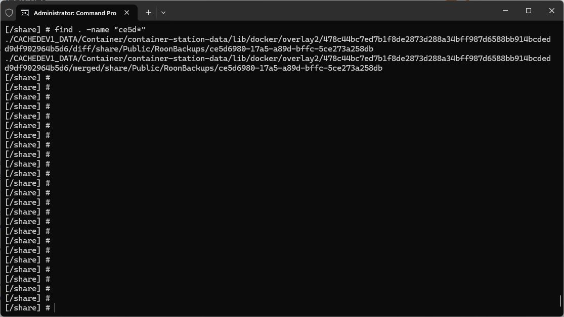

· On QNAP QTS I just updated to roonserver 1653 using the container. I was able to map the location of roon database and my music files but mapping of the roonbackups did not work.
Backups are in /share/Public/RoonBackups and roonserver thinks this directory is empty but there is a backup starting with
ce5d in it, which is empty, but does not exist in /share.... I did a backup and found the following directory:
/share/CACHEDEV1_DATA/Container/container-station-data/lib/docker/overlay2/478c44bc7ed7b1f8de2873d288a34bff987d6588bb914bcdedd9df902964b5d6/diff/share/Public/RoonBackups
with the contents:
drwxr-xr-x 244 admin administrators 4096 2026-04-28 21:09 ce5d6980-17a5-a89d-bffc-5ce273a258db/
-rw-r--r-- 1 admin administrators 19 2026-04-28 21:08 _roon_backup_root_
I need to restore the last backup as the server upgrade process destroyed the meta-data.

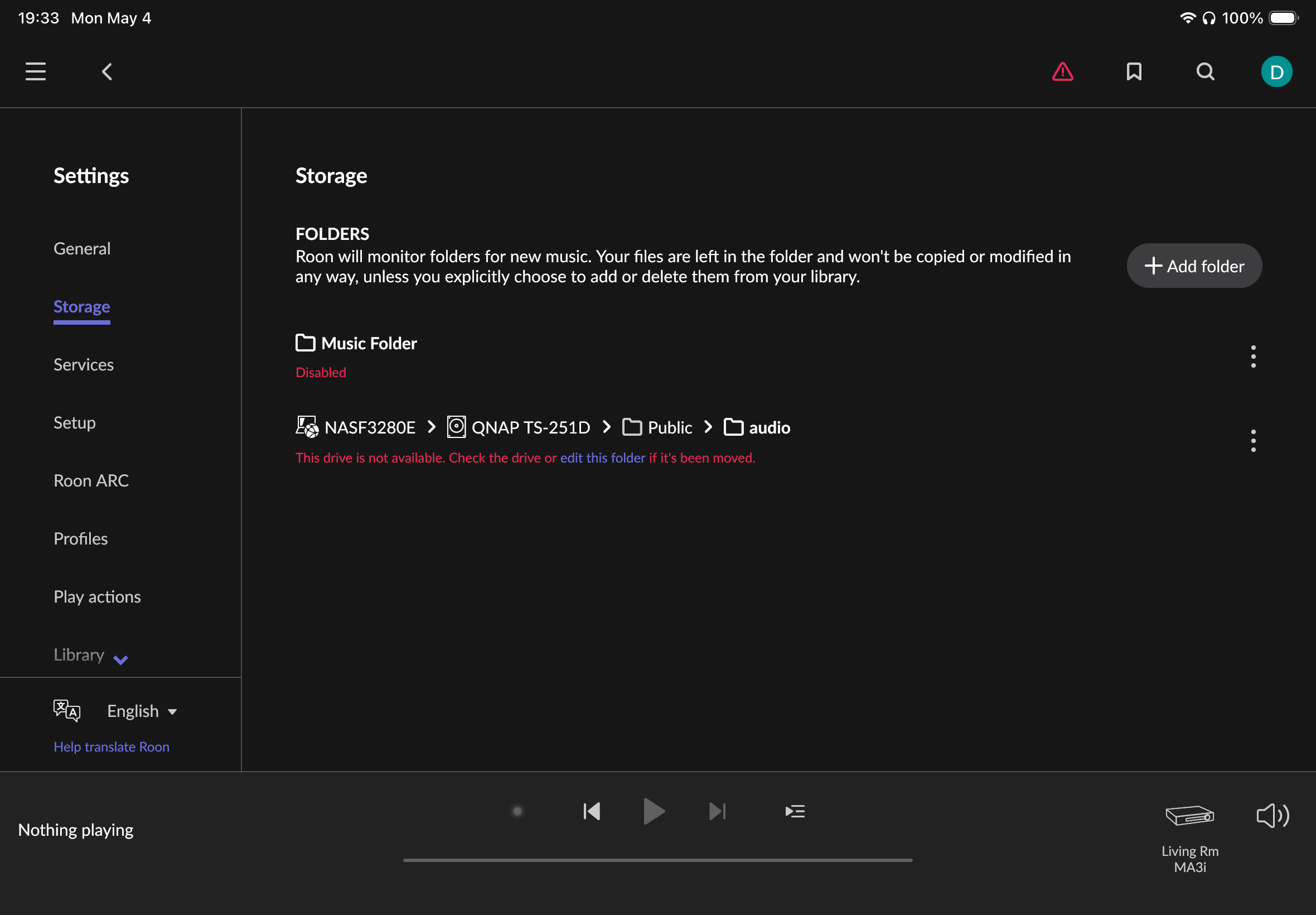

After the restore I relaunched and logged in. Settings→general then showed
I enabled Music Folder and Roon imported the files in …/Public/audio. No album title edits restored. I am resolved to using Roon to play music and forget about edits and backup/restore.

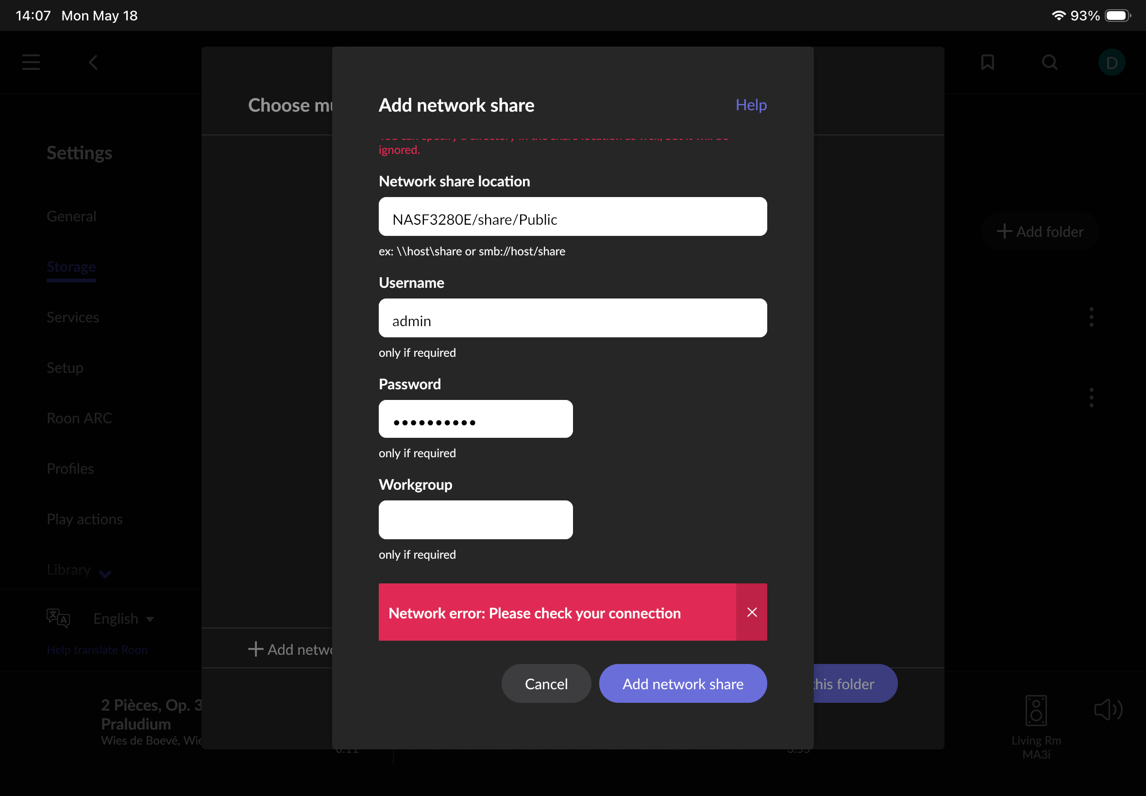

Hi Vadim,
I got to the fifth bullet after step 5, new mapping for music and got the following error.
I tried various entries in “Network share location”, eg NASF3280E, and all gave an error. I aborted roon remote to try again but then roon thought I was setting up a second server and roon remote could not find the one I was working with.
I re-established the “database” directories and roon server, sans edits, is up now.
I suspect roon is too complex (or obfuscated) to resolve this. In any event that is
the way it has evolved and I should use it for playback only. Thank you for your efforts.
You are trying to add a network share. Read step 5 again, it didn’t say that you should do that.
Correct, but Roon forced that on me.
How?
Did it pop up the Add Network Share instead?
Yes, and it rejected my correct entry. Dead end.
Weird. Then I think it’s back to @vadim

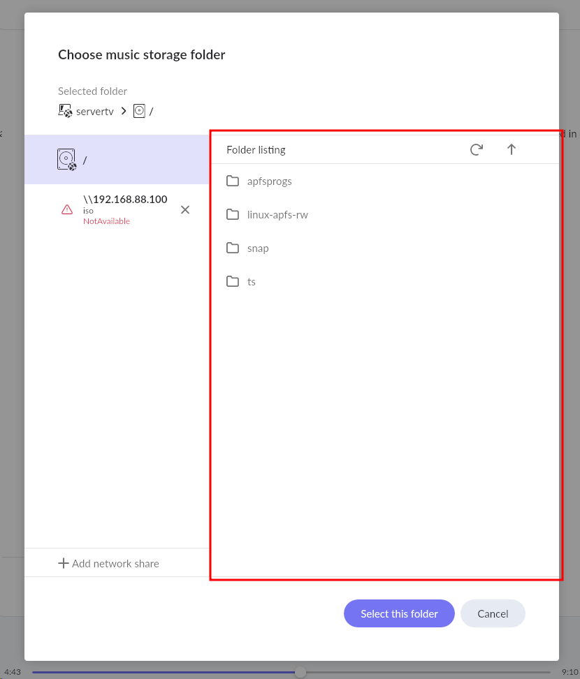

Hello @David_Elm,
Thank you for the screenshot! Now I can clearly see exactly where you are getting stuck.
You are trying to add your music using the “Add network share” option. However, because you are now using Docker, you do not need to connect to your music over the network (using an SMB/IP address).
Your Docker configuration file has already physically mapped your QNAP’s Public folder directly into the container if everything is set correctly in the YAML compose file. To Roon, these files now look like regular local files on its own internal drive. This is why trying to add a network path is throwing a connection error.
Here is how to link it up correctly:
  1. Click Cancel on that red error window to close the “Add network share” prompt.
  2. Once again, click the three dots () next to your old, unavailable music folder and select Edit.
  3. When the “Choose music storage folder” window opens, completely ignore the “Add network share” button at the bottom left.
  4. Instead, look at the main folder navigation panel right in the middle of the screen. You should see the root folder structure (starting with /).
  5. Navigate through that list of folders. You are looking for the exact folder you specified in your Docker YAML configuration (depending on how you mapped it, this is often /share/Public, /music, or /app/music).
  6. Open that folder. Once you can actually see your artist and album folders inside, click the Select this folder button at the bottom.
Because this points directly to the container’s local file system, Roon will instantly recognize your files and restore all of your previous edits and settings. Give this a try and let us know if you can spot your music folder in that local list!

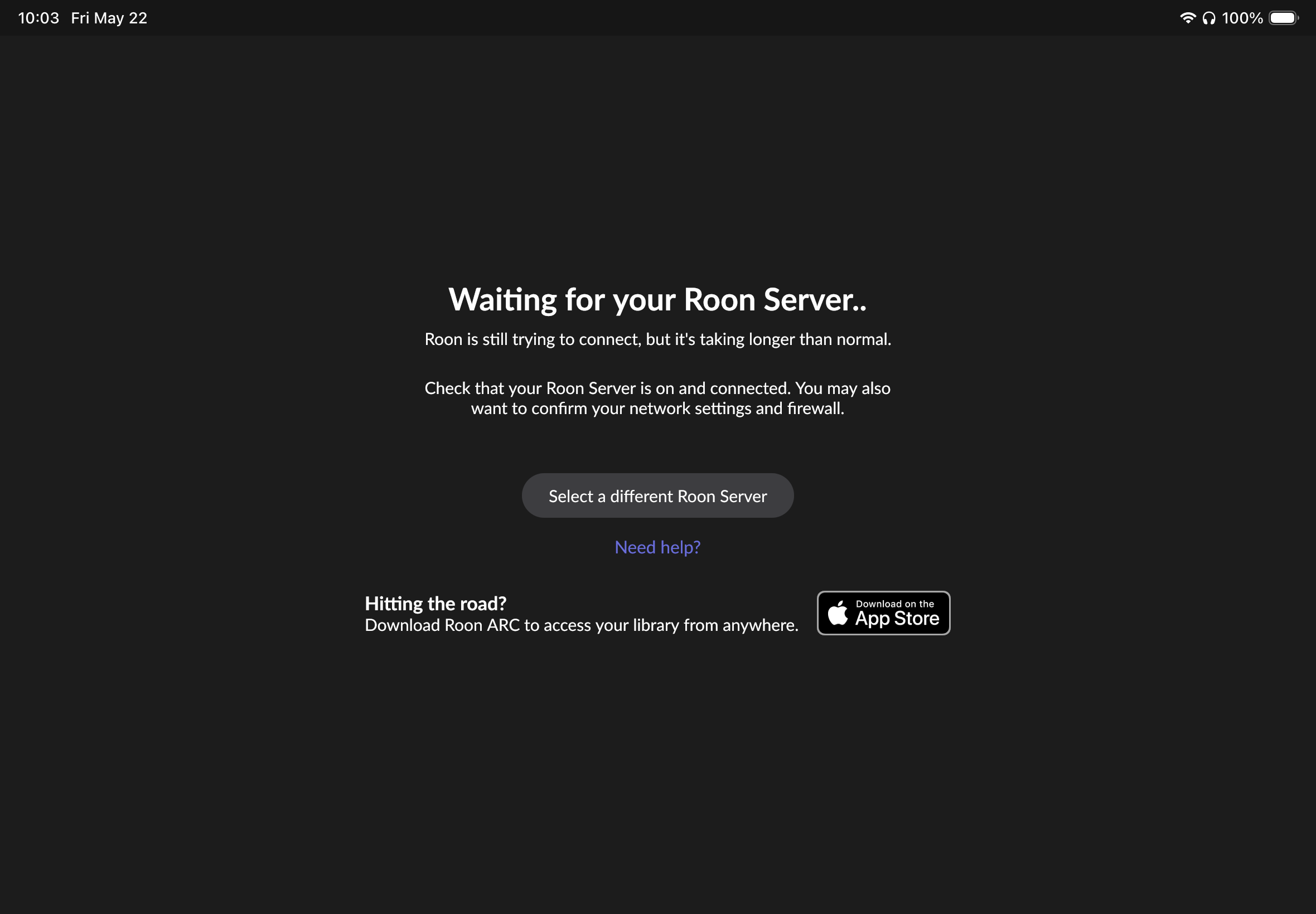

Hi Vadim,
I could not get to your latest suggestions. I logged out of Roon server on
NASF3280E, stopped the container, renamed database directories so pre-container database is found on server restart, started the server container. Then roon remote
could not find the server. I waited several minutes. This was about 10:03 local time, May 22.
It was chaos after that and I reverted the server database back to the current in use
for a few weeks. Please close this ticket as the beast in unpredictable.
