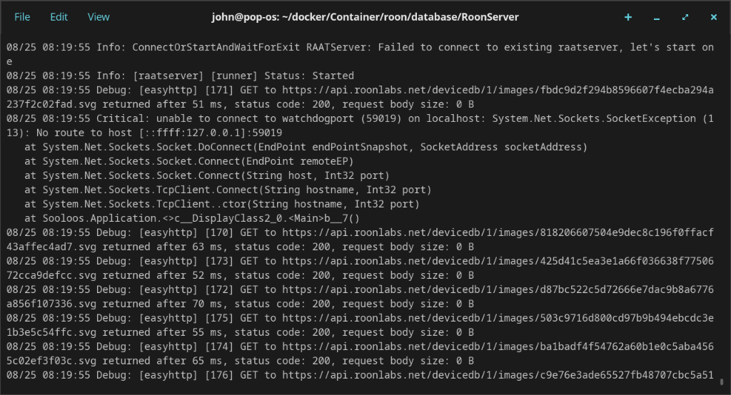

According to the logs, it's looping on:
08/24 16:18:48 Critical: unable to connect to watchdogport (56093) on localhost: System.Net.Sockets.SocketException (113): No route to host [::ffff:127.0.0.1]:56093
at System.Net.Sockets.Socket.DoConnect(EndPoint endPointSnapshot, SocketAddress socketAddress)
at System.Net.Sockets.Socket.Connect(EndPoint remoteEP)
at System.Net.Sockets.Socket.Connect(String host, Int32 port)
at System.Net.Sockets.TcpClient.Connect(String hostname, Int32 port)
at System.Net.Sockets.TcpClient..ctor(String hostname, Int32 port)
at Sooloos.Application.<>c__DisplayClass2_0.b__7()

Why the connection fails. Look at the address in your own log:
No route to host [::ffff:127.0.0.1]:59019
That is the IPv4-mapped IPv6 form of
http://localhost
. The connection is being made through a dual-stack socket, so even though the target is 127.0.0.1 it needs the IPv6 stack to be present. You have:
net.ipv6.conf.all.disable_ipv6 = 1
With IPv6 disabled in the kernel, that address is unreachable, which is exactly the error code 113 you are seeing. Container runs with network_mode: host, so the host’s setting applies directly to it.
