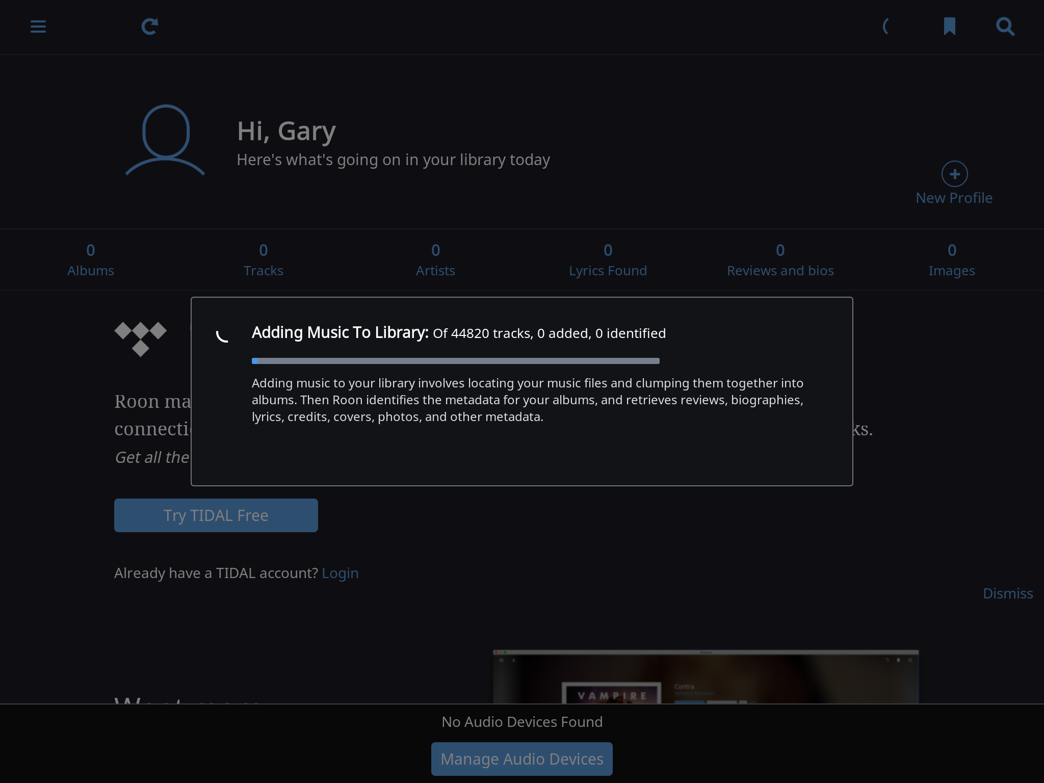

SETUP:
Roonserver PC: Clean install of Server 2016 in core mode.
Roonserver installed.
Audiophile Optimizer V2.2 Beta5 (which allows Roon to work in Server 2016)
Music stored on hard drive in same PC
PROBLEM:
Initial setup, Roon looks for music drive and finds it ok.
Starts finding my 65K+ tracks
Doesn’t identify any as it counts them up though as it usually does?
…here comes the weird bit…
The track counter gets to the end of all my tracks…then starts counting backwards to zero - again without identifying any tracks!
TROUBLESHOOTING STEPS TAKEN
Reinstalled Roon - same issue is replicated
Reinstalled Server 2016 - as above.
Out of ideas guys, never seen this “countdown back to zero” behaviour before.
Wondered if it was a network share issue as I’d just installed a clean copy of Server 2016…but Roon WAS finding my tracks ok, just wasn’t identifying them.
Edit
Forgot to say, also getting the message “Transport failed to load media”, and Im getting this with two different Endpoints.
Any help appreciated.

But not so much…here:
0 tracks added, 0 identified despite Roon counting them up.
Counts em all up (0 added) then counts back to 0!
Problem still exists, continuing troubleshooting…
Others haven’t had any issues running Server 2016 Core/Roon so shouldn’t have to but…
Wondered if it was a Windows Server core issue with the Fileserver Role, so went into Powershell and made sure that Role was enabled.
All looks good, yet despite enabling all filesharing Roles in Server 2016, firewall off, full network reset and even reinstalling Roonserver…
Problem hasn’t changed.
