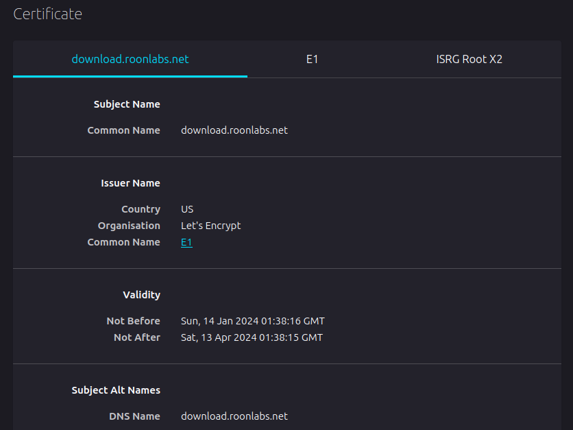

No issue here downloading the file from the link above from my desktop computer with Firefox browser.
No complaints about the certificate (and I had those in the past with Firefox and expired certificates on Roon sites).

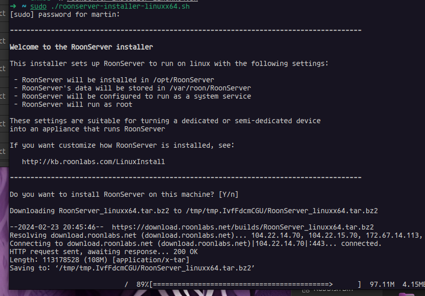

There’s nothing wrong with the certificate, and the installer works fine.
