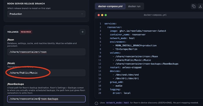

The second share path line in the docker generator is pointing roon in the container to your music files. If something is wrong with either the syntax of the share path, or the name of the folder/volume, files cannot be accessed by roon in the container. If the top-level folders are correctly shared in QNAP´s file system, and volumes mounted correctly, just insert the name of the top-level folder in the share line path:
/share/Multimedia
which leads docker to redirect roon in the container to see the files, thanks to the following line generated:
/share/Multimedia:/Music
If you are uncertain about folders´ names, feel free to share a screenshot of File Station showing the main hierarchy of volumes and top-level folders.

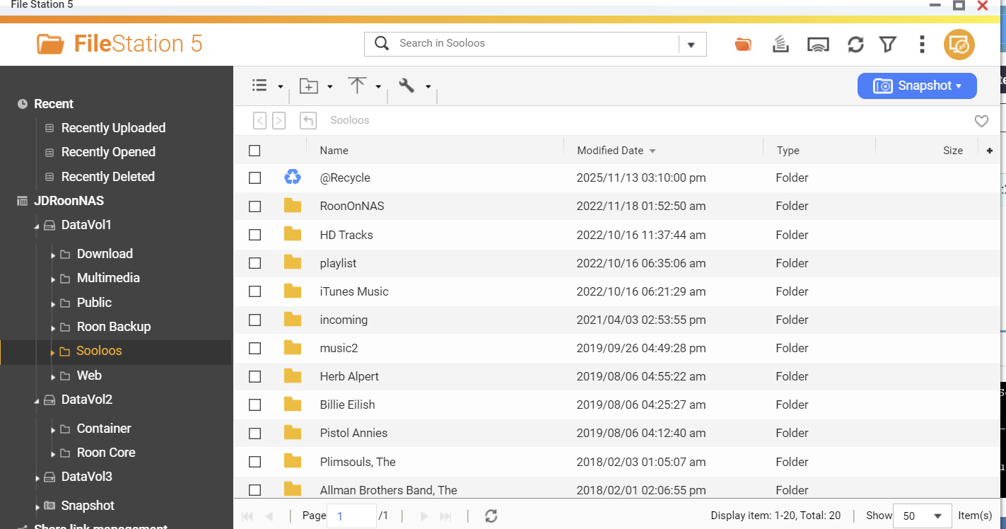

my music files are stored in the file Sooloos. I don’t see where to make changes to the path in Container. Please advise.
Go to Github docker generator, and enter the following share structure as the second path (instead of the default /share/Music which is leading to nowhere in your case):
/share/Sooloos
So the final line in docker script on the right should read:
/share/Sooloos:/Music
You can also edit the script in Container Station and update the container. If the top-level folder /Sooloos is correctly mounted, this should do the job, and all your files should appear in roon under Settings > Storage > Music Folder - if you enable that one.
