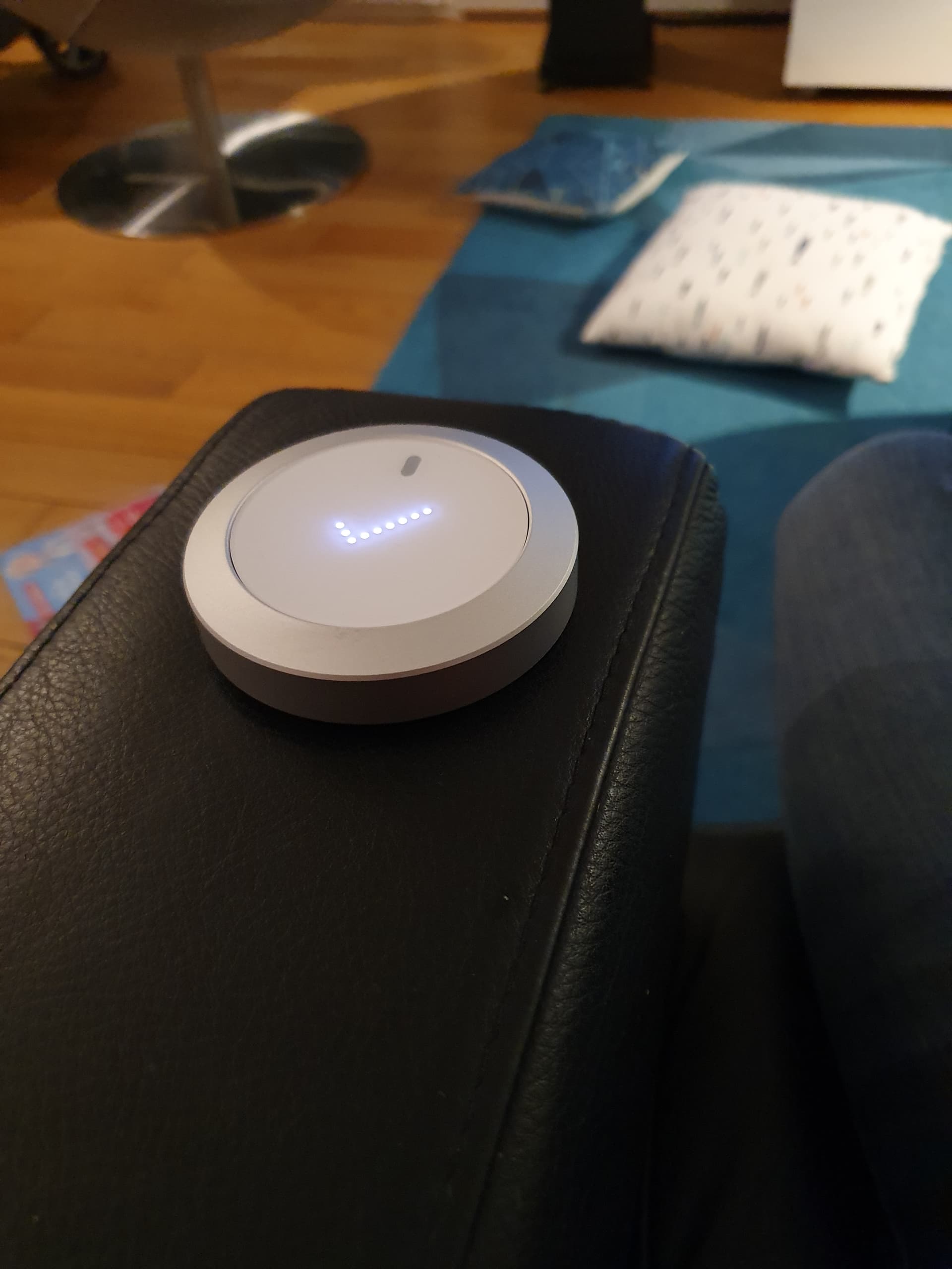

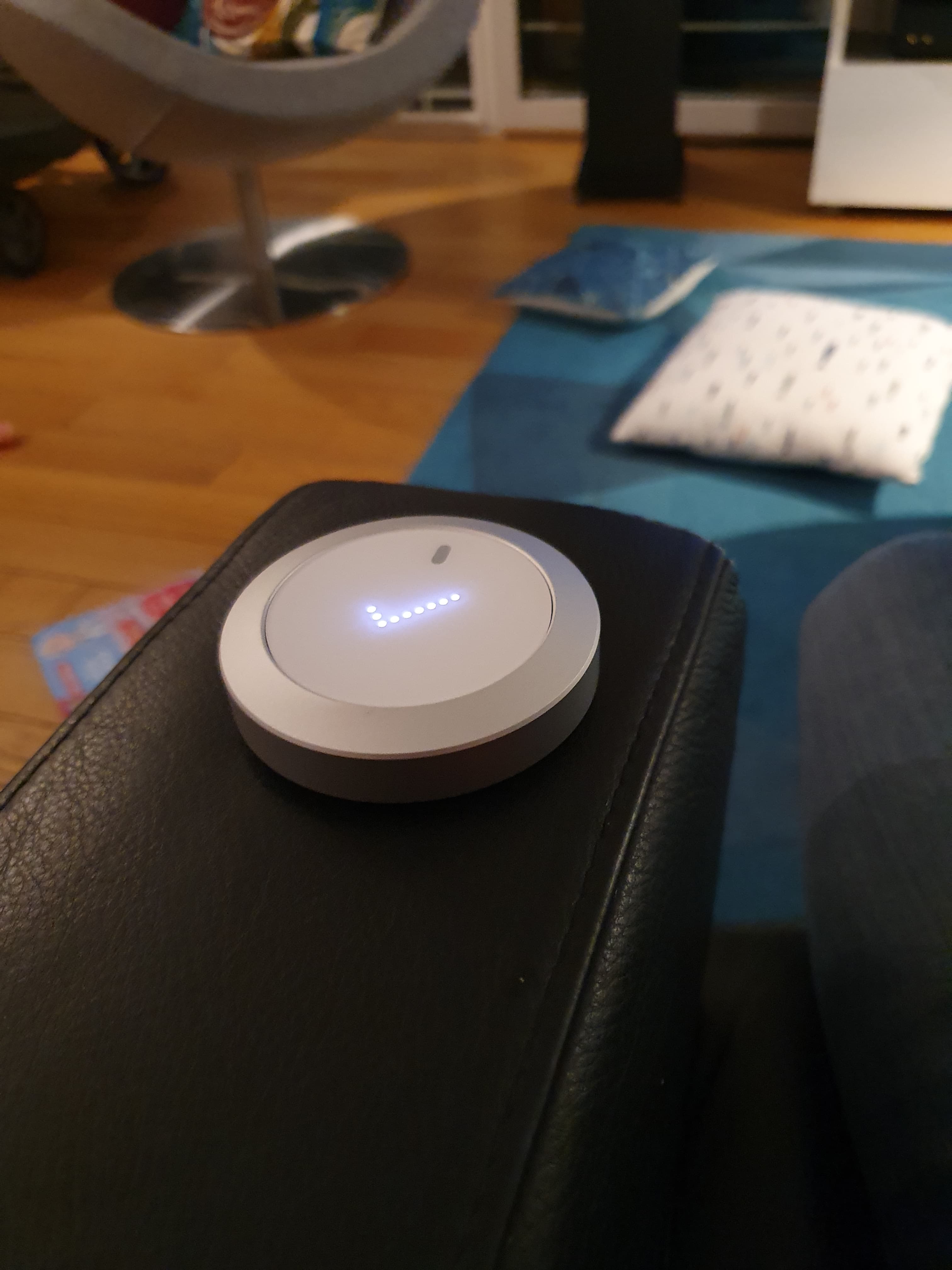

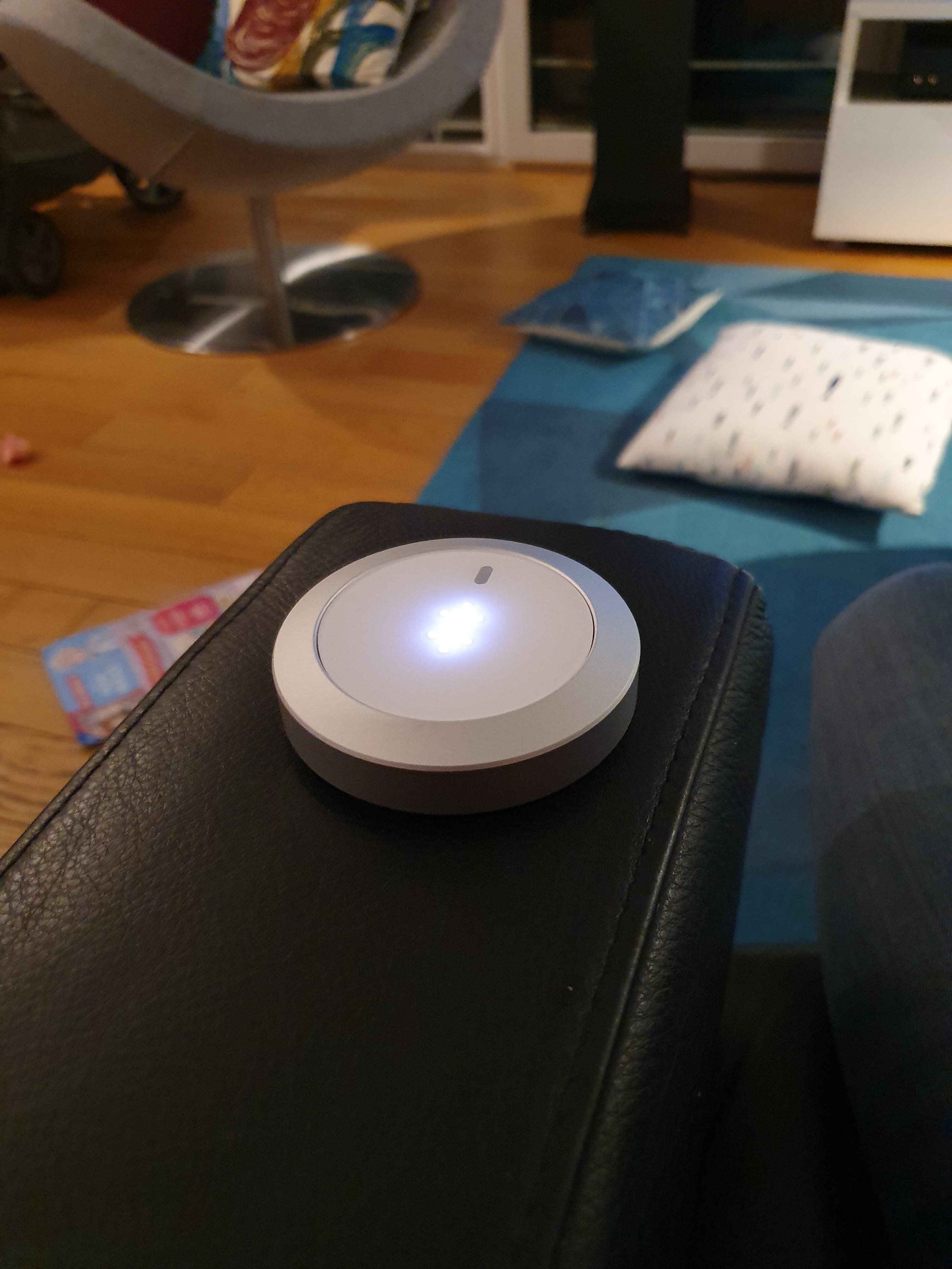

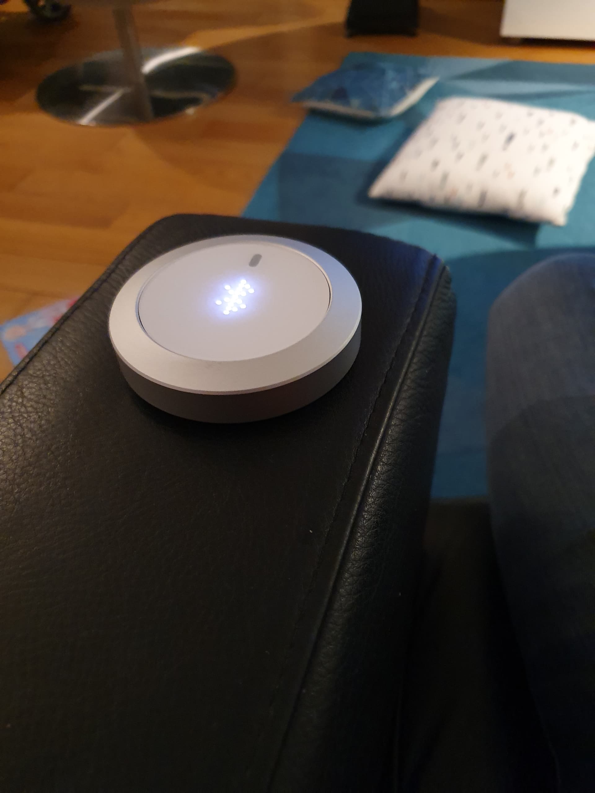

Hi I have an issue with bluetooth.
When it is not playing music I see that:
Then
Then it starts again
And again
It continues like that for a while and stop…
And the raspeberry pi 4 is not so far (in the white furniture top right corner)

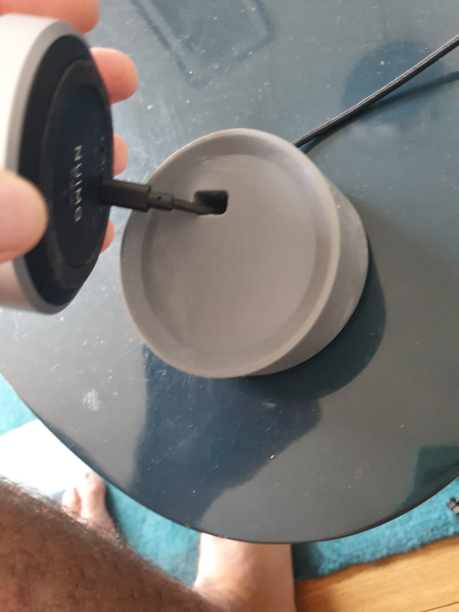

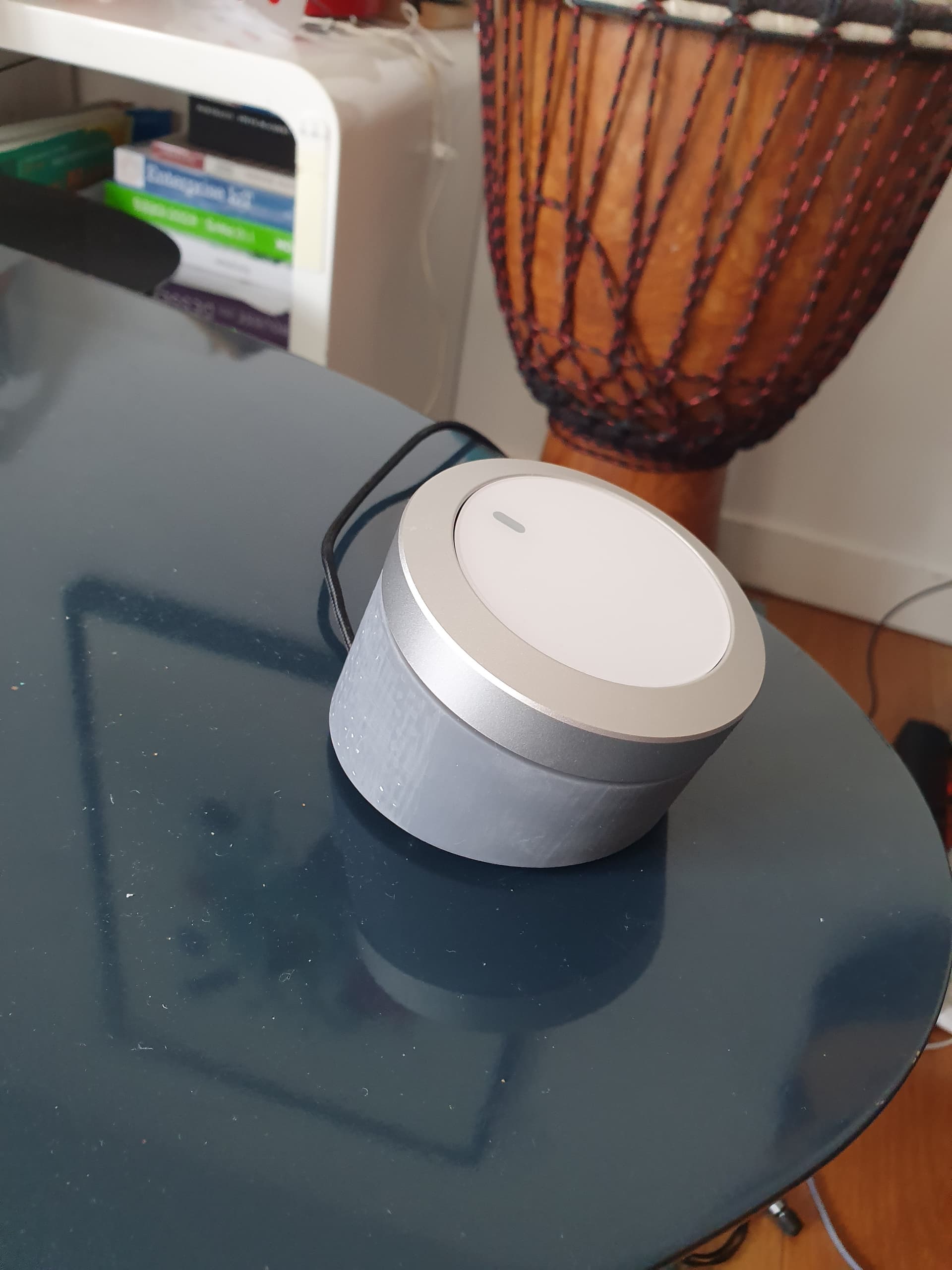

I found this:
I found the 3d plans here
Then I submitted the plans to 3D printing companies. I just used Google to find them and choose the cheapest offer. Depending on options you select(material, color…) it can be between 50 and 100 euros (or more).
Hoping this help

This is a cool stand and I also got one 3D printed :+1:

You can still move it. Just get it back to the base when needed
Thanks that actually makes sense.
Time to look around for friends I have helped out who have 3D printers :grin:
