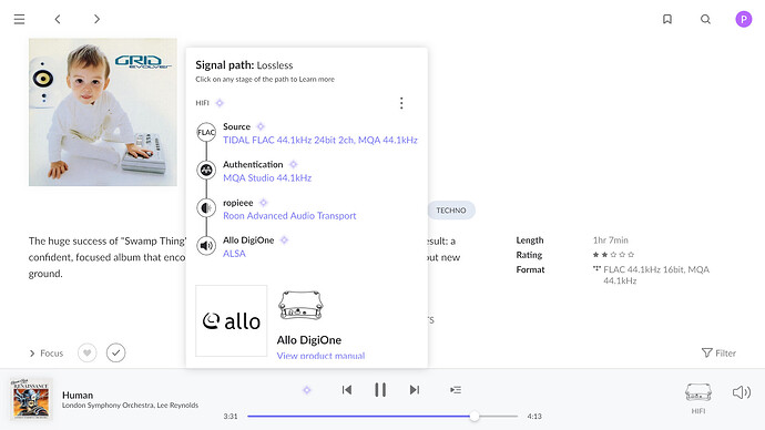

this is my roon feed. I’ve tried both coax and usb. I’ve heard Tidal might be dropping MQA but i’m hoping it’s just anything new and not the existing library.
All indications are FLAC is being added in addition to MQA, at least for now. Who know what will happen down the road.

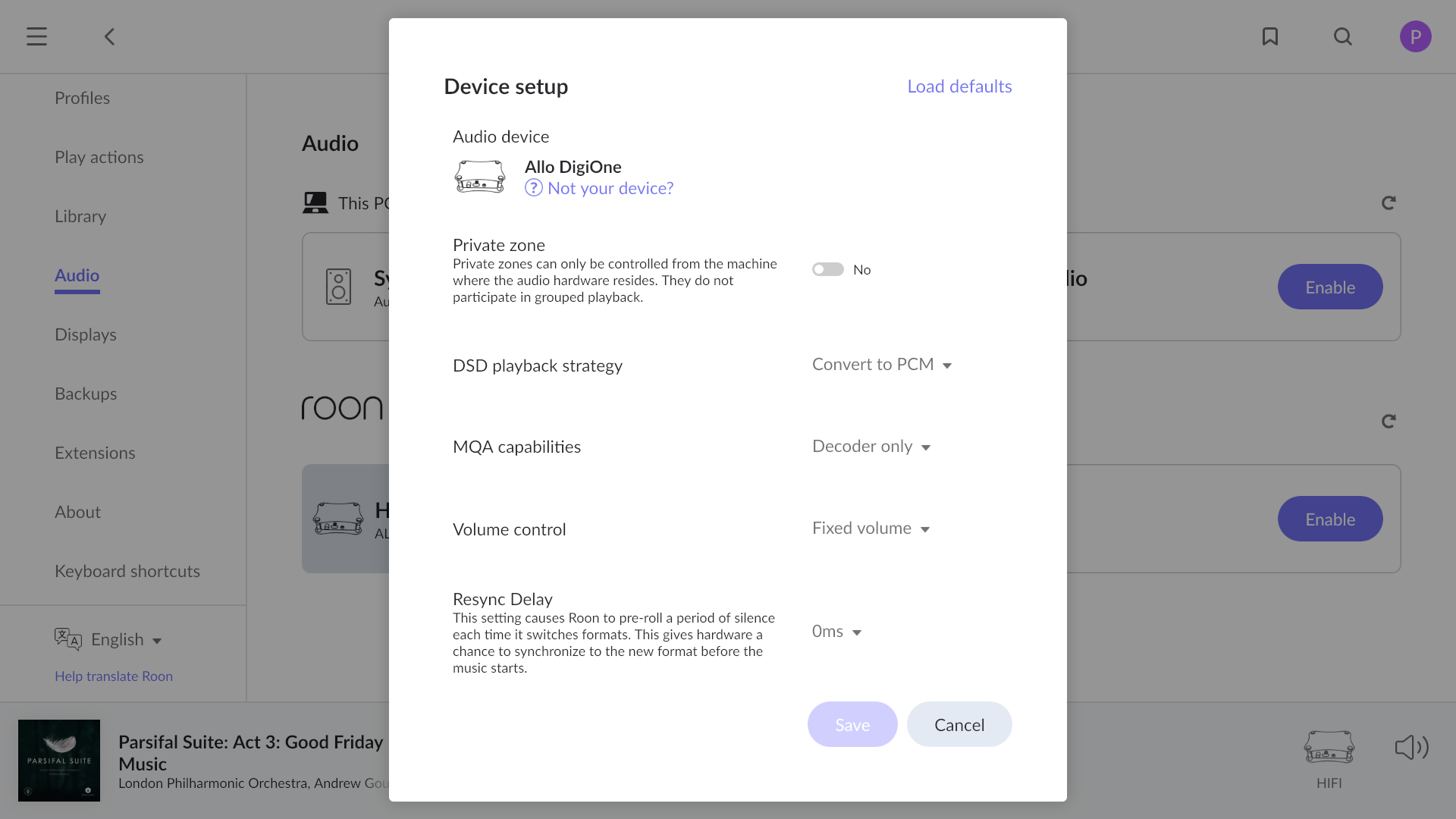

This is me config(forget the enable thats another device) this is for my digione coax output
According to another poster above MQA capabilities should be render only since that is all your DAC does. Also, you need to scroll down for core decoder setting.

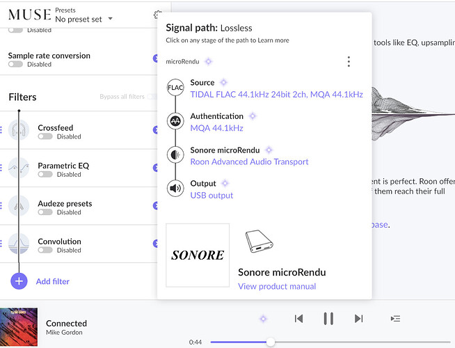

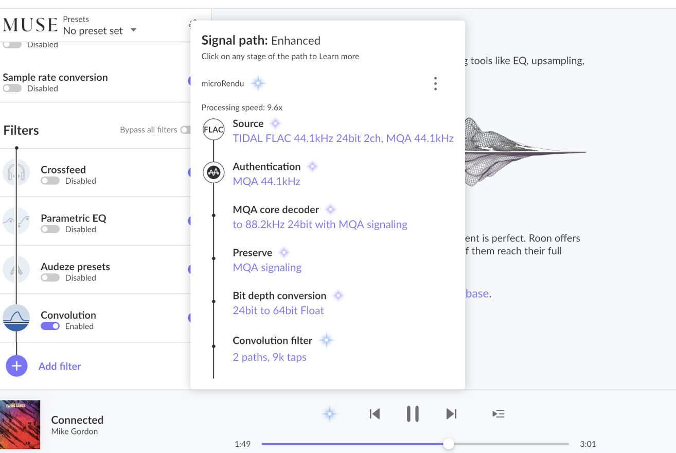

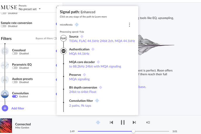

Actually I am using Topping DX5, not E50. I do get the ORFS signal when I apply the convolution filter for my headphones and OFS lights up on the DX5. When I turn off the convolution filter then MQA lights up on the DX5.
That is how it is supposed to work. ORFS just indicates that something else is doing the core decoding before the DAC. Your DAC apparently does decoding and rendering, so if you have the settings correct in Roon (core decoding on, decoding and rendering selected) Roon will handle the decoding only when needed which is what you are seeing in your signal path and on the DAC’s display. I’ve had four MQA DACs (all of them did decoding and rendering) and they all worked this way.
