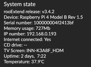

Seems your rooExtend got a new IP address in your new network. Please change the IP in the default rooExtend radio station to the new value. You find it in the settings of the License Manager at the end of the dialog:
Best DrCWO

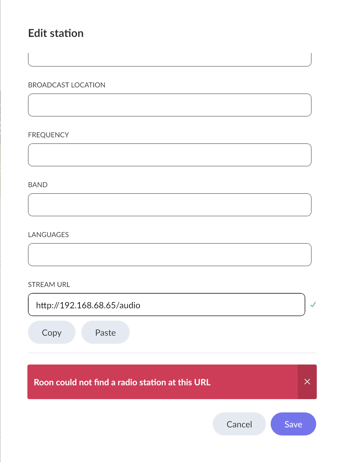

Thank you. I have found the new IP address and tried to change the value in the RooExtend radio station but Roon ‘could not find a radio station at this URL’ and wont permit me to change the IP address?
Just checked and i cant connect to the Rooextend via the IP address so presumably that is why Roon cant connect. Will keep trying.

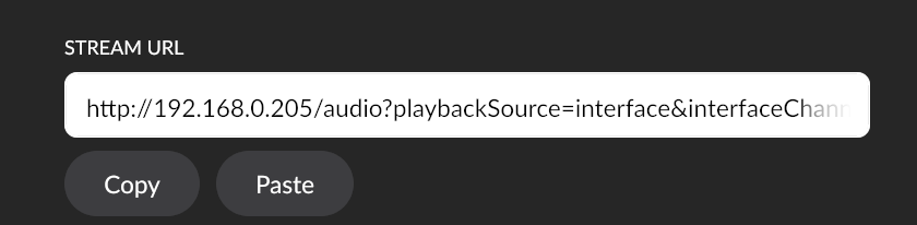

Please take a look at the rooExtend-Box manual i my download area.
In there is a description on how to set up a dedicated radio station for the audio interface. Using this your Scarlet will show up as a radio station. Playing this like any other radio station will immediately start playback from the interface. There is no need to mess around with the settings dialog any more.
