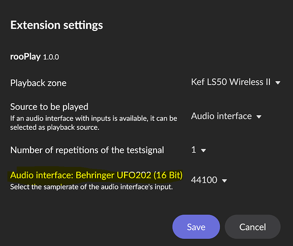

Just installed rooplay and the channel check L/R, sinus etc. are working fine.
Unfortunately there is no sound when i stream music over the Behringer UFO202, the problem however is not the Behringer. This is how i tested :
Analog source on Behringer → USB out from Behringer to iphone (via USB tot lighting cable) → on iphone used the app AirChord to stream the analog source over airplay directly to the Kef LS50W2 .
That worked fine so there is a 100% check that the signal from the (analog) source is coming out of the Behringer USB. Plugged the USB out of the iphone and into the Raspberry Pi, selected “Audio interface” in Roon but nothing happens?
Used poweradapter is 5V/3.1A
Solution : Reboot rooPlay via internal homepage of Rooplay
