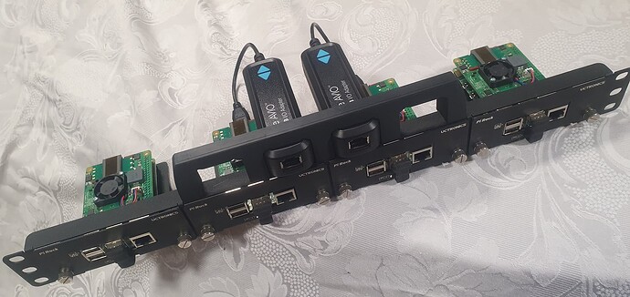

I have 4 x Pi running ropieee directly into 4 audinate AVIO usb adapters onto my dante network and all routing is done via my symetrix dsp playing music to 7-8 different buildings and 10-15 different zones.
Using roon web socket as the front end controller and dante as the routing service, it has been super reliable for almost 12 months now.
