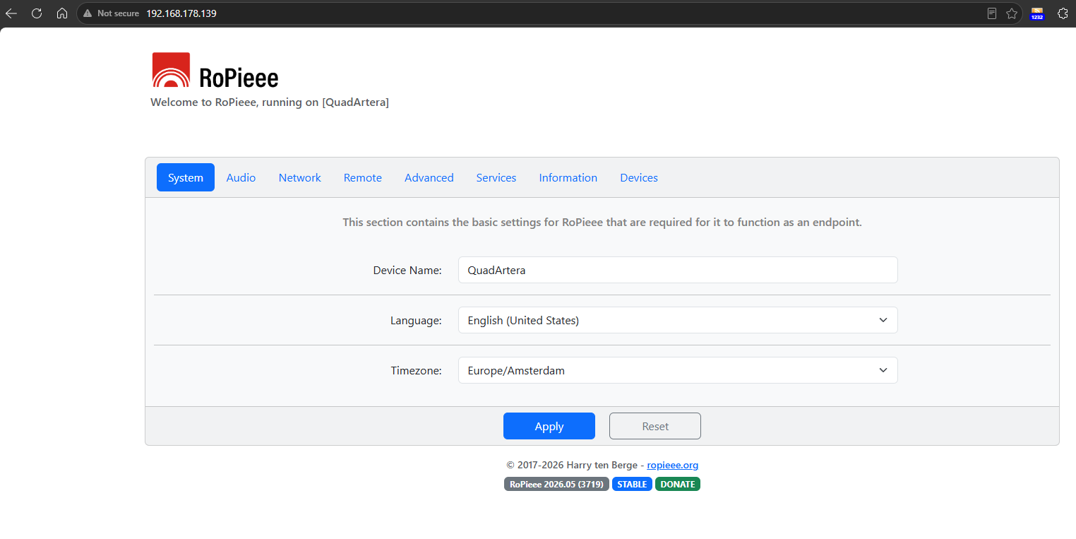

I have two RPi4s running Ropieee (currently 2026.05 (3719) ). One is on 24/7 (used for a Zone display/clock) and has no problems.
The other RPi4 is used as a Roon Bridge with a USB connection to my Quad Atera pre-amp. This RPi4 (and the Quad system) is turned off every night between midnight and 8am.

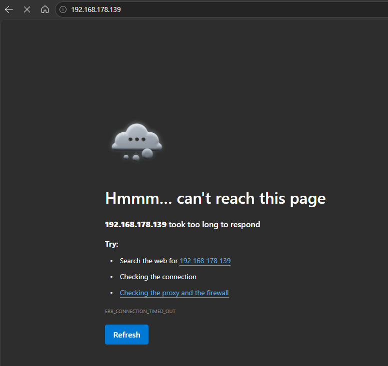

It has been working well for years, but in the last week, I noticed that the Quad Zone had disappeared from Roon - it turned out that Ropieee had apparently crashed.
Reapplying power would boot up Ropieee, but it seems to crash again after a time. This may be a hardware issue, but I’ve sent feedback just in case that shows anything. The feedback was generated shortly after a reboot - should I take another feedback after a few hours (if the RPi4 stays up that long)?

This is still happening - The RPi4 endpoint just disappears from Roon and the network at some point during the day…
Removing and reapplying the power and it reboots…

I noticed that yesterday, when I checked the endpoint, it had crashed, but I don’t know when that had happened - it could have been that it did not boot up at 8am?
