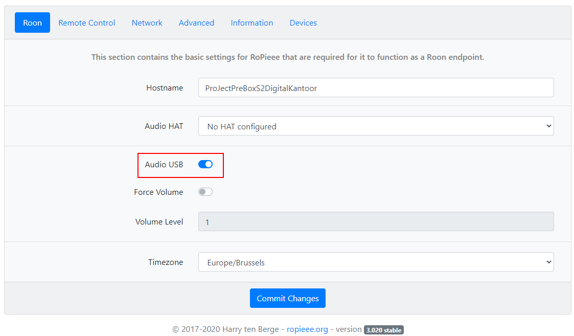

Shouldn’t Audio USB be turned on?
No this is a HAT with coax/spdif out.
