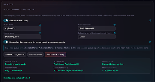

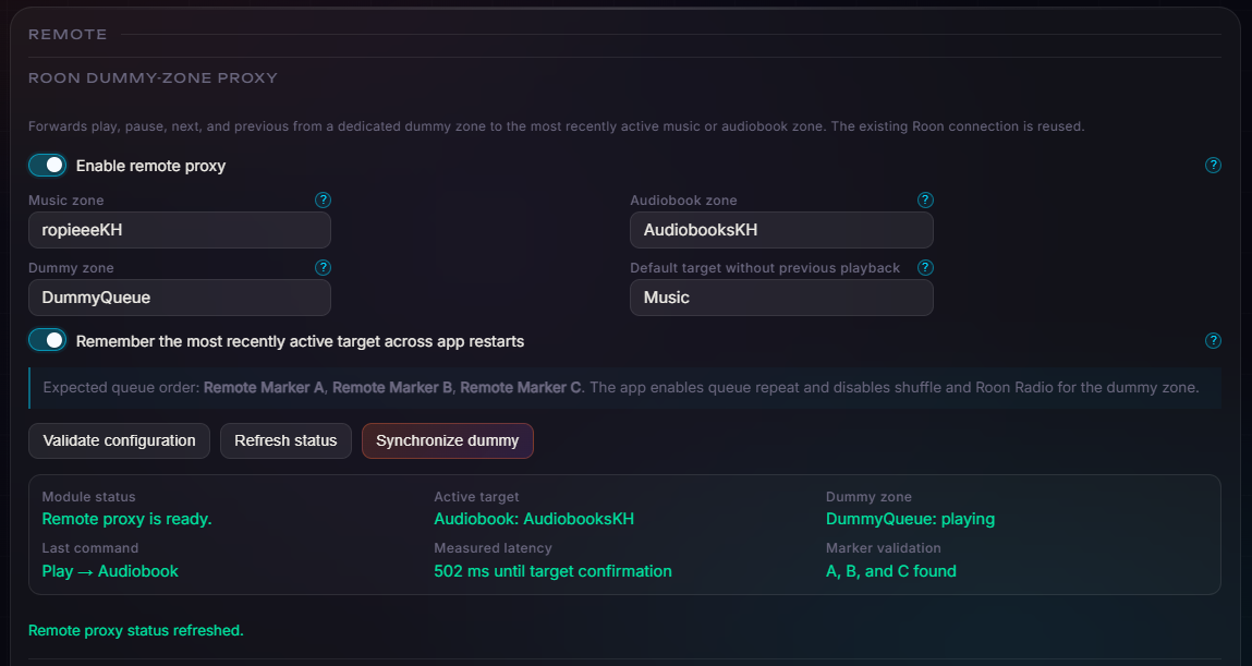

I’ve created a workaround using my app. I can now control both Roon audio zones remotely via RoPieee from both services and with both pairs of headphones.
