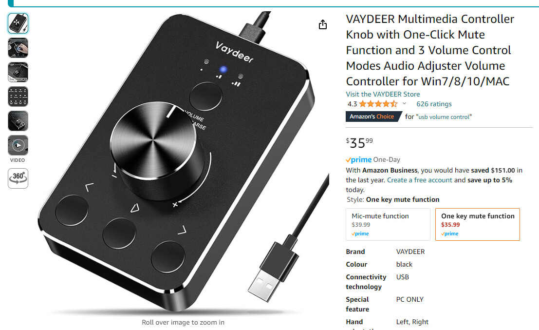

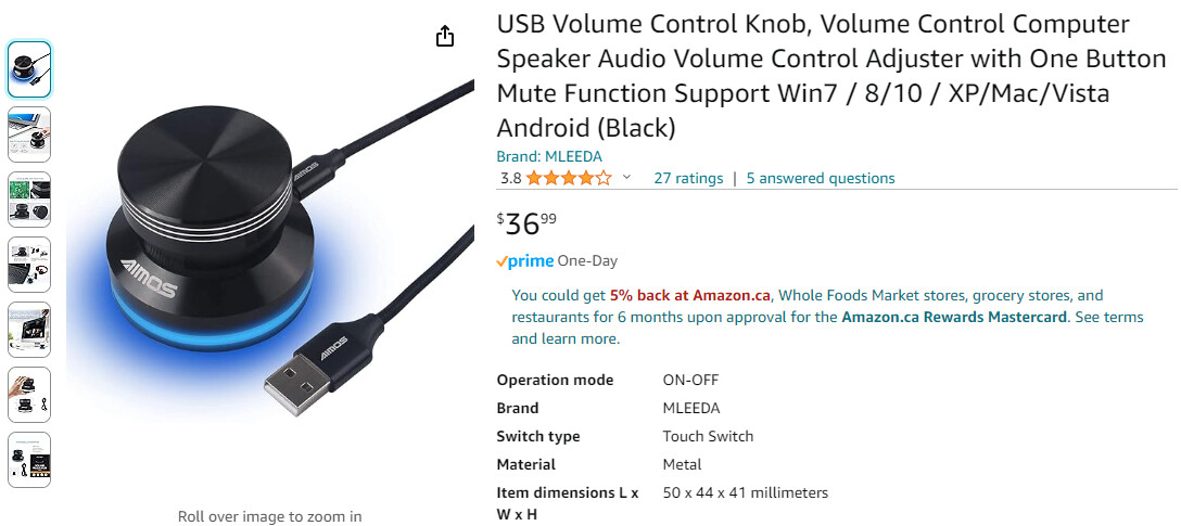

@spockfish I ordered a couple inexpensive volume knobs and did some testing – largely with success!
Here are screenshots of the ones I tried (note: Canadian site, so prices in CAD):
I plugged them into my Ropiee setup (one is a Pico W2 that I had previously used as a Flirc receiver; the other is a Pi 4 with a touch display and OSMC dongle/remote set up). Both successfully changed the volume of the indicated zone (even though the Pico W2 said “none” as the remote detected, and the Pi 4 also had the OSMC remote dongle plugged in – which continued to work).
The only glitch was related to the “mute” function of one of the controllers. The one that is only a knob will mute if you push on it. This would sometimes cause the Pi to no longer respond to the volume control, and though it would start playing from pause it wouldn’t pause.

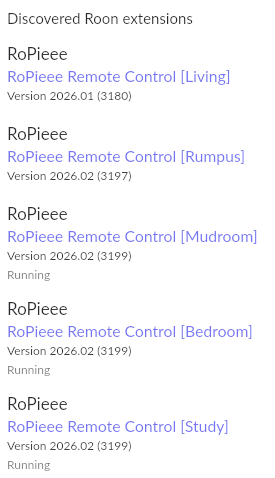

Have you enabled the Ropieee extension for the relevant endpoint in Roon?
I have the extension enabled for my Roon Core; do I need to enable the extension for each individual endpoint? I’m not seeing a way to do it in the settings.
I’m trying to use the knob connected to a Pi/PiTouch to control a different zone (a Mytek Brooklyn Bridge). When I open up the device setup in the Audio tab, I don’t see anything options relating to extensions. Are you using the knobs to control audio devices connected to the Pi running Ropieee, or other audio devices in your network?
So under Roon - Settings - Extensions you should see each Ropieee endpoint there and you can enable them where desired (like below)
