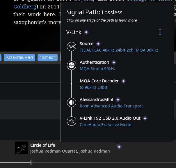

Additionally, can you share screenshots of the signal path? Ideally, you can share screenshots of the signal path before the track changes to a different sample rate, and then a screenshot for the following track after the 3 ticks have occurred.
Hi Dylan,sure, here are the screenshots for the set up:
And these are the signal paths :

I see in the first screenshot that you’re playing MQA content — Does this only occur when MQA content is involved?
HI Dylan,
this is happening for any change of resolution, regardless of MQA
