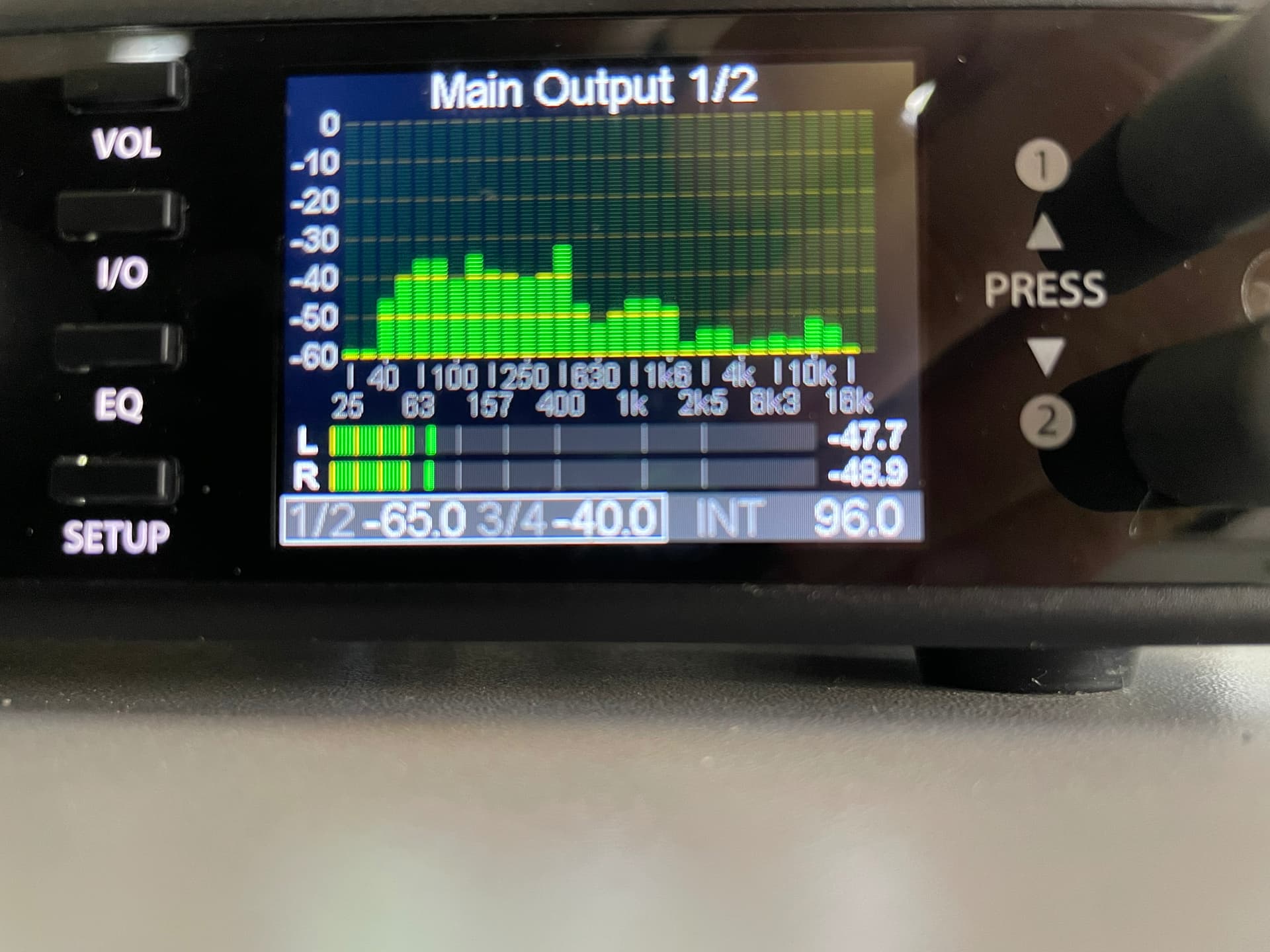

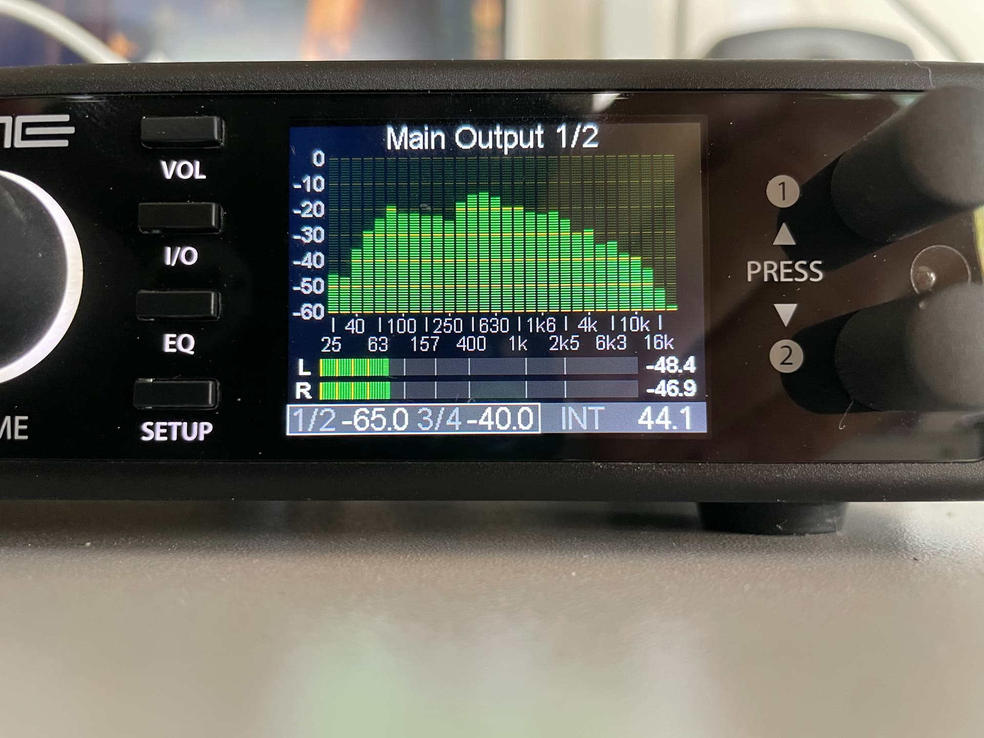

I did test it now with an RME DAC, so I can see the bitrate arriving on the DAC.

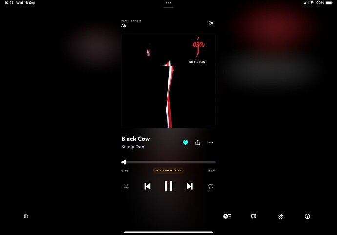

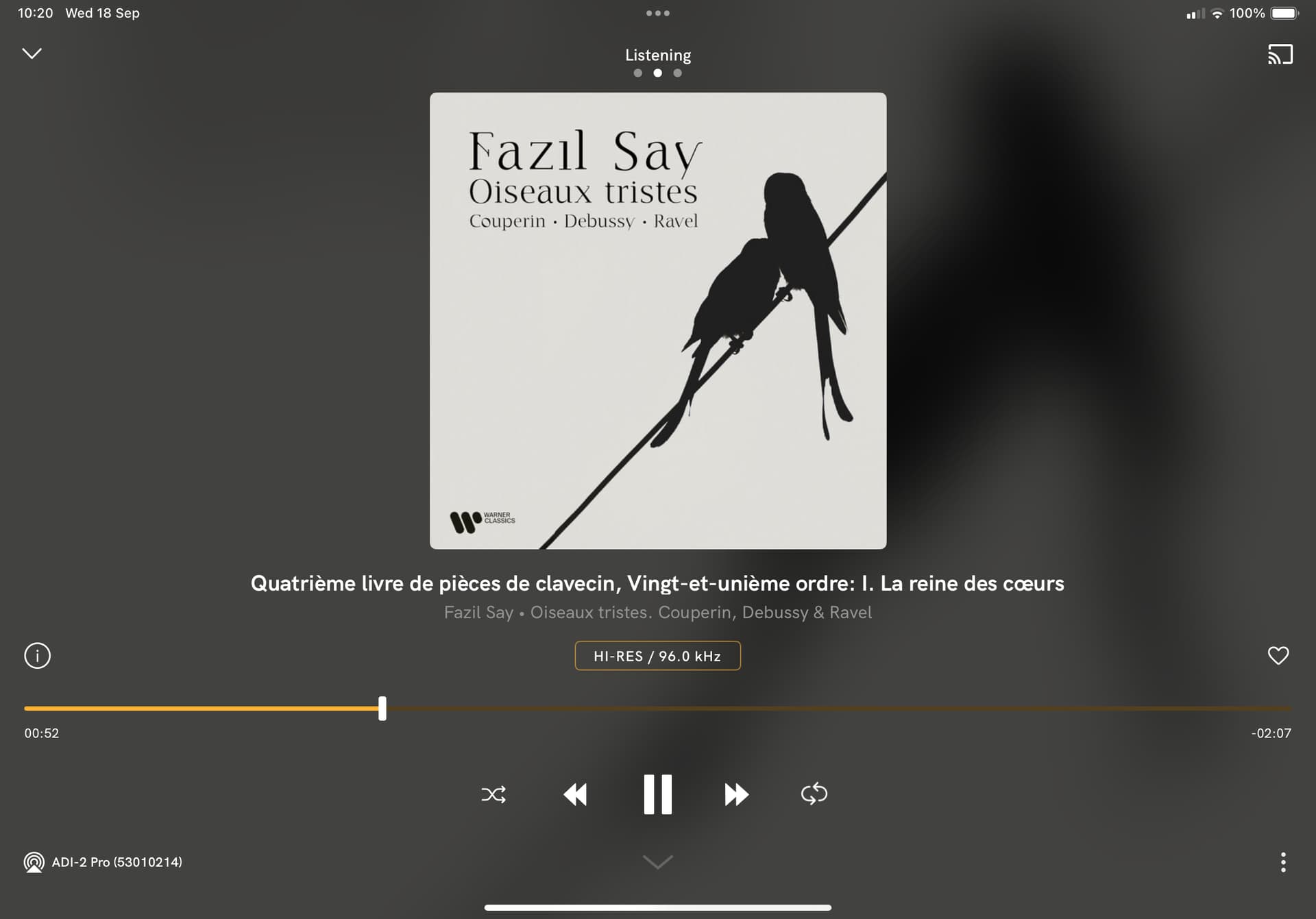

The downsampling only happens in Roon. Playing HiRes with Qobuz and Tidal [applications] the bit rate on the DAC is the original one.
Roon:
Qobuz:
Tidal:
