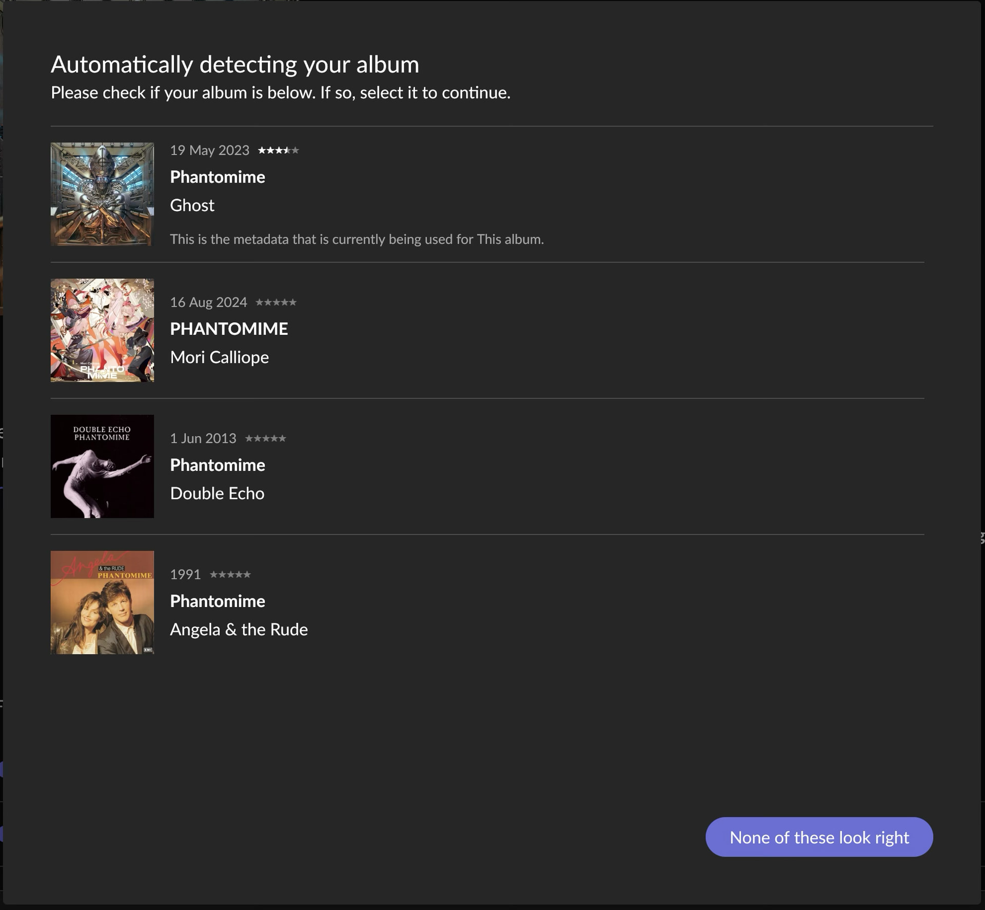

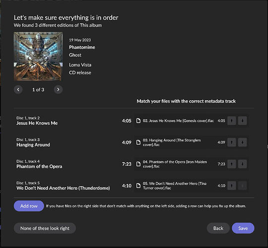

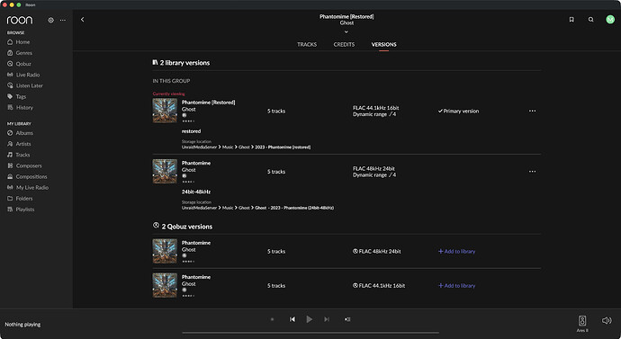

Here are the pics. My server is fine as well as the attached external drive. My Roon server runs on a 7.3.x Unraid machine in a Docker image, which could explain how the drive is seen. I also had been fiddling around trying to get SFTP working between it and my Mac, so there was a lot of shutdown and array stopping and starting going on.

The ones you posted are for Phantomime rather than Seven Inches of Satanic Panic. No problem at all, and there’s a silver lining, because Phantomime is actually grouped correctly on our end, so it gave us a clean example of what “working” looks like.
When you have a minute, could you run Edit → Identify Album on the copy of Seven Inches of Satanic Panic that’s named exactly that, with no “[Restored]” and no vinyl-rip suffix in the title? You have several copies of that 7" in your library, and that particular one is the odd one out. A shot of its Versions list would help too.
