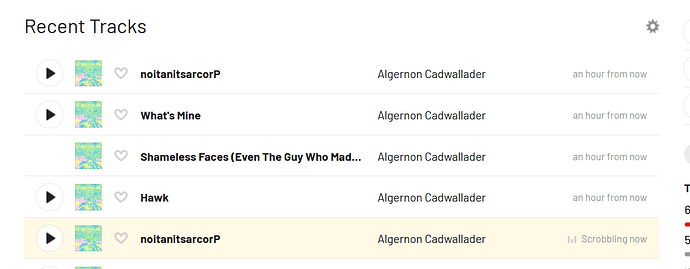

This is what it looks like when:
Streaming from Qobuz, without Last.fm Audioscrobbler in Roon.
Since Qobuz manages to scrobble ok from Sonos, on phone, etc, my guess would be that there’s something going on with how Roon plays music from Qobuz.

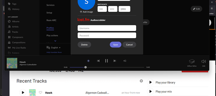

If I activate the audioscrobbler in Roon, this is the result:
So the Roon built in scrobbler has the correct times.
