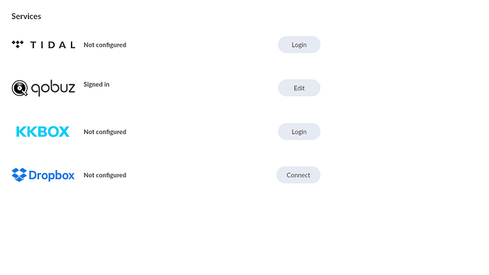

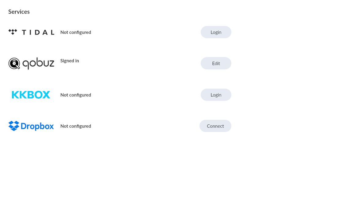

Could it be your choice to keep the service accounts without active subs causing this?
I dont have this. I have one Active Qobuz account tied to Roon nothing else, I just dont keep favourites. I have ab out 33k tracks of my own in my library.
Oddly in my logs when it was doing the trawl I can see references to Tidal why would that be? Tidal is no longer active in Roon.
I think (might be wrong) you used to keep the Tidal Service account to get “the weeks releases” etc. But not having an active sub didn’t allow streaming of anything.
If i am mixing you up with somebody else, i apologize!
And my second question is, have you “cleaned your library”?
Or might there be favorites still associated with. Tidal such as in playlists, favorites.
Not me I don’t keep inactive accounts.
I maintain my library all the time. I appreciate you trying to help, but this is up to Roon support to answer why Roons metadata updates would thrash a cpu so much to bring Roon to halt for all other of its processss. To me it feels like something’s off with this side of things. Roon barely registers at all during normal operations even using DSP convolution at 192/24 it doesn’t show any processing speed and all other aspects are lightning quick. DiskIo is optimal to as in checked using the provided OS tools. I don’t have local playlists with Tidal content and they would not be active without the account active in Roon anyway. I have now deleted my Roon cache but I really should not have to resort to these measures if an account has been removed from Roon.

@connor why is this update showing Tidal max, I dont have Tidal in Roon any more and i have not had any favourites in it for well over 18 months.
