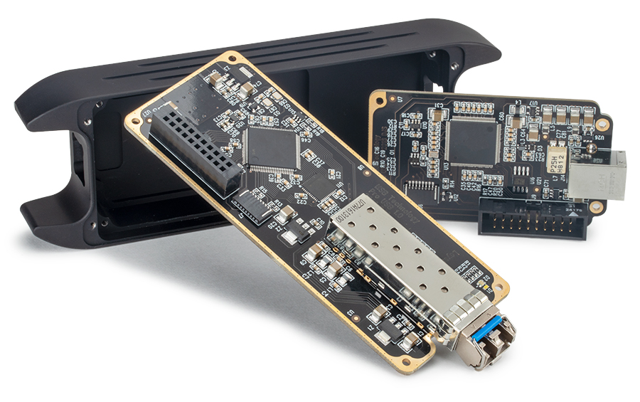

https://sonore.us/opticalRendu.html
Uptone EtherREGEN has SFP port too. Yes its an Audiophile switch as noted below.
I think there is an MSB dac that might be SFP supported too - also noted below and it needs a special USB interface on further reading.
Holy Sh!t! $50 for a 1m LC-LC OM1 fibre patch lead?!

Pro USB Adapter - MSB Technology
[Pro USB Adapter - MSB Technology
I use fiber from computer into an opticalModule and then a really short ethernet cable into USB streamer. It does give a more clear sound, but also a little thinner sound. I don’t think whatever comes before the fiber has any impact as long as it handles bit-perfect data.
The Pro USB adapter looks interesting, but way to expensive. And despite the “lets the DAC clock the signal” the sound will be improved with a good clock for the USB protocol (24Mhz).
https://www.sonore.us/opticalModule.html
