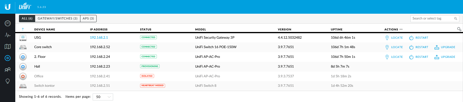

Maybe this might help anyone in the UniFi camp…personally I haven’t tried it but might just do so. Will try to update this post if I do. I’m assuming it would work for other UniFi ap’s
