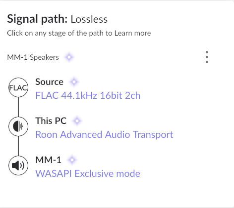

I think this means my Bowers & Wilkins MM1 via USB will only decode CD quality
Being the perfectionist I am - should I care? And If I should
Can anyone recommend a PC speaker (USB connection) better than MM1 that will decode 96Khz or higher?

With the USB protocol, the computer will actually ask the speaker what it supports. It must be replying, 16/48. This is in the B&W USB firmware. Maybe there’s a firmware update for the speakers? But I don’t see anything in their literature which says 96kHz.
I also own B&W MM1 speakers. When I raised this exact issue with B&W support, a few years ago, they confirmed that 96/24 was not possible using the internal DAC. However, it is possible if you use an external DAC (I have used a Meridian Explorer) and connect it to the analogue input.
