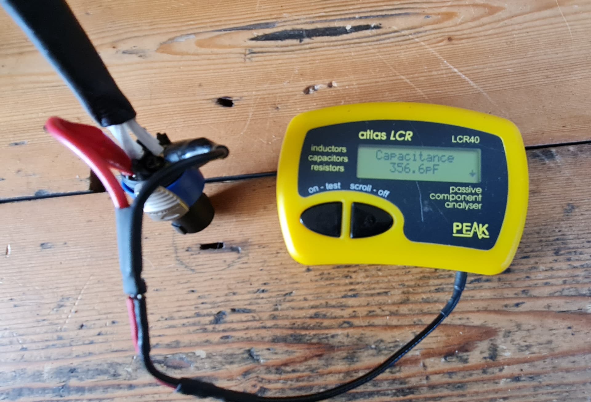

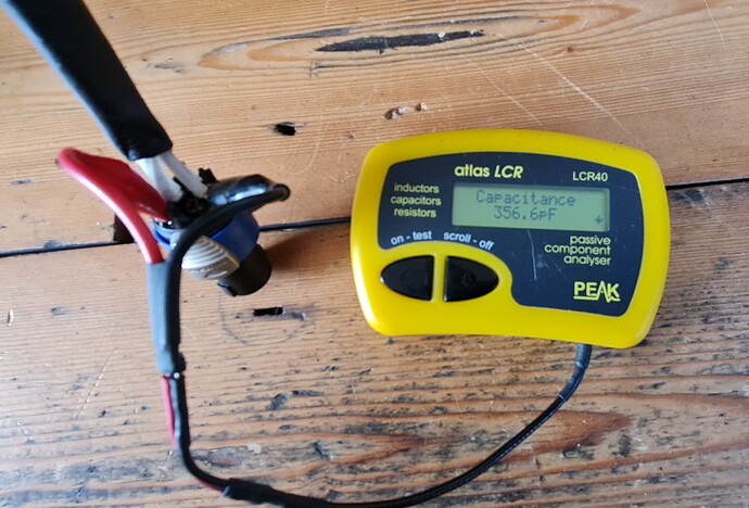

Here’s the cable connecting one of my AHB2s to it’s respective speaker and it’s a worst possible case as the cable has two runs, one to each half of the crossover, i.e. it’s bi-wired. Not for any other reason than that I could. Let’s not get into that argument…
356.6 pF - that’s 356.6 x 10^-12 F, or 3.566 x 10^-10 F

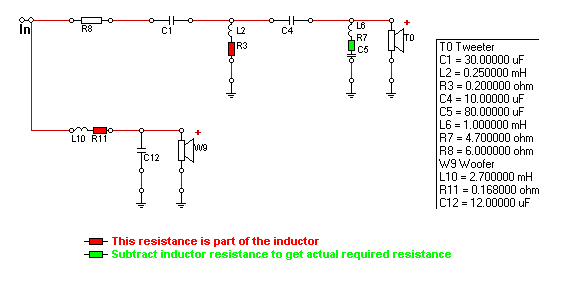

Here’s the crossover for the speaker:
ZRT-2way-crossover
Let’s ignore the capacitors in the tweeter circuit and focus on the woofer bypass cap, C12, which is 12uF, because that’s in parallel with the amplifier’s outputs.
So we have 356.6 pF in parallel with 12 uF. Capacitance is arithmetically additive in parallel, so we have a total capacitance of 12.0003566 uF, or an increase of 0.0029717 %.
The air-gapped cable above would achieve a 2.5 times reduction in capacitance due to it’s air dielectric. My cables are polyethylene insulated which has a dielectric constant of 2.5 relative to air and there would be a further reduction becuase of the increased spacing of the conductors. Capacitance drops as you separate the conductors. That’s why capacitors have a very thin film of insulator between them. So all in, you might get down to maybe 30 pF.
In terms of effect on the woofer output at the crossover frequency, it’s 0.000129dB - that’s assuming they get down to zero capacitance, which they won’t, but play along, I’m giving them every advantage I can. At the very, very best, humans can detect a 0.2 - 0.3 dB difference in sound between two sources. This is 1550 times lower than the threshold of perceptible difference.
In short, no one can hear the difference.

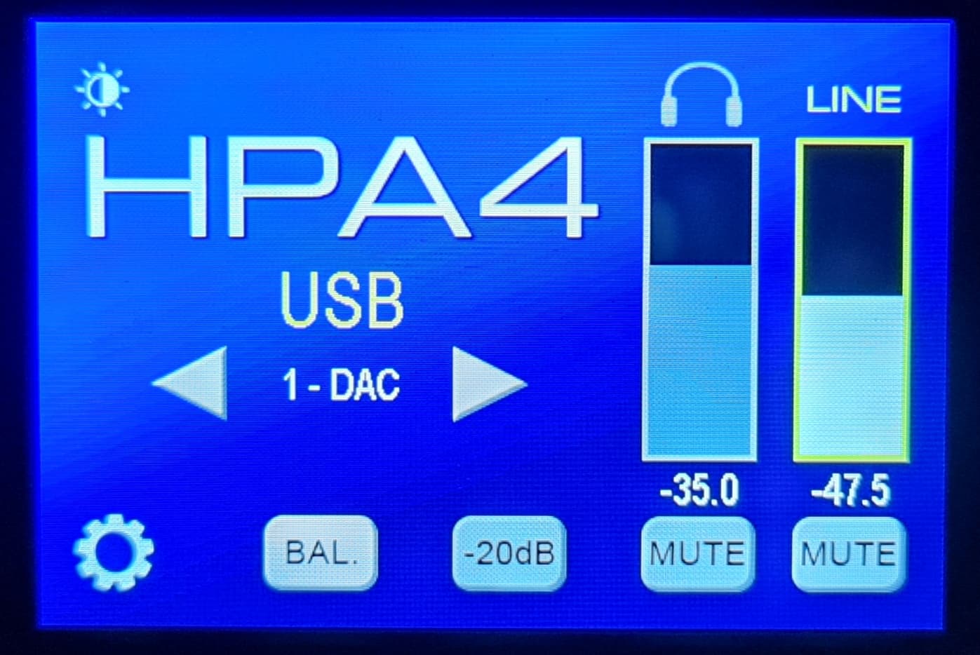

I haven’t used the HPA4 with any other DACs. The DAC3 is superb. Textbook performance and it integrates with the HPA4 (and presumably the LA4) with the remote. HPA4 shows the DAC3 input selection when you use the remote:
