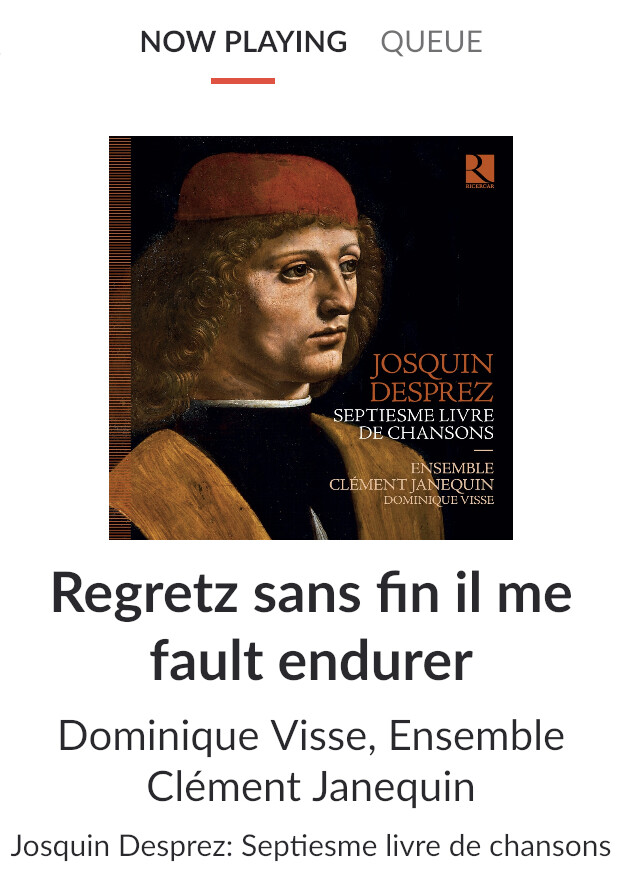

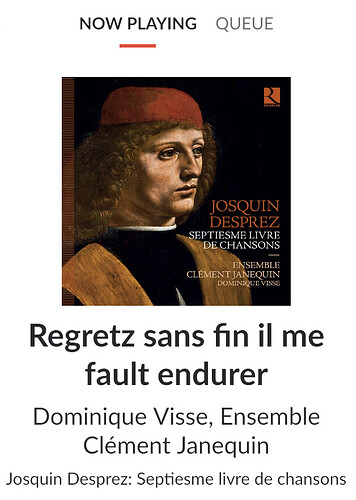

In general I must say I could have posted the same as the OP:-)
The more revealing systems reveal subtle lip movements and definitely accentuate the ending “ssss”s.
A cappella vocals are very much prone to this. An example:
And I thougt I‘d love the Wellermen :rofl: :rofl:
Thanks @DrPo, great music, excellent recording!
I really love it….
And it also sounds great on my stereo,
But, no issues with sibilance or heights of the vocals on my stereo.
