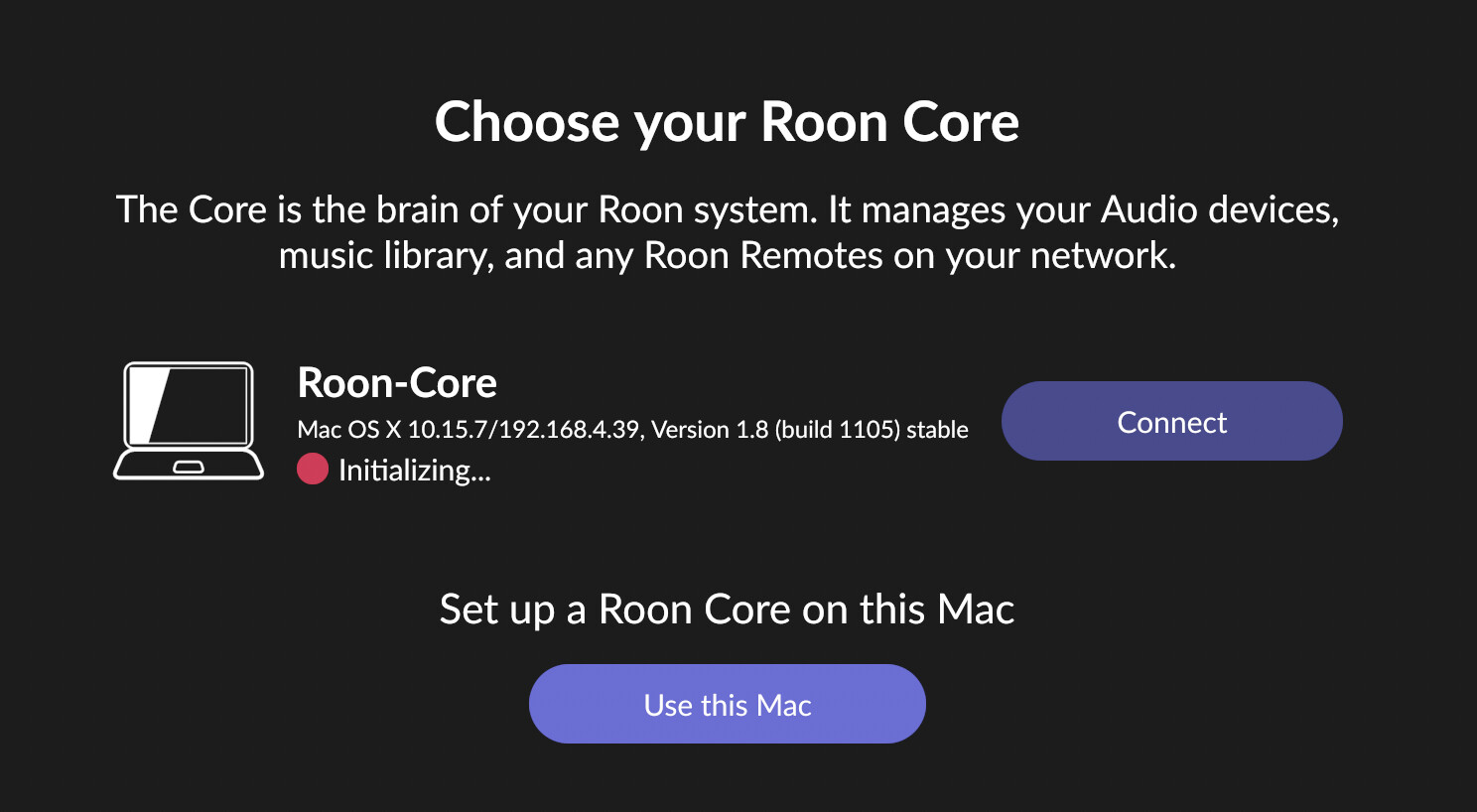

Since build 1105, can't connect to core, errors loading saved pages. No other changes to system
Roon Core Machine
Mac Mini 2012 Catalina 10.15.7
2.6 quad core i7
xfinity modem
Eero wifi network, but core and bridge machines hard wired ethernet
Ethernet for all streaming devices. (mostly all Pi’s running RoPieeeXL.)
Remotes (phone, laptop) on wifi.
Number of Tracks in Library
60,000
I know I should wait to update, but i just impulsively clicked. Grrrrrrrr.
Roon pages just flash. They render for a few seconds, then they go black, and then I get the “can’t connect” and “looking for your core” messages. A few “errors loading saved page” messages. And the cycle continues.
Been running flawlessly for months before this.
Tried restarting roonserver, Mac mini that houses the core, Xfinity modem, Eero wifi router, switch, etc…
Nada.
Tried to disconnect and reconnect, and it’s stuck on “initializing”
Screen Shot 2022-09-08 at 1.33.25 PM
ok after an hour of restarting the app, and rebooting devices (and pulling hair out), I seem to be back in business.
Why?
(And it begs the question, would I have gotten the same result had I left it all alone?)
Thank you for listening to my Mysteries of the Rooniverse TED talk.
You are very welcome!
On my setup with a ROCK roon core the update went totally smooth without any problems.
As we see here everybody’s milage does vary
just tried to log on and it’s doing it again. :roll_eyes:
for what it’s worth, i reboot the core every night.
EDIT…
Ok, I found a major symptom… I have two laptops next to each other, both on wifi.
If only one has roon open as a remote, no problem, But if I open it on the second laptop, the first one crashes, and the second one just loops.
If I close roon on one, the other is just fine,
I remember this happening in another build.
Fix for now is to only have one instance open at a time, but hopefully this can be resolved.
