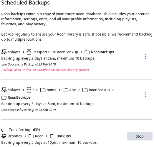

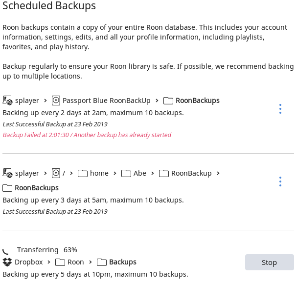

If this issue is still the same, can you please share a screenshot of your Roon Settings -> Backup tab? You can use these instructions to upload screenshots.

I upgraded. De-authorized Dropbox. Then re-authorized it. Forced a new back up to start.
The screenshot shows 63% has transferred after about 15 hours!
The other two backups are local. One of them was interrupted by this [long] ongoing Dropbox backup. In other words, things haven’t changed.
