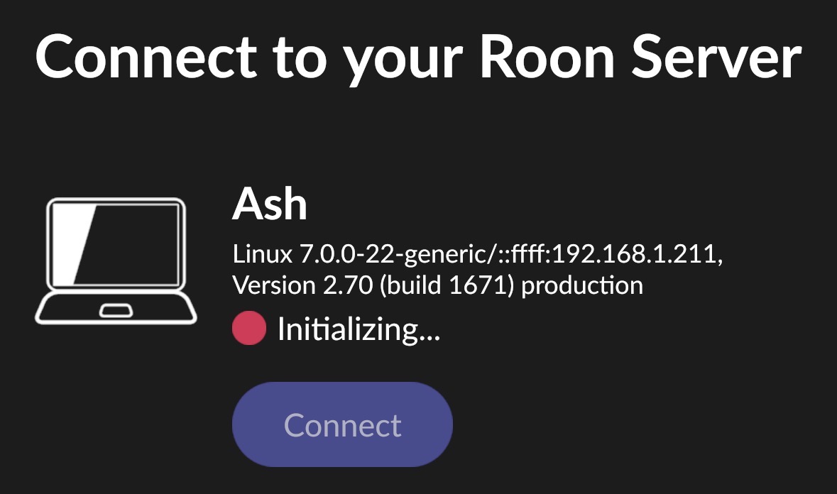

· Roon remotes (iOS, Mac) will take upwards of 30 seconds to make initial connection.

The issue seems to get worse the longer the server runs. Restarting the server can make connections fast for a short time, but within minutes to hours the issue returns. Everything seems normally responsive once it’s connected, it’s primarily the initial connection time that is slow.
