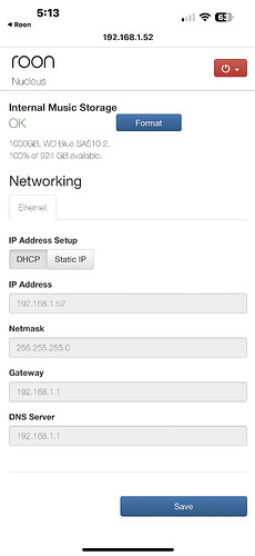

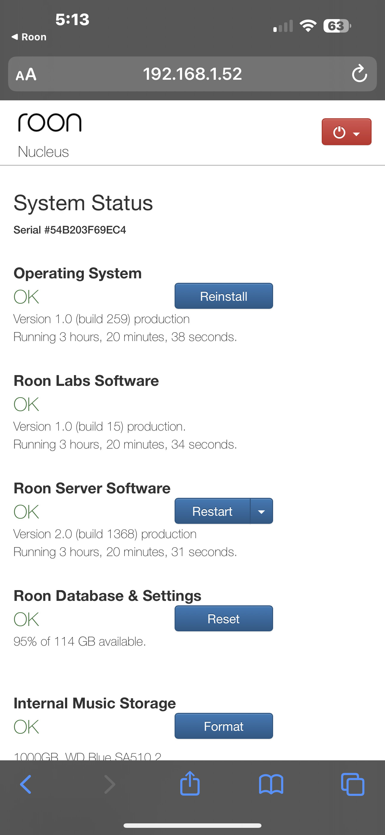

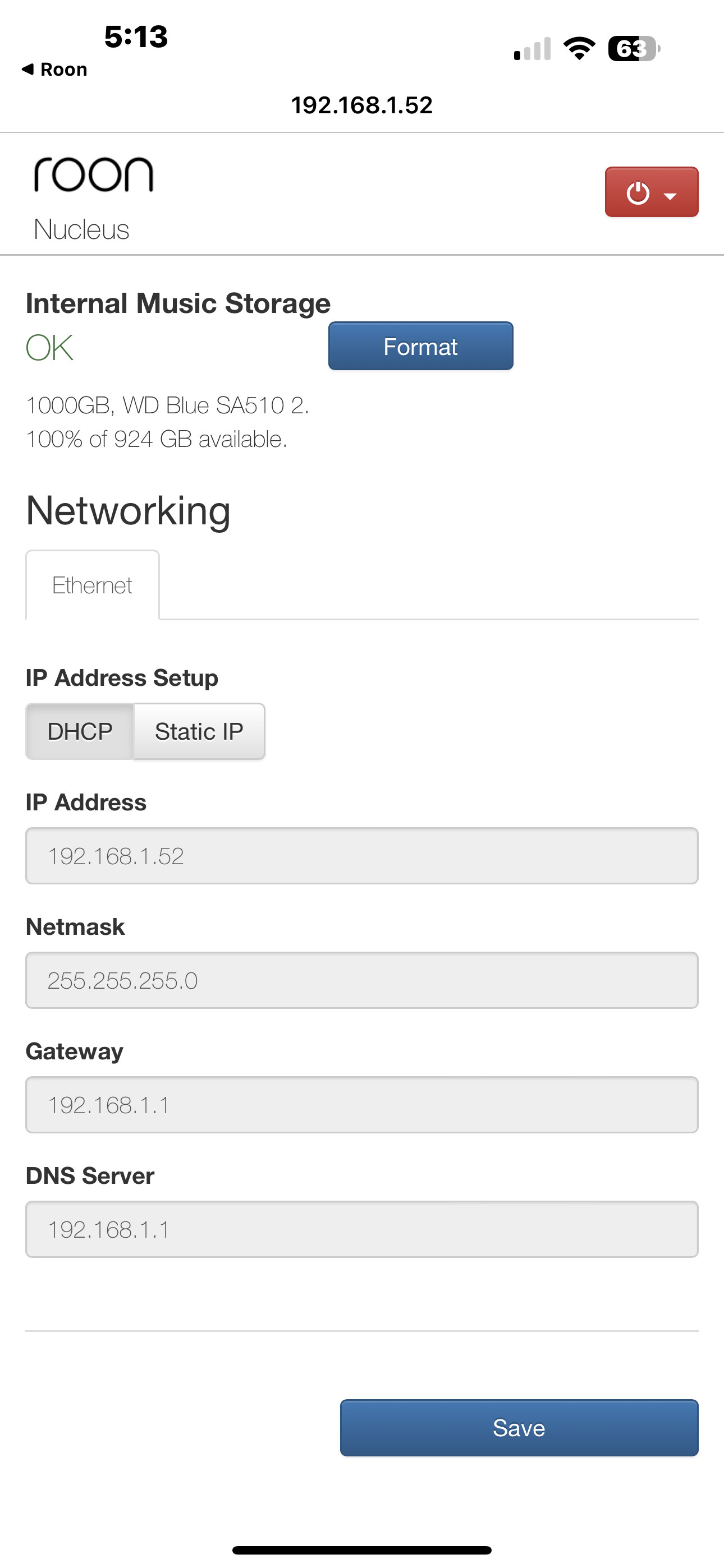

Hi @Michael_Lockwood,
If you access the webUI of your Nuclues, it should show you the proper RAM amounts, are you able to share a screenshot of what you’re seeing?
Here are 2 screen shots.
Thank you for the quick reply.
Hey @Michael_Lockwood - my apologies here, RAM is never displayed on the webUI.
I can confirm that the RAM on your Nucleus is showing - 11.58 GiB on our end, so you should be all set. :+1:
