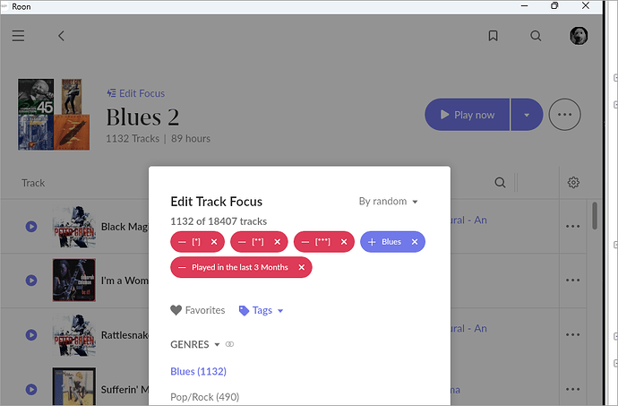

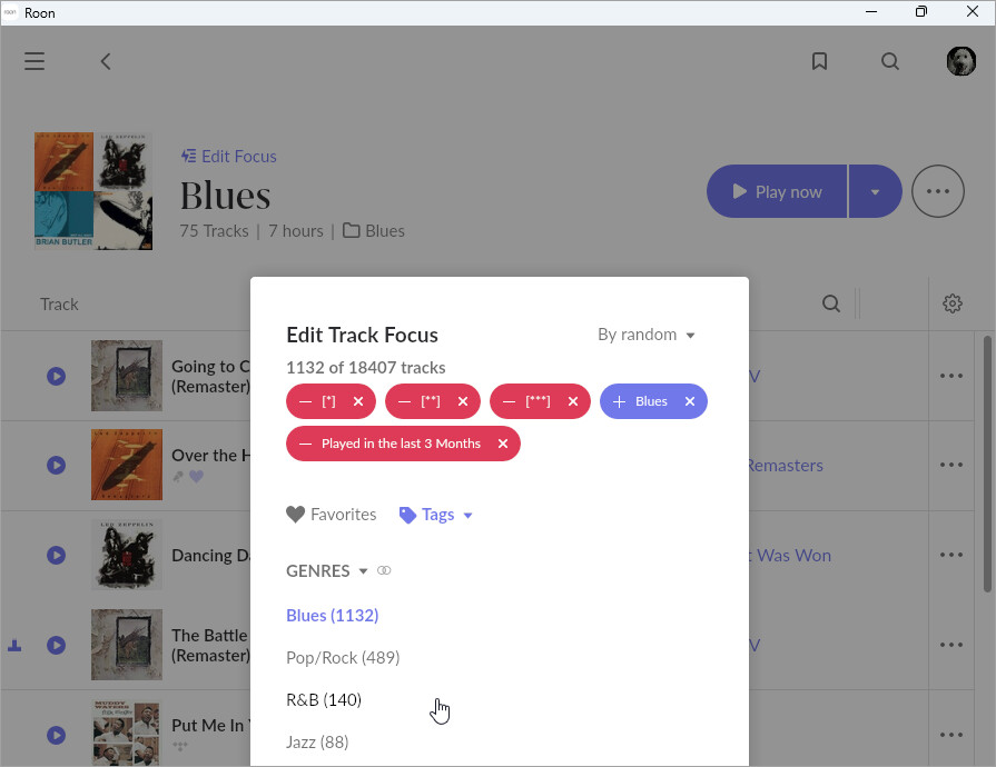

The following smart playlist was created from a bookmark. The playlist incorrectly shows 75 tracks; when I edit focus the focus dialog correctly shows 1132 tracks.
If I create the smart playlist from scratch both the playlist and focus show the correct number of tracks.

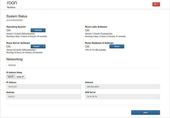

This is odd as you’ve mentioned you’re only running 18-19k tracks across your library. If possible, could you share a screenshot of the webUI of your Nucleus? This may give us some additional clues as to what might be going on. Here’s more info on how to access the webUI:

Thanks, @benjamin – really appreciate the quick reply. Here is the screen shot.

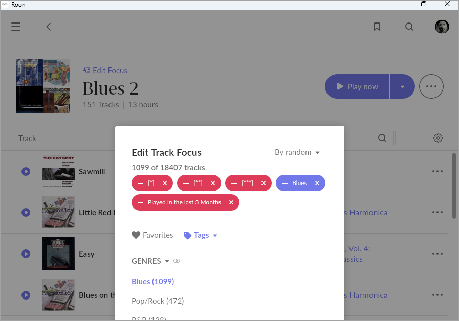

@benjamin: an update. The Blues 2 playlist that I created yesterday that did not exhibit this issue shows an incorrect track count today. As my screen shot above shows the track count was accurate yesterday. I have not altered or changed this playlist.
Hey @Doug_Wieringa,
Thanks for the update and screenshots!
It’s definitely something we’ll add as a note to your case! Based on your webUI screenshot, your database doesn’t seem wildly large, certainly not enough to trigger an OOM error. Are you seeing any crashing or poor performance overall?
