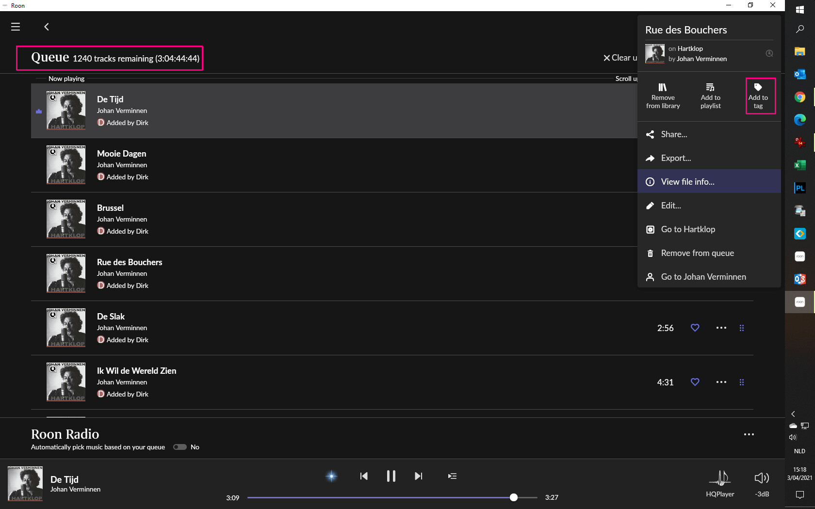

Here is a picture of a queue, containing tracks from my Library.
If I click on the 3 dots at track level, I clearly have the possibility to add the track to a Tag.
I tested a Qobuz playlist as well, and I agree that the ‘Add to Tag’ is greyed out, even for tracks in your Library

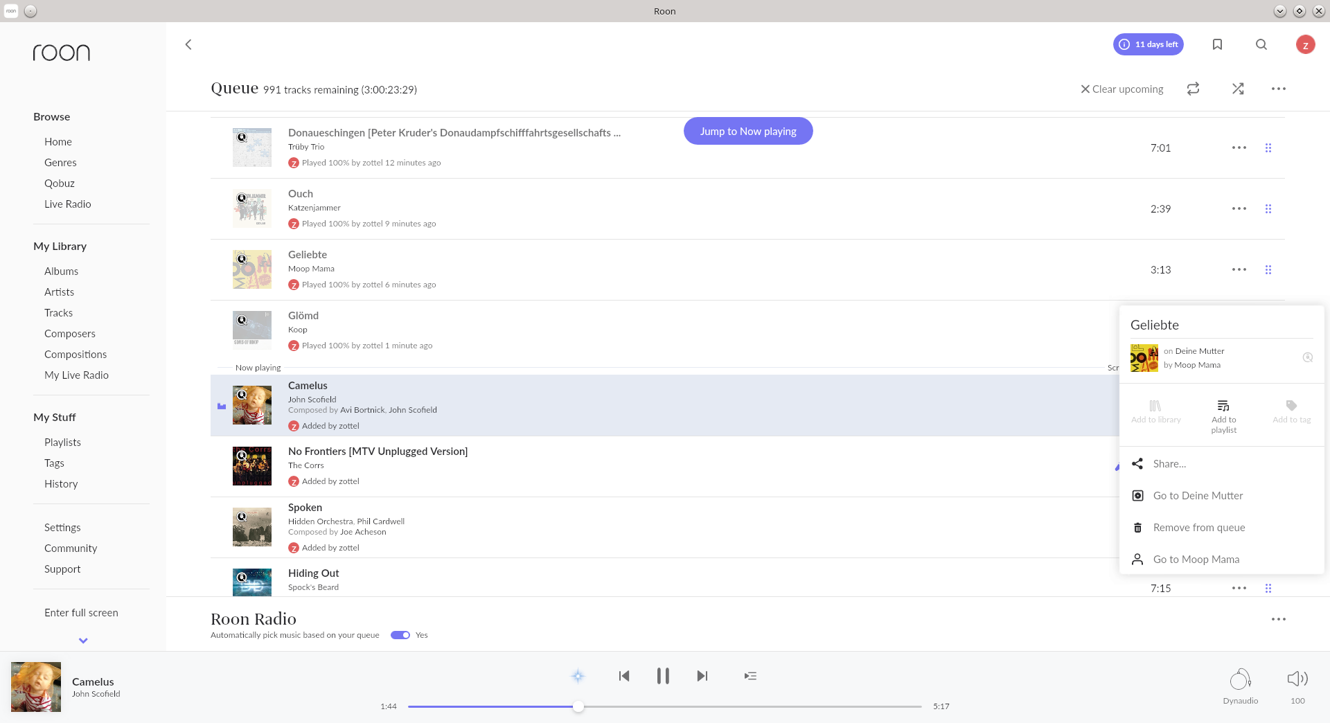

I can’t:
But that depends on what I’m playing: If I play an album from my library, it works. If I play a playlist, it doesn’t work. (At least for a playlist that contains titles that are in the library as well as titles that aren’t.)
EDIT: And, as the screenshot shows, Roon already knows that the track is in my library, because I can’t add it. That button is not greyed out for titles that are not in the library. So why can’t I add it to a tag?
