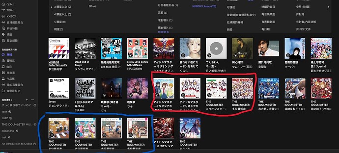

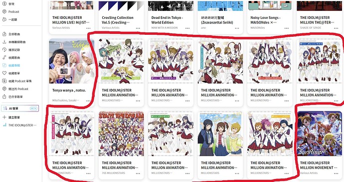

I have tried logging back into my KKBOX account, but I still noticed that two album series are missing some entries, as shown in the screenshot below.
The first one is THE IDOLM@STER MILLION ANIMATION THE@TER. On KKBOX, I have 10 albums, but only 4 appear in Roon.
The second one is THE IDOLM@STER MILLION LIVE! M@STER SPARKLE2. On KKBOX, there are 9 albums, but Roon only shows 4.
