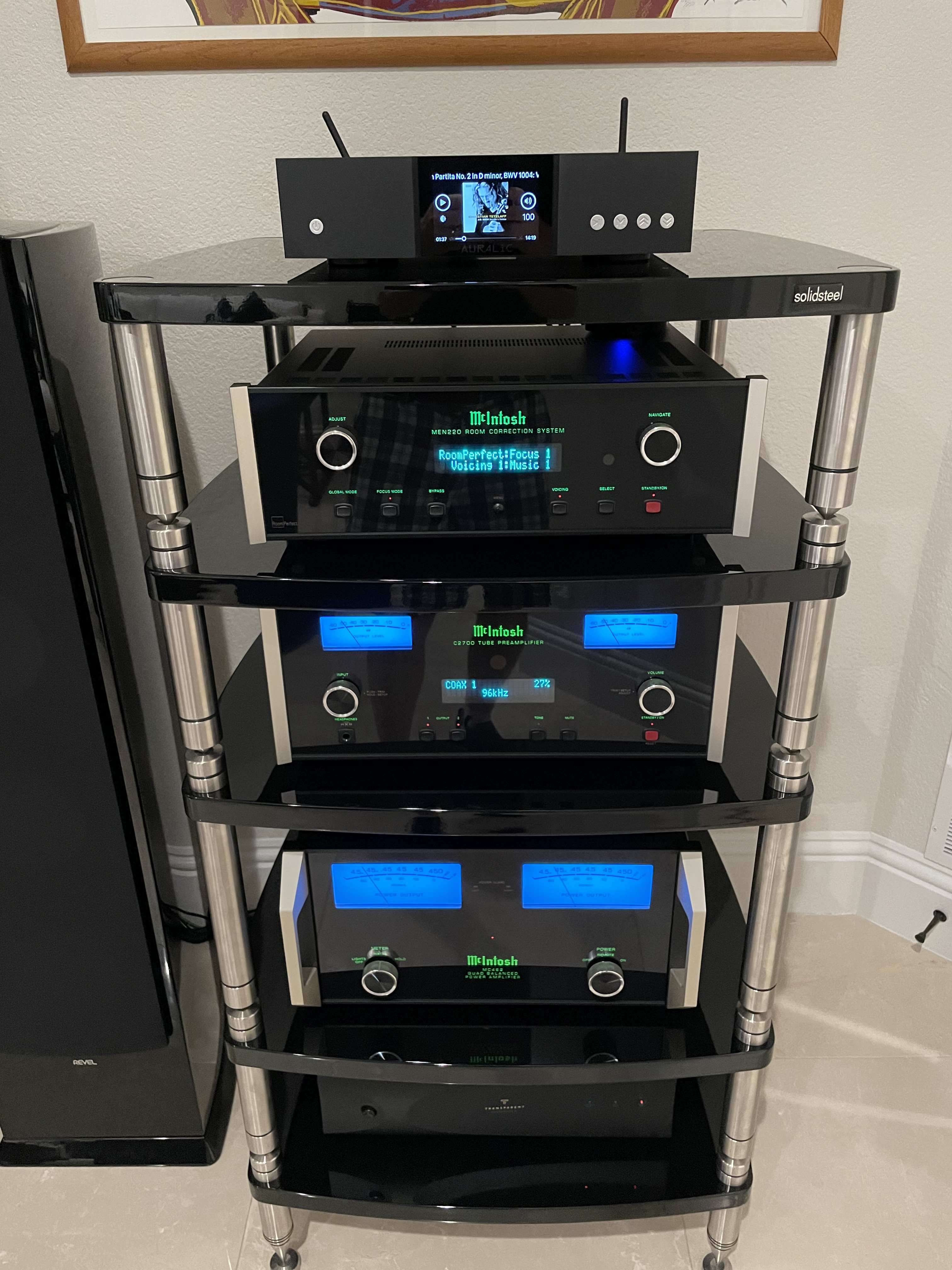

See above re: streamer - which is connected to McInotsh separates in a dedicated music room,

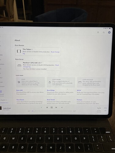

I am running the most up to date version of roon

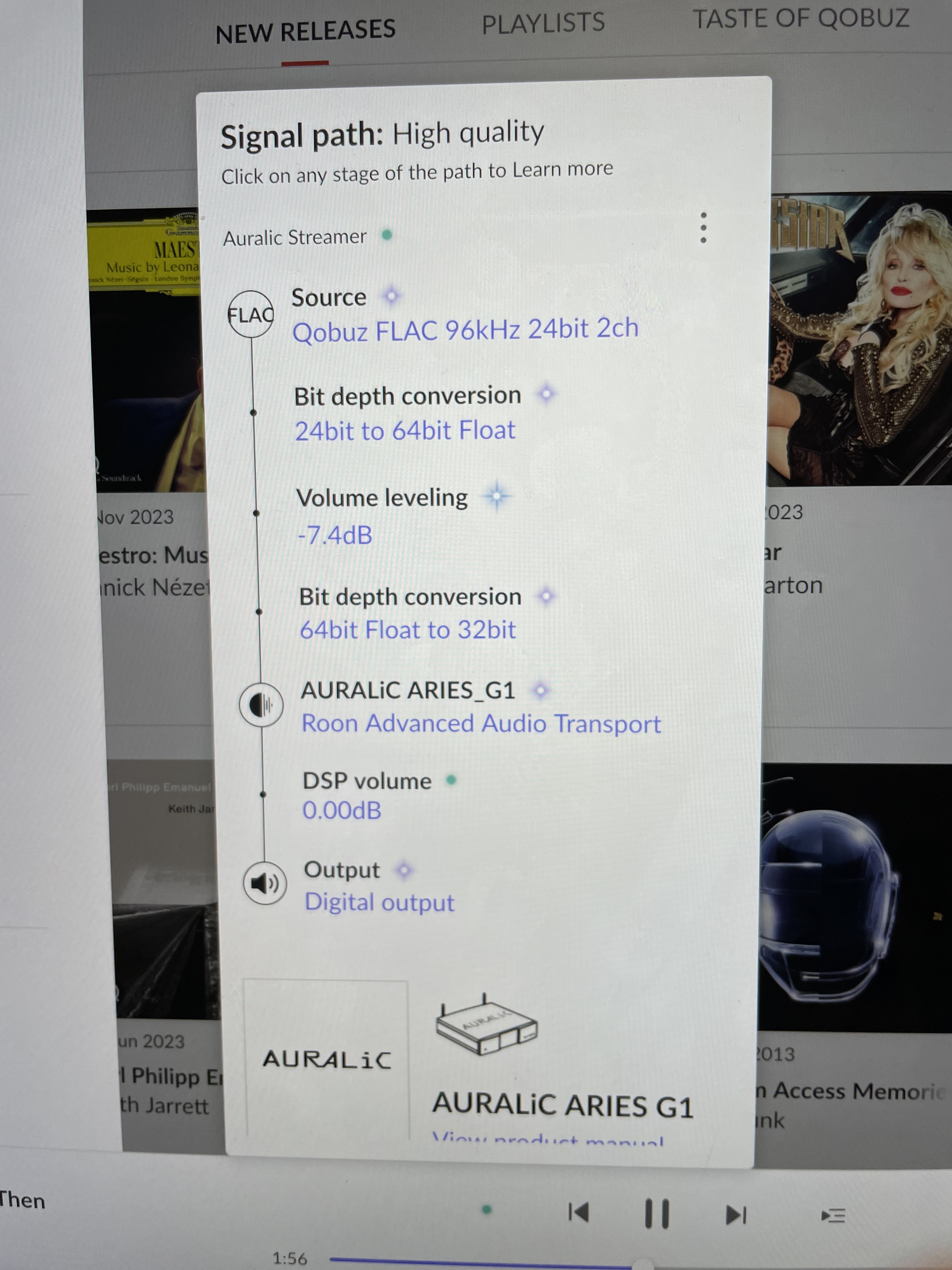

Another cause could be DSP load, if you use a lot. Please post a screenshot of your signal path.
And you probably want to remove your email address from your second picture - this is a public forum.

Good catch re: the photo (I corrected that :-))
On the DSP - i had included a photo with the signature path - unless you have something else in mind.
And thank you for the reply. I’m thinking this may be a nucleus + problem since I can play with out dropping directly through my streamer when I don’t go through roon.
Ah sorry, I missed the signal path photo. It looks fine.
