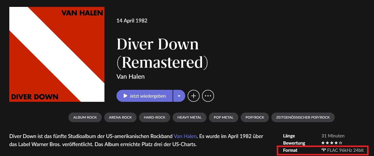

Single Play1 connected over Wi-Fi and Tidal Album (same thing with the same album stored local as flac 24/96) “Van Halen / Diver Down (Remastered)”, as Example Track 7 “Dancing in the Street (2015) Remastered” (Track 9 Little Guitars same thing at the same time):
The Track pauses at 2:24 for a few seconds and playback again.

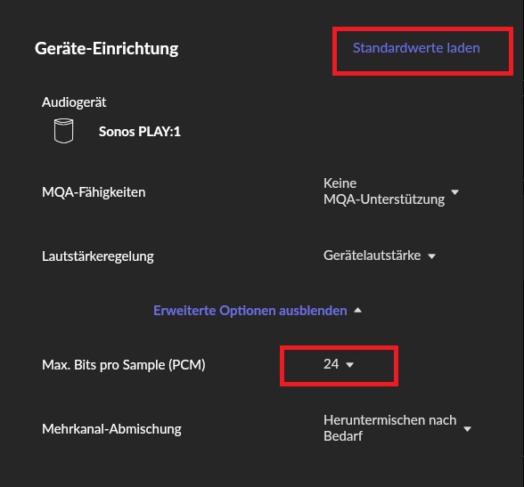

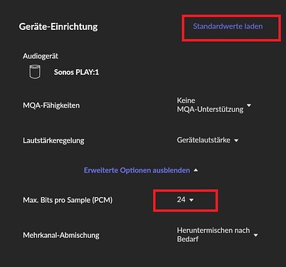

For stable multi-zone playback, I changed the Sonos Zone setting “Max Bits pro Sample (PCM)” to 16 Bit. If I changed settings to default:
same thing but little bit later approximately at 2:54 and the track pauses longer than 10. Sec.

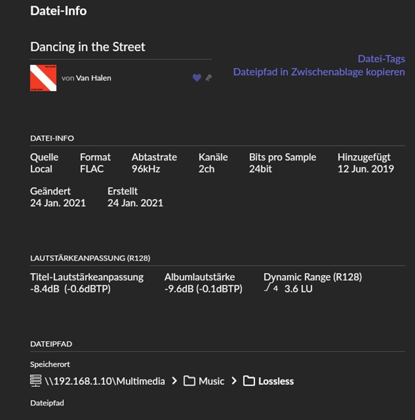

Tested again with the Track “dancing in the Street” using local file:
Sonos Play1 connected via WLAN, 1m distance to the Router (Synology RT6600ax) but if WLAN is active, Sonos Speaker connect over Sonos NET, don’t now which device are used for connection (http://192.168.1.18:1400/support/review // ??)
10:52 // music pauses 2:42

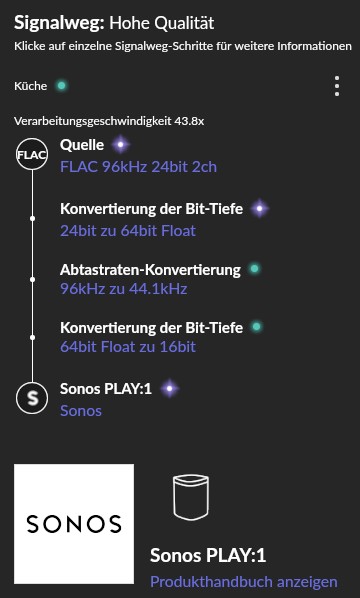

downsampled to 44.1 / 16bit:
[.NET ThreadPool Worker] [K…che] [HighQuality 43.1x, 24/96 FLAC => 16/44]
11:59 // music pauses 2:09
Flac 44.1kHz/16bit, doesn’t seem to be a problem…
