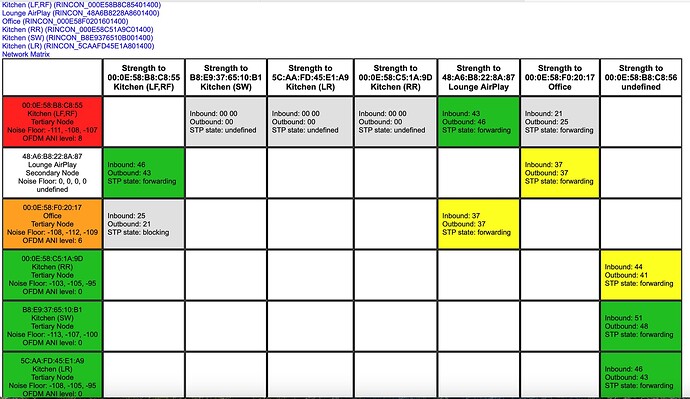

The Sonos 15.2 and 15.3 updates introduced a WiFi diagnostic tool. It might be worth entering the Sonos app to see if there is additional information regarding network health available.

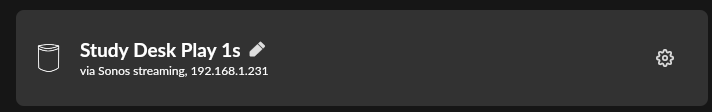

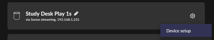

Robert in Roon navigate to Settings->Audio and click on the Setup Icon for anyone you want
Click on the Cog and choose Device Setup

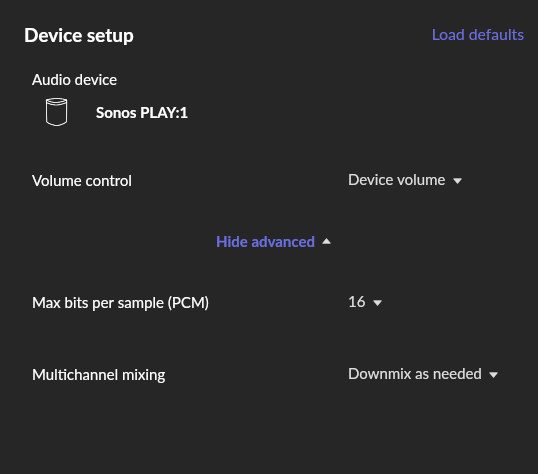

Click on Show Advanced and change Mac bits per sample to 16
Press Save and then give it a moment and play something new.

I have done this now. However, the problem still persists.

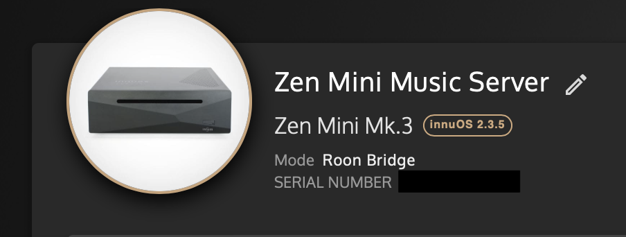

InnuOS Zen Mini (with Denafrips Ares 2 DAC): Working perfectly with Roon.

I can find any options in Sonos with regards to Network Health. I also have no error messages.

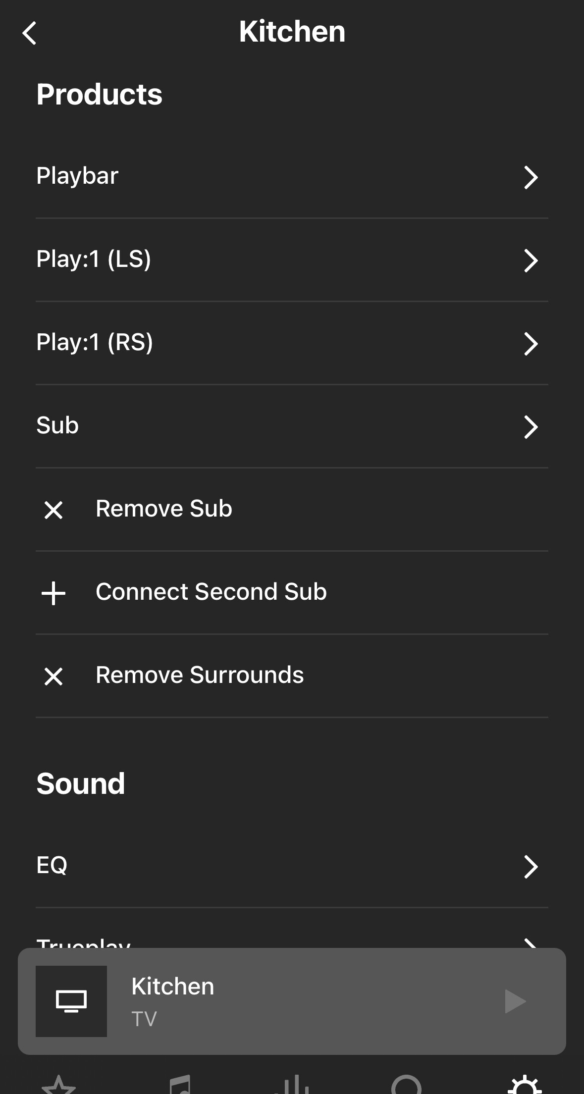

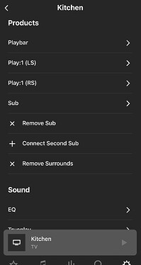

Although, if this helps, these are the Sonos speakers for this zone. There are 4 in one zone, but they aren’t grouped in Sonos as they show as one zone.

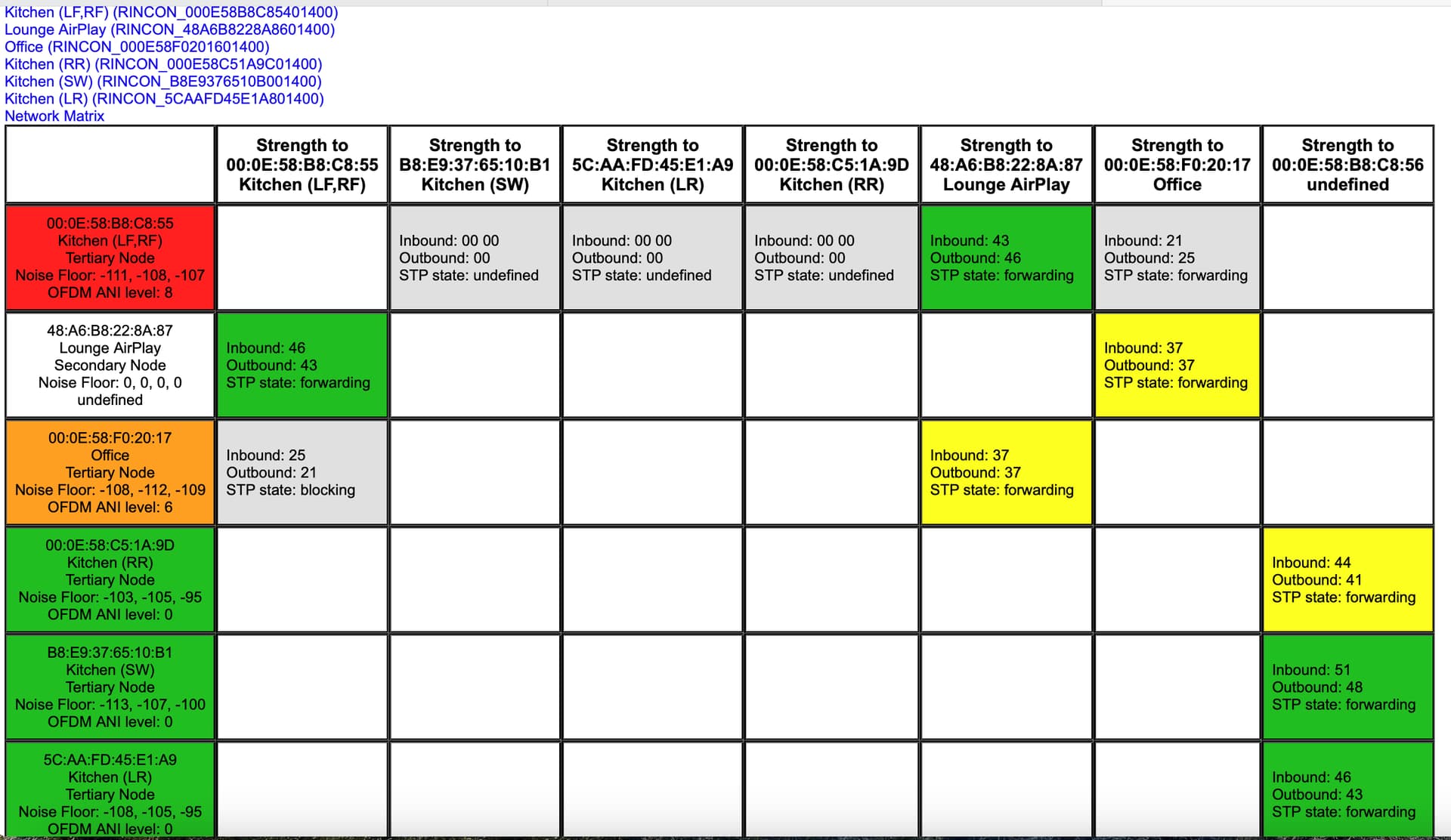

It is no longer red. It is orange.
