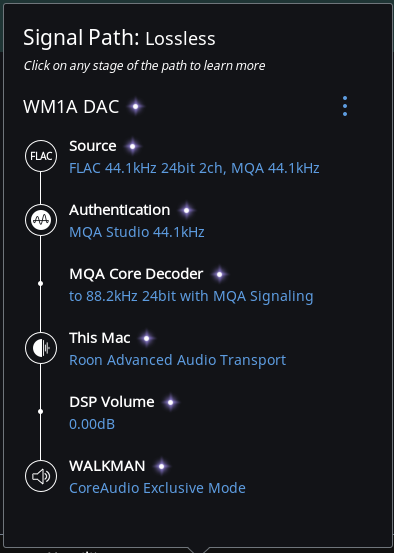

I tried multiple device MQA settings with the only album I have in MQA (I am not a Tidal subscriber)
Decoder and Renderer
WM1 displays PCM 44.1Khz
Decoder only
Renderer Only
WM1 displays PCM 88.2Khz, signal path below:
