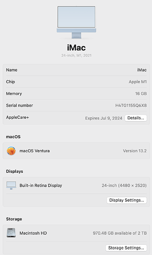

iMac as pictured in file above, Cambridge 851A, Connected to NAD 375 BEE, MacBook Air.

Roon Core on the iMac Cannot/does not recognize Sony WH-1000XM5 Phones in order to make them a zone. They “zone” fine with the MacBook Air.
@Richard_S_Wisner_Jr, these are Bluetooth headphones. Roon does not support playing to Bluetooth devices natively.
The only way to make them a “zone” with Roon is to make the headphones the default System Output device on the iMac, then play Roon to that iMac’s System Output (ensure it is “Enabled” in Roon’s Settings → Audio).
