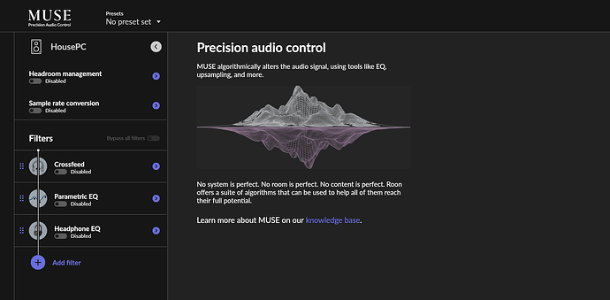

Have you enabled and then adjusted Headroom Management in Muse inside of Roon to see if it helps?

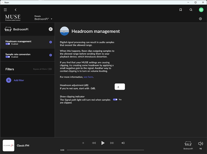

I have -3 dB headroom set in Roon to mitigate intersample overs, and allow headroom for filters. I turned up my preamp to compensate, and can’t hear a difference. It’s a pretty basic system.

In Roon, enable headroom adjustment (but with the headroom set to 0dB if you don’t want it to do anything) and then enable clipping indication:
As the text suggests, with this in place the signal quality dot will then turn red if clipping occurs.
If there is no clipping in Roon (signal quality is not red), then Roon is not causing the clipping and it must be happening in the DAC.
