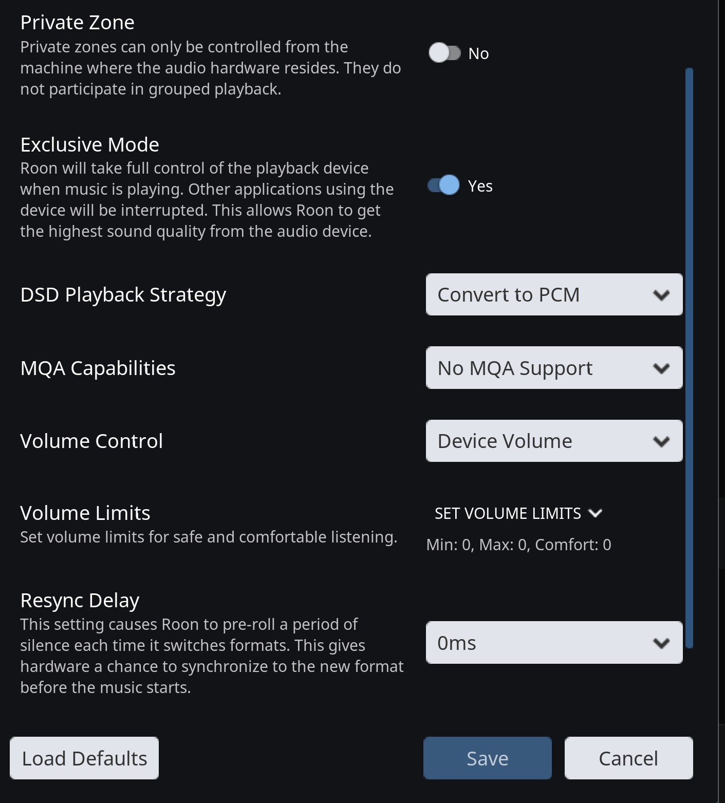

If i configure my Nuc Intel® Display Audio WASAPI to Exclusive Mode, I only get sound when playing MQA files. The following screenshots show configuration that can play MQA, but not non-MQA files on Tidal.
if i use the above settings, I get no sound from non-MQA music.

Any idea why turning on Exclusive Mode would allow sound to come from only MQA files?
If i turn off Exclusive Mode, I am able to get sound from both MQA and non-MQA files.
