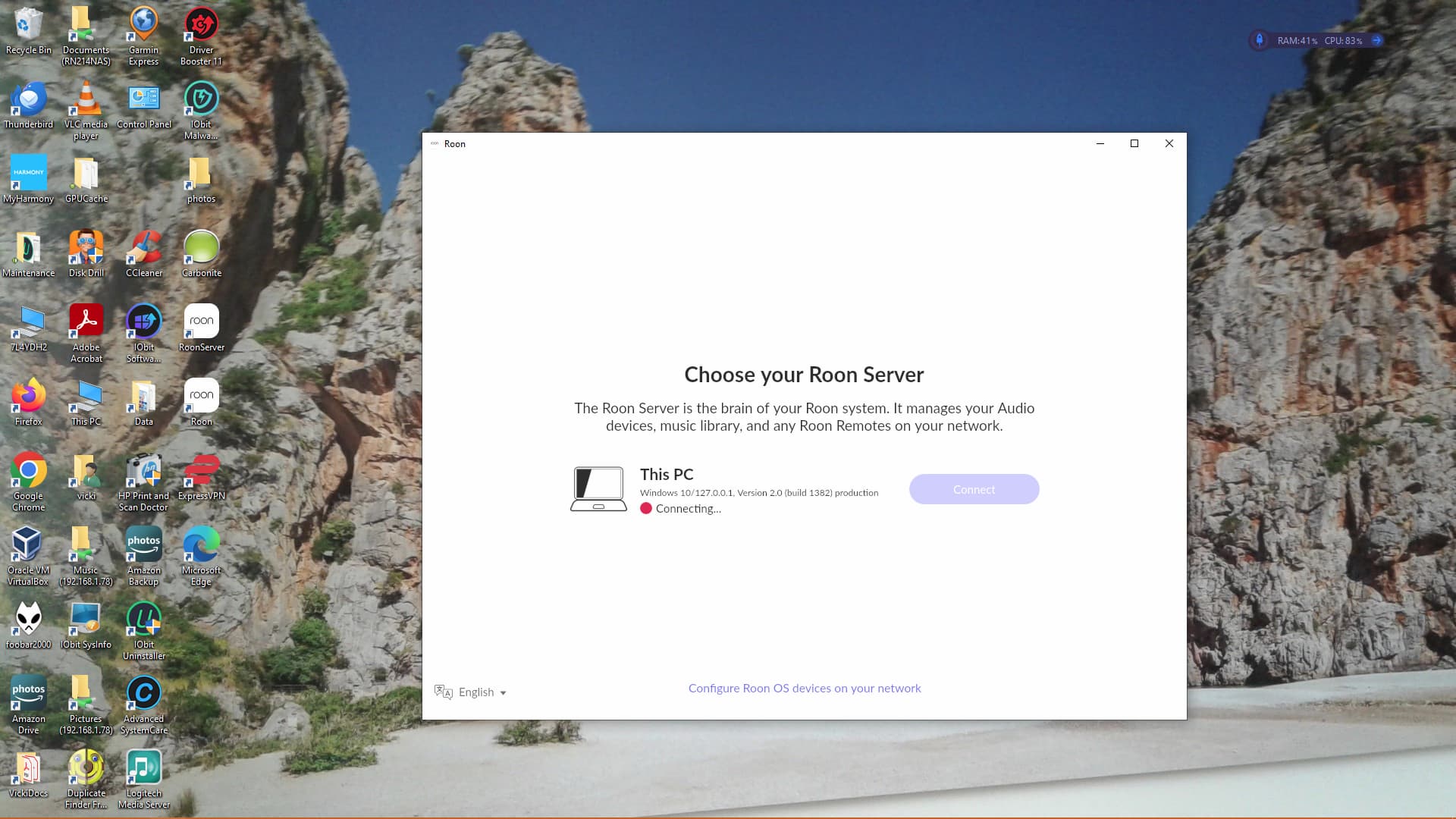

I have a squeezebox touch, a squeezebox boom and a squeezebox radio all attached via wifi. However, i cannot get the roon server to run at this point to even connect to. I get to the point of the roon server connect message and the application goes no further.
Can you upload a screenshot of this screen? Make sure to edit out your email if it appears in the screenshot.

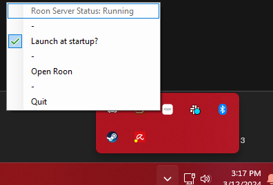

If you go to the taskbar on your Windows machine do you see Roon there? If you do what is the server status when you right-click on it? My thought is that since you’re connecting from the computer that hosts the Roon server the Roon UI may have started without the RAAT server starting as well.

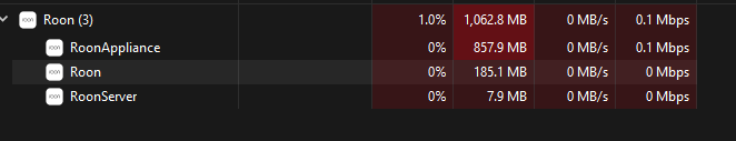

I see raatsever as well as Roonappliance and Roonserver in the task manager
@John_Hungerford sorry for the long wait for a response. If you are still experiencing this issue do you see Roon.exe in task manager?
Yes i see them. I believe the issue i am having is with the EXpressVPN application. I am also working with them…
