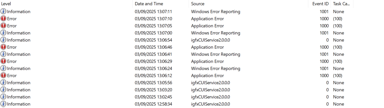

Im not sure what exactly is going on, but since i updated roon server to 1554 ive been having really strange network/roon server crashes.
I raised a topic on Roon support and sent them logs etc but in the absence of feedback from them i have been trying to diagnose it myself.
Here is the link to my topic i raised with them for your reference so you can see the symptoms ive been getting.
The reason im raising this with you now is that ive just noticed that before my server starts to crash and my network die, the web ui on one of my ropiee display endpoints starts to go on a go slow (i have 2 x Pi4 headless & 2 pi3 display - all wired network)
So i disconnected all my ropieee endpoints and amazingly my Roon Server will restart and network wake up… (which wasnt happening previously without me rebooting my Router).
I have a chromcast audio and roon arc on my phone so i can use Roon for the next day to try to see if the problem reoccurs without the ropieee devices switched on. (So far its only lasted a few hours before it dies).
But i wanted to raise it with you as i wondered if you had become aware of any networking issues since the roon server changes (possibly ipv6 related) with your ropieee release? Im on the latest release of ropieee on my devices - 2025.08.1 (2724 & 2725).
Im pulling my hair out right now as this only happened the moment i installed the latest roon server update 8 days ago…
